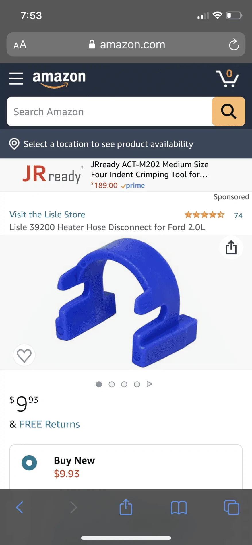

I replaced both hoses and tons of other maintenance after that, but moral of the story is, those hoses WILL leak, and probably after enough time not just from overheating or running too hot. There is a special clip tool on Amazon that’s about 10 bucks. Do yourself a favor, just spend the 10 bucks and never look back. I honestly don’t know how I would’ve unlocked those T clips without that plastic tool.
Thankfully though, the ST has a metal oil pan 👍🏻
Thanks for sharing that. Can you link or tell us more about the special tool? Not sure how to search for that.
