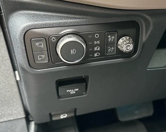

Installed my controller in preparation to pick up my travel trailer
Hated the recommended location so I put it where it fit perfect
