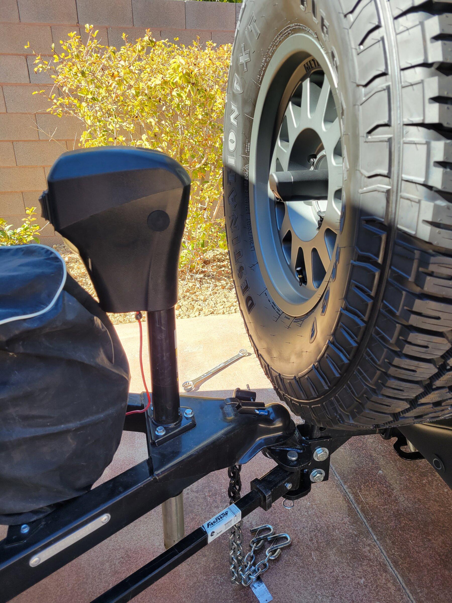

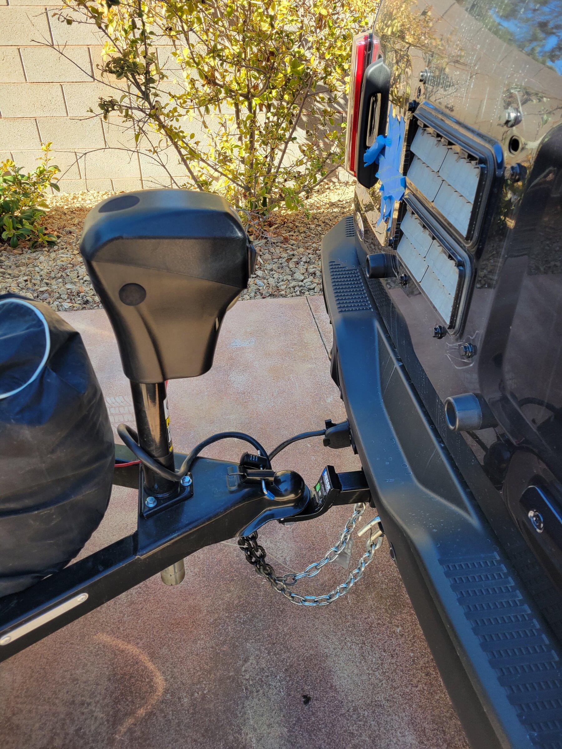

I went on Friday to my local Ford Dealership to use my points to buy the Ford brake controller. They had it for the same price as the accessory website but the website offers $30 to install it. The parts guy said that was an awesome deal and sent me over to service to check the install price. Service said they have to honor the $30 install and to save my points and just buy it outright with the $30 install. I used the 15% off of the accessory site and paid $323.92. Once it gets in they will install it. I went from a 2 inch drop hitch to the Fastway e2 weight distribution and sway control. With the 2 inch drop I had to remove the spare tire and carrier because the camera would hit my power jack. Once I got the e2 setup I flipped the power jack head around. I will let you guys know how well their install goes.

Hooked up the camper and did some testing today and verified the controller works. I had to put an temporarily put extension on the receiver for my Equal-i-zer weight distribution hitch to clear the tire. I will be getting a longer shank for the Equal-i-zer hitch as I do not want to use an extension.
It towed fine, but I only towed it around the neighborhood as the chains were too short and the cable for 7 pin barely reached. It seemed fine driving but I wouldn’t want to take a chance without having a longer one and I had to unplug it to back it up again into the driveway.

Looks great! What model is your camper and what's the dry weight?

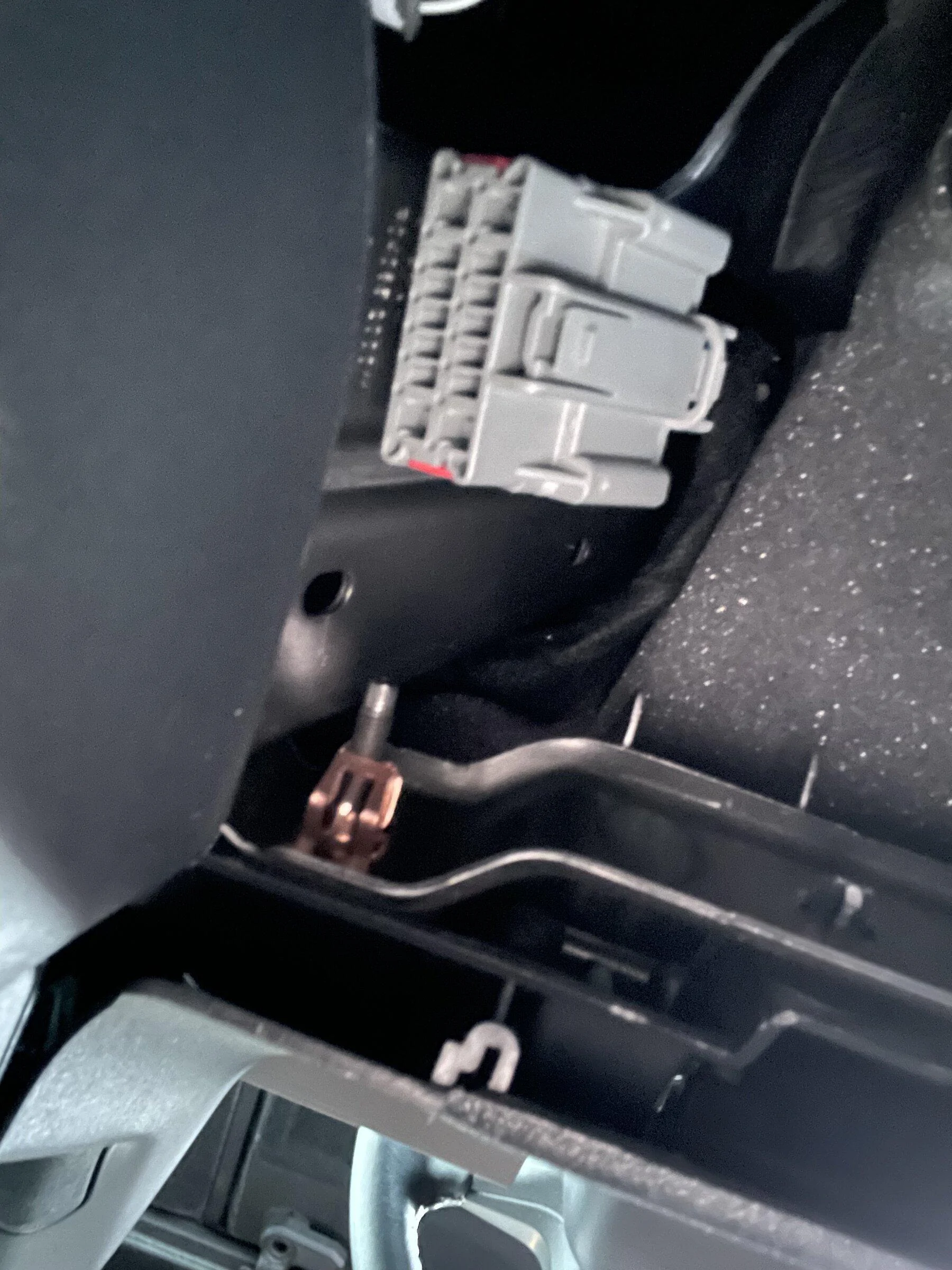

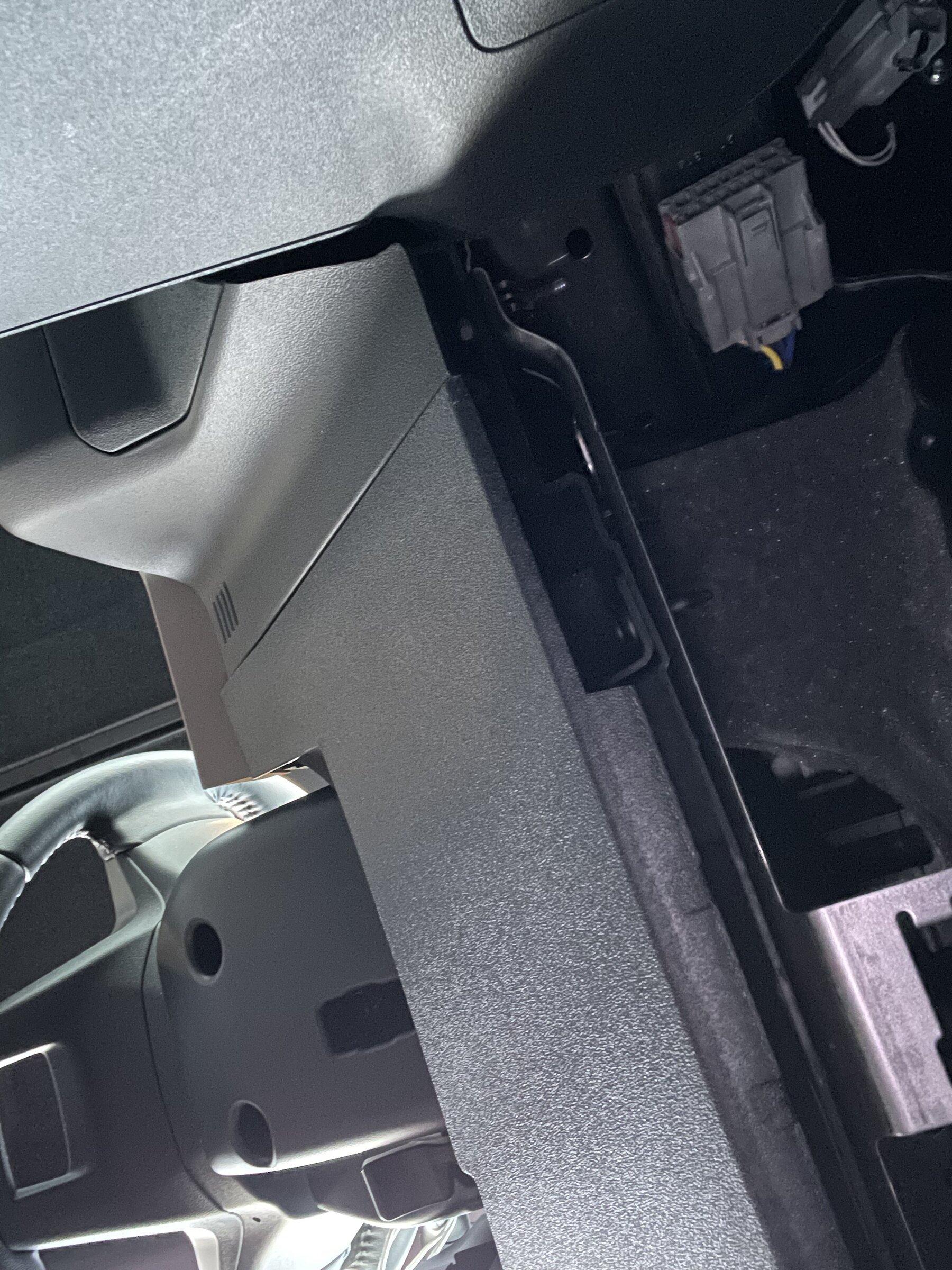

Check the plug under the dash drivers side, the cover on my installed connecting plug is missing.
