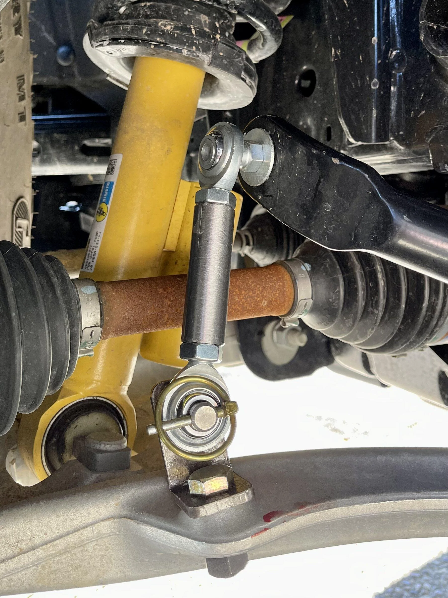

I made my own swaybar disconnects and drove around with it disconnected a few weeks back. I wouldn’t recommend it for street use it had way more body roll taking turns. If your driving miss daisy you might be okay.
Ford Bronco Flame away - Removing the swaybar 79D13258-F18B-4FA5-A80D-D503A6D2B7B9
Those are sweet!

Also @Frankie945 can we get a write up or at least a parts list on your discos? Why isn't anyone selling these yet?!
