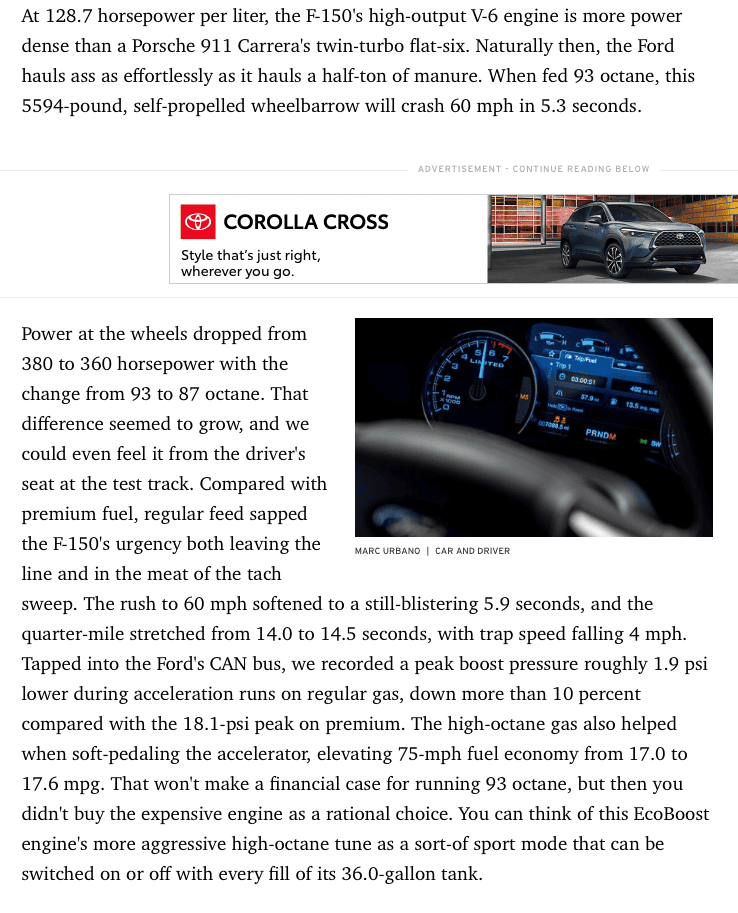

FWIW, Car and Driver did a test on Premium vs regular fuel a few years ago and one of the vehicles tested was a F150.
Ford Bronco Gas Grade Poll.  Regular or Premium Screen Shot 2022-03-13 at 9.29.52 AM
