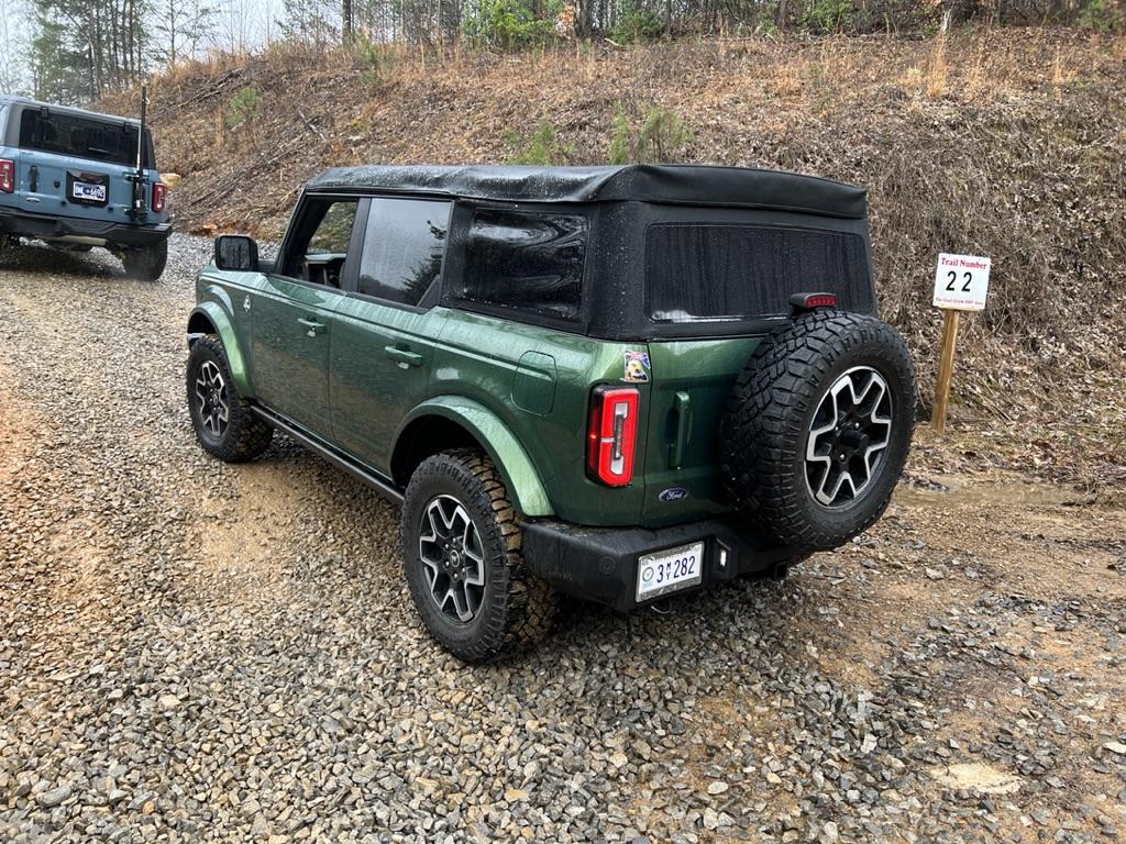

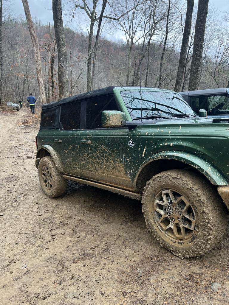

I had Goodyear Durtrac's on mine. I have them on my F150 as well. I have used them since 2010 on all my trucks. They are great winter tires do very well off road, and have great on road drivability.

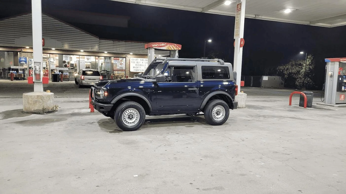

In this pic, @Jazer swapped the nasty OBX street wheels for Badlands "33's" wheels and tires . Note the wheels are 17".
fwiw, 17" wheels have far more tire selection to choose from, often cheaper as well.
From the build thread : https://www.bronco6g.com/forum/threads/jazers-blu-pony.36373/post-1482739

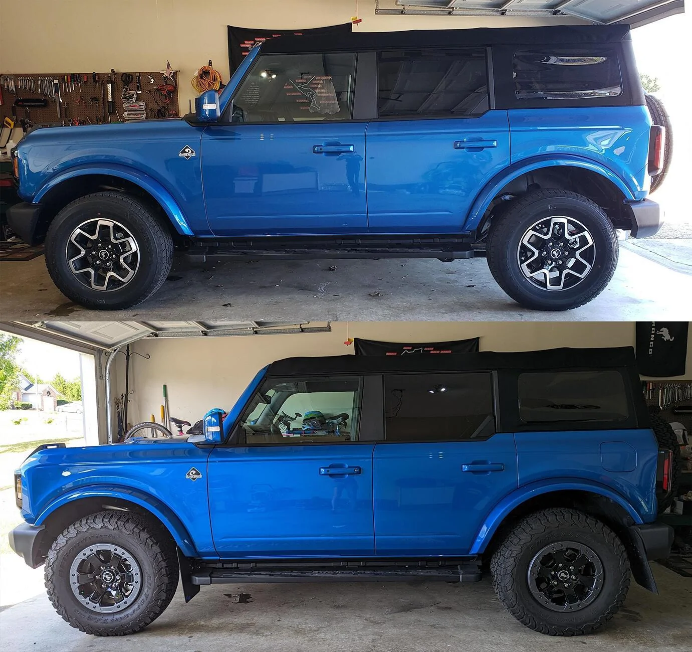

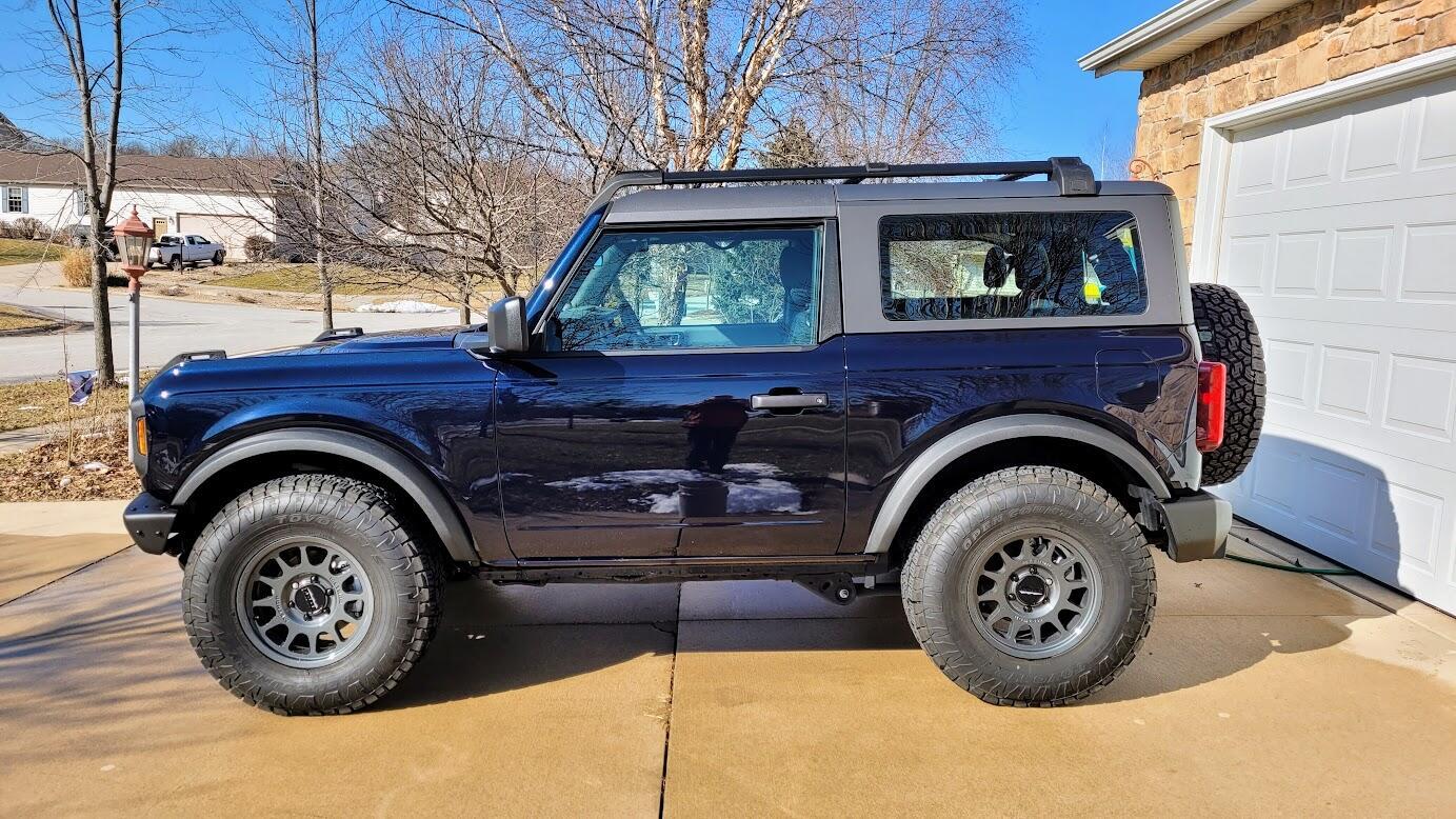

Here's my base on 35's. No lift, removed the crash bars.
https://www.bronco6g.com/forum/thre...no-lift-method-703s-toyo-35-x-11-5-17s.32232/
Ford Bronco How 'bout another tire question... 1725201846713-cm
Ford Bronco How 'bout another tire question... 1725202146647-ll
Ford Bronco How 'bout another tire question... 1725292353042-yb
