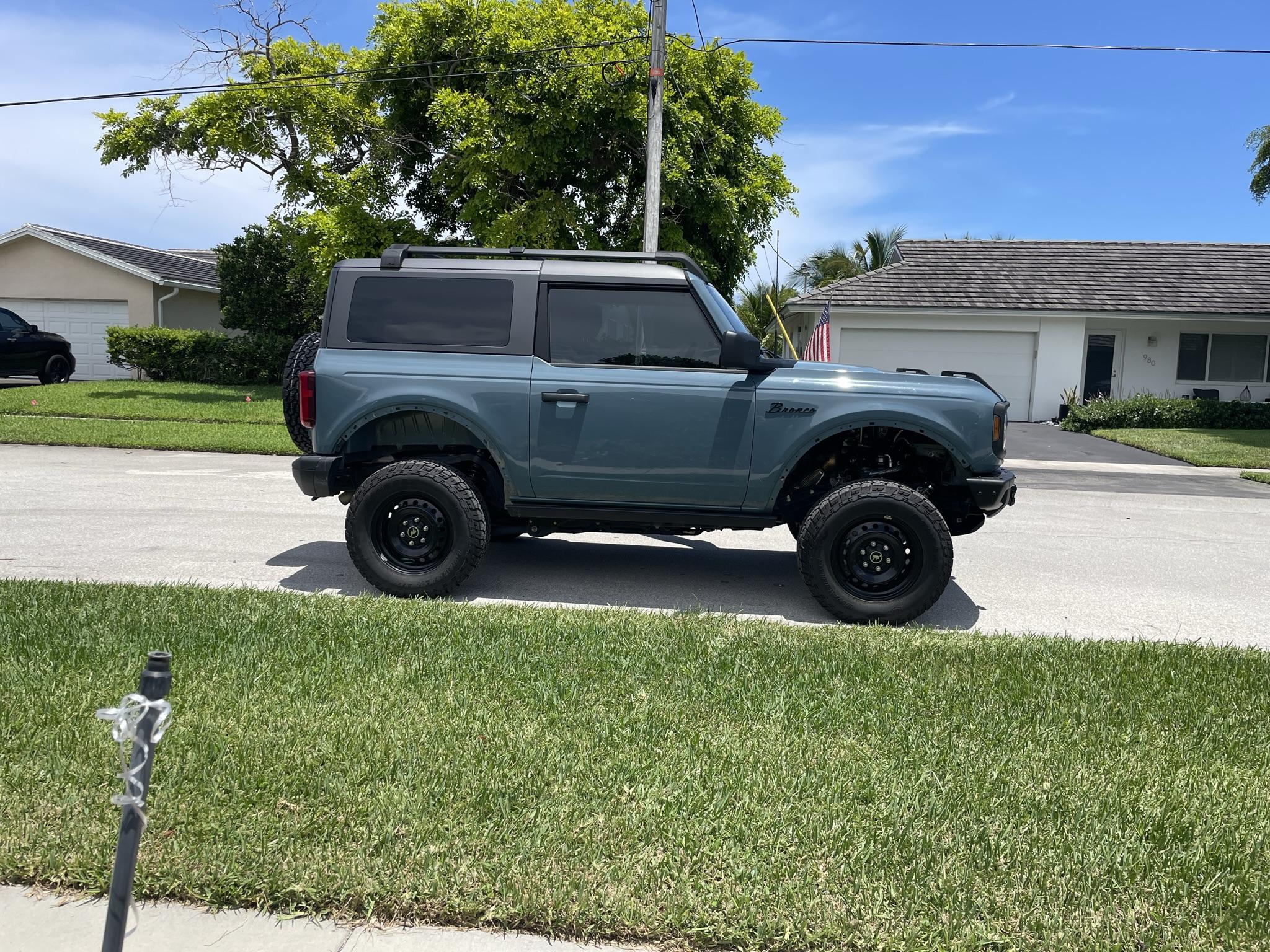

Installed icon 2.5 adjustable coilovers along with Camburg upper control arms, nitto trail grapplers 315/70R17, and Sasquatch take off wheels. Did the install with my dad (he’s on the forum so hi dad) in our driveway, overall it’s a straight forward install which means it took us 15+ hours.
Started with a non squatch black diamond 2.3L manual, there was nothing wrong with the ride stock it was good on and off road. However the switch from stock to icon was night and day, it rides incredibly smooth and plush while also drastically reducing body roll and pitch. Haven’t been able to take it off roading yet but am sure that my bash plates will appreciate the added ground clearance.
There were some difficulties with the instal, the position of the front reservoirs either pushed the hose along the spring rubbing on 4 of the coils or rubbing the the tire at full lock. After speaking with icon we were told we could losses the nut to spin the hose on the revisor without leaking oil, it leaked oil. Icon then got to work on new set of custom front coil-overs and had them ready in an impressive amount of time so props to them. This is a new vehicle and a brand new suspension kit so not that suprised that there’d be issues.
Overall it rides amazing and looks great, programmed the tire size with forscan two days ago so really don’t have enough data to make any real mpg claims but doesn’t seem to be a change. I’ll post updates when I get some time to take it off road with the new set up. It also got a buff, polish, and ceramic coat while we waited for parts and looks better than factory now.

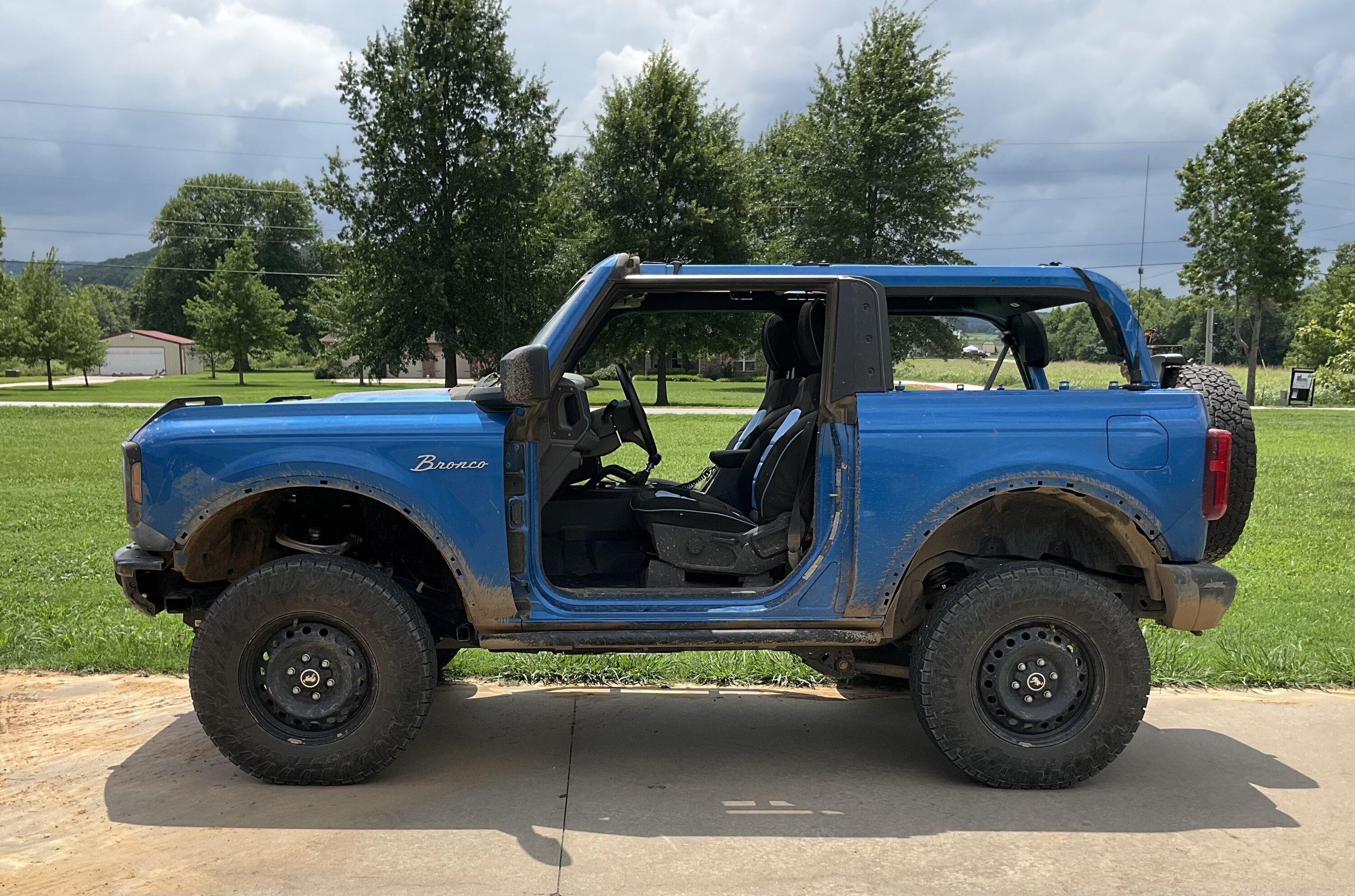

This was when the shocks went of before the wheels and tires, the nittos don’t have anymore road noise but it did loose a little bit of perkiness in the throttle but nothing major.

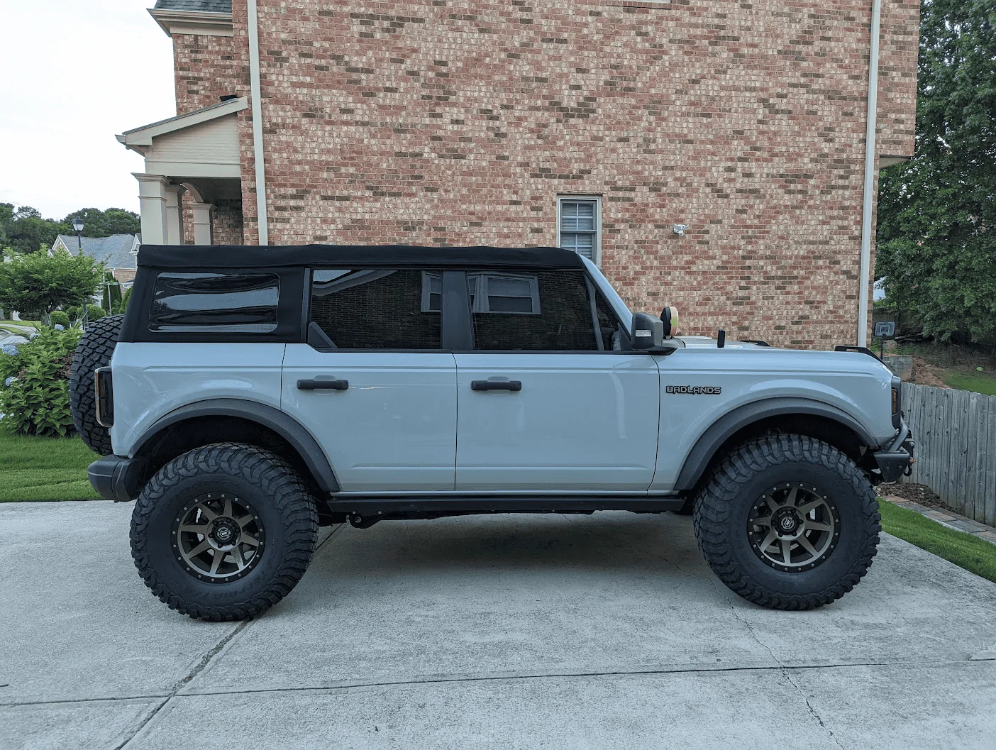

Mine was just under 26in but thats with 4door and front jcr winch mount and winch around 27 in the back. I'm going to adjust the fronts up to get a little more room for my 37's.

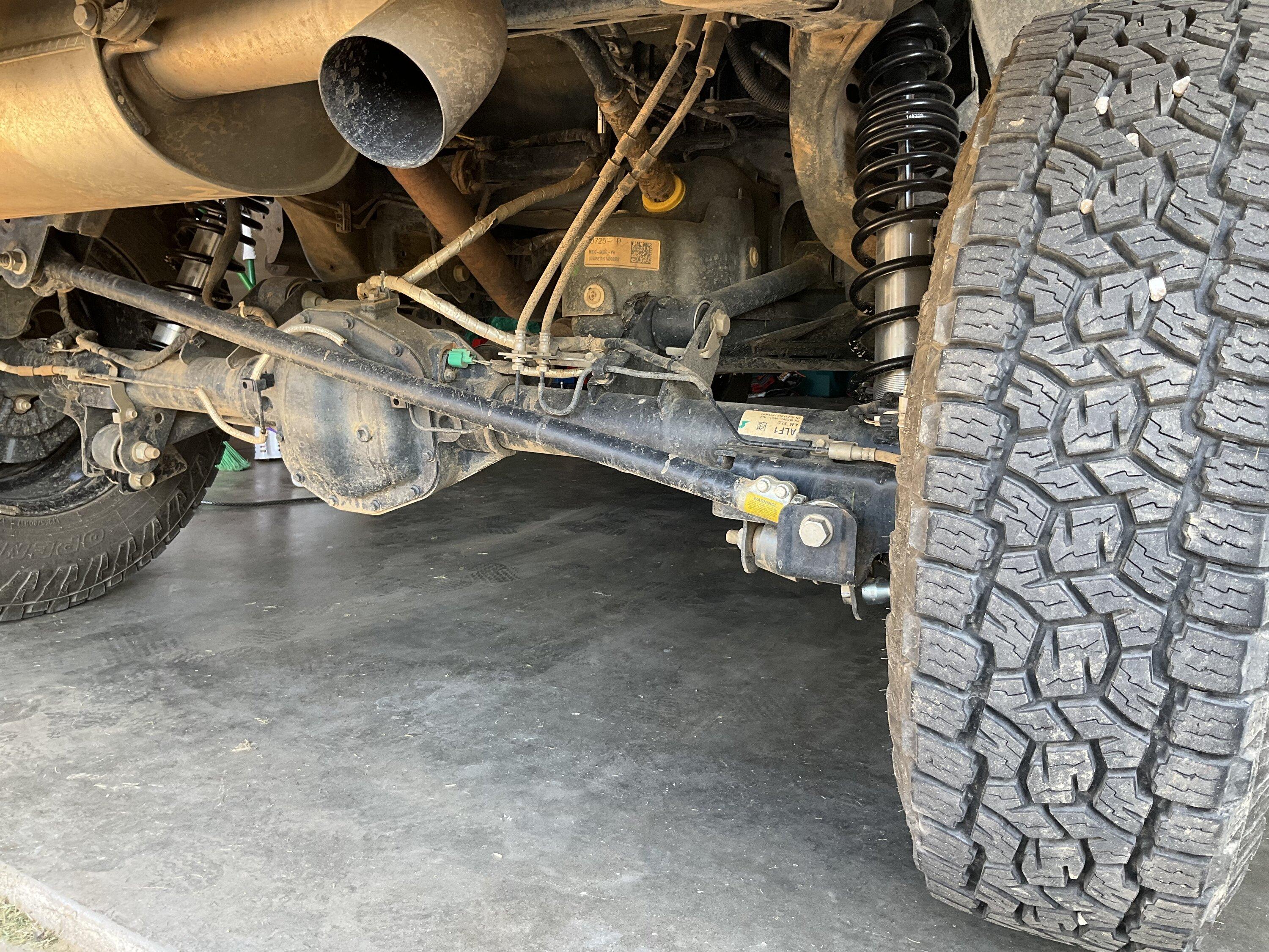

How about rear brake lines? Mine are short. This is with the passenger side lifted, but still needs to go a bit more to lift the tire. I think if I lift my passenger tire, I lose brakes.
