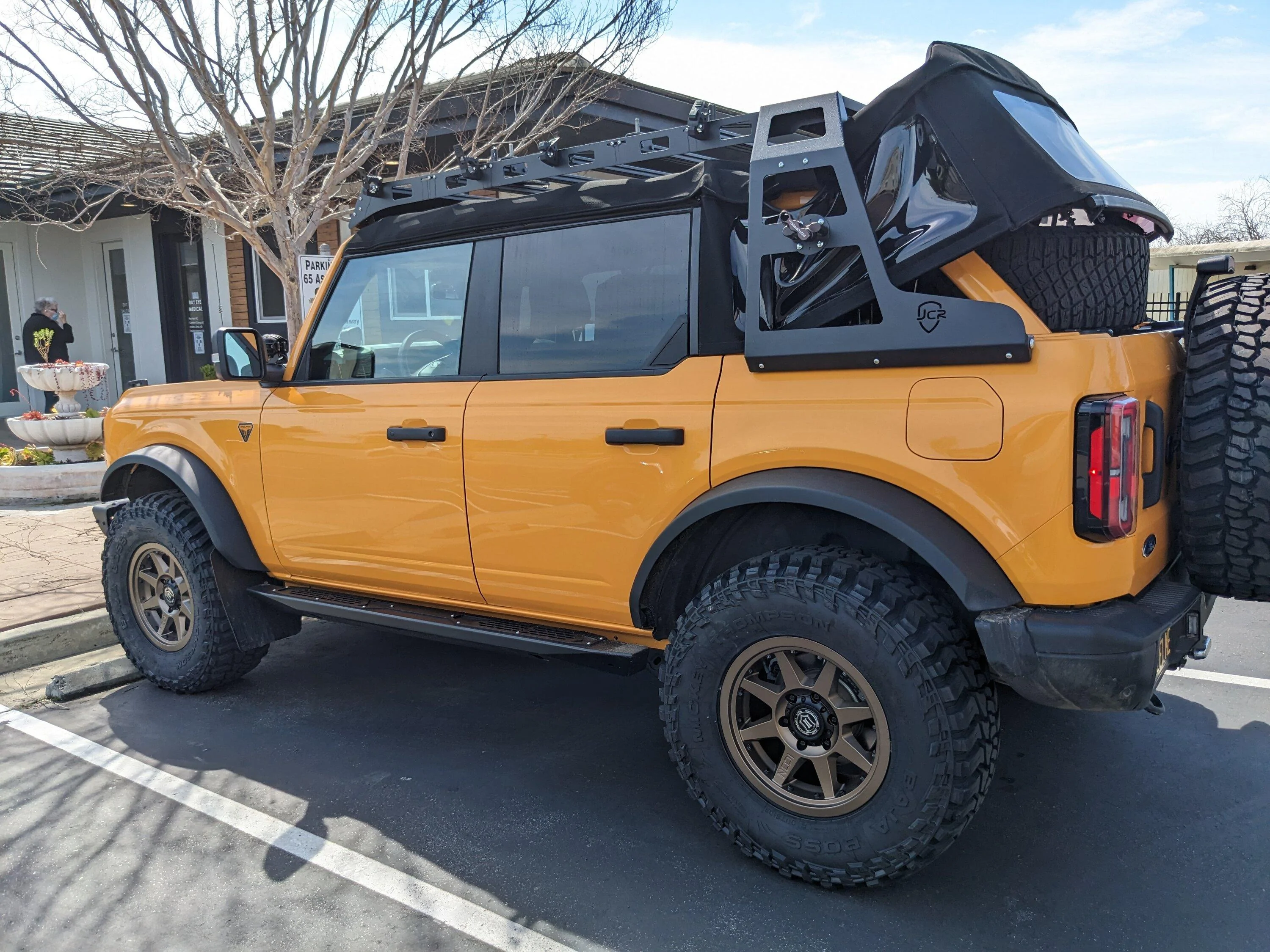

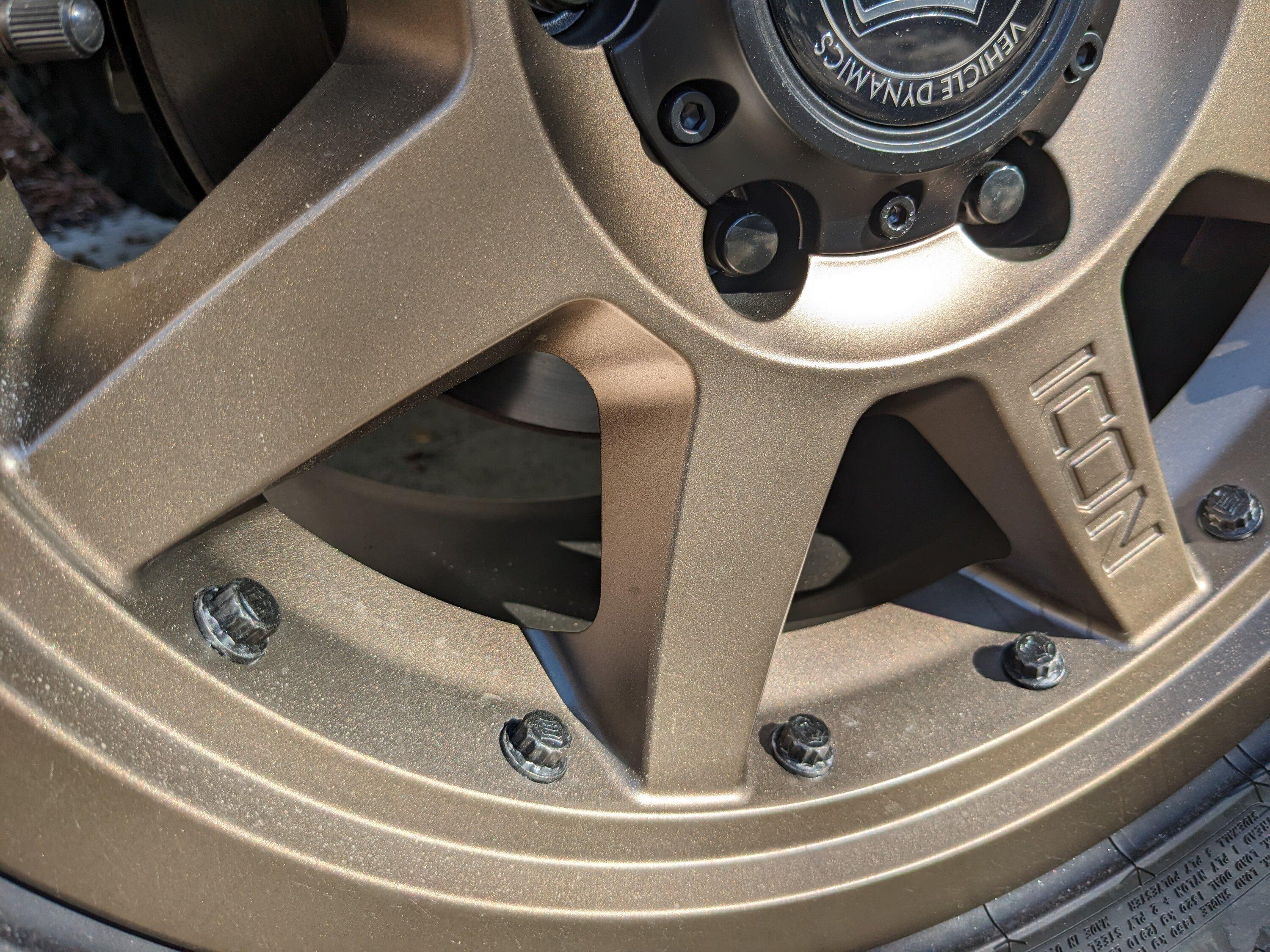

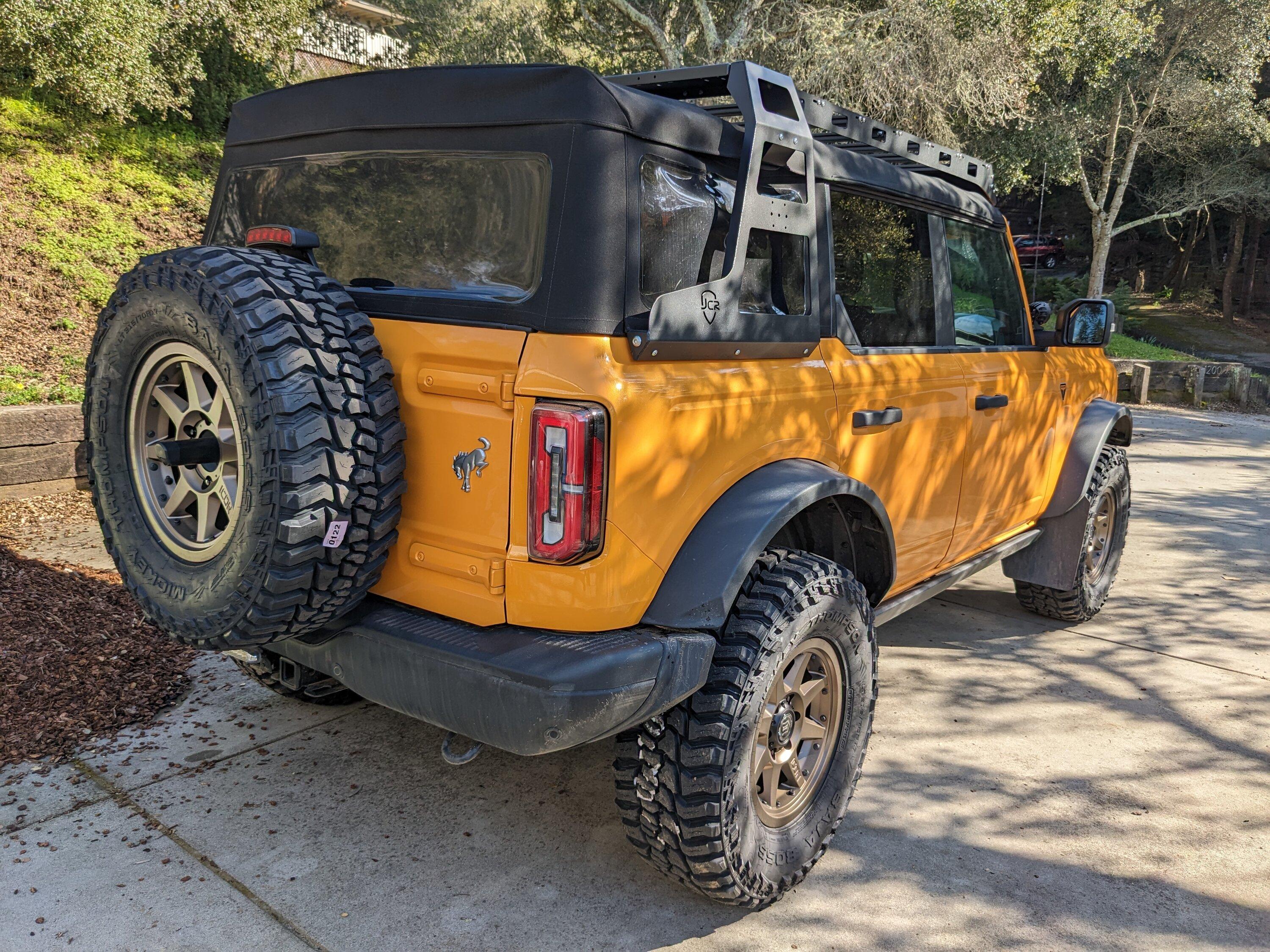

I received 7 packs of o-rings (each pack with 8 o-rings) in the five boxes (wheels) that I purchased;I had asked my installation shop to look for and keep these for me when they opened the boxes. Aside from the lug nuts and socket, the shop had all that was needed to install the tires onto the wheels correctly. This is an independet shop that works on 4x4s and trailers, and is my go-to for my Bronco's wheel/tire/suspension needs - Street Scene 4x4 and Trailers, in Watsonville, CA.
The new tires are 35" (315/70/17) Mickey Thompson Baja Boss M/Ts.
Here's the end result from today's installation, which I'm quite pleased about:
