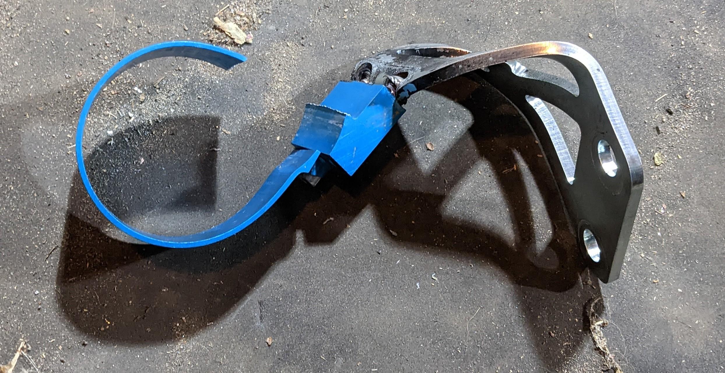

Hate to see that, but at least it didn’t damage the hose or fittings! Had to go check my mounts to make sure that won’t happen to mine when I get the 37’s installed.
Quick question -how many clicks are you running on your adjusters up front?
The bracket and clamp are the only things that got hurt. Ben @ Filthy says the clamp shouldn't be more than $40 - I'm waiting on that email.
I'm running all four corners at 3 clicks from softest.

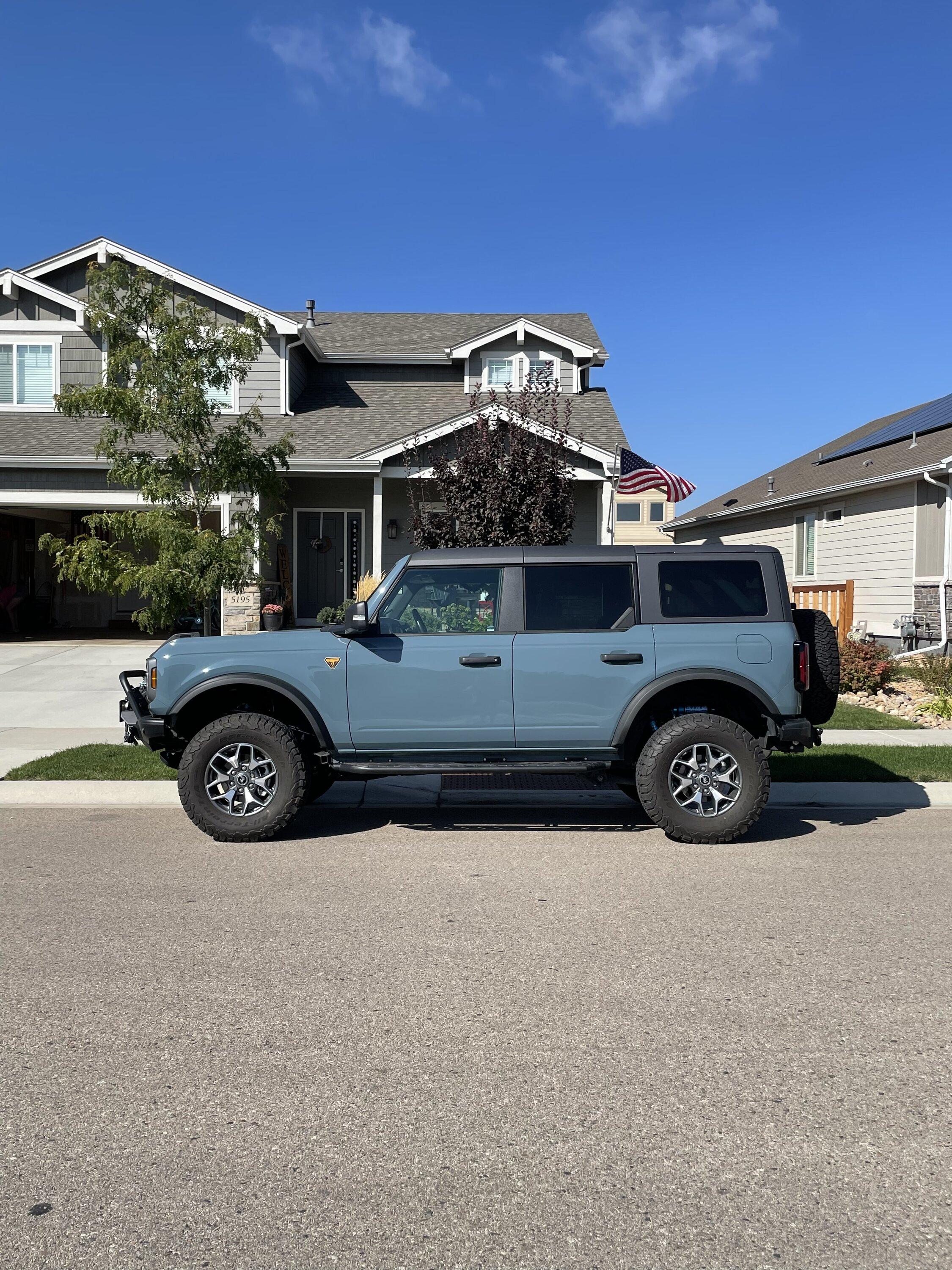

Finally got my Kings installed. Set at 0 preload up front and about 1/2 in the rear. Set like this from King.
got about 2.25” lift up front and about .75 in the rear. Winch and bumper up front so would be around 3 with stock bumper.
Front shocks were about .75” longer than OEM and rears were about 1.0”.
Little rigid on small stuff on the road but soaks up bigger stuff good.
Overall, spring rates could drop a little bit but rides ok. Plenty of damping. About the same body roll up front, but rear is definitely more rigid/less roll.
Plan to stay on 33s for the foreseeable future

Looks really good! I tried to convince myself I didn’t want to put big tires on mine, but I just wouldn’t listen….😄
Evolkidbell
Jul 17, 2020
573
808
Northern Colorado
1966 Bronco, 2013 F-150
The other day at work, a gear head friend said, "So when ya' putting 35s on it?" Told him I plan to stay 33. He was "uhhh yeah. So when you putting 35's on it?" :ROFLMAO:
