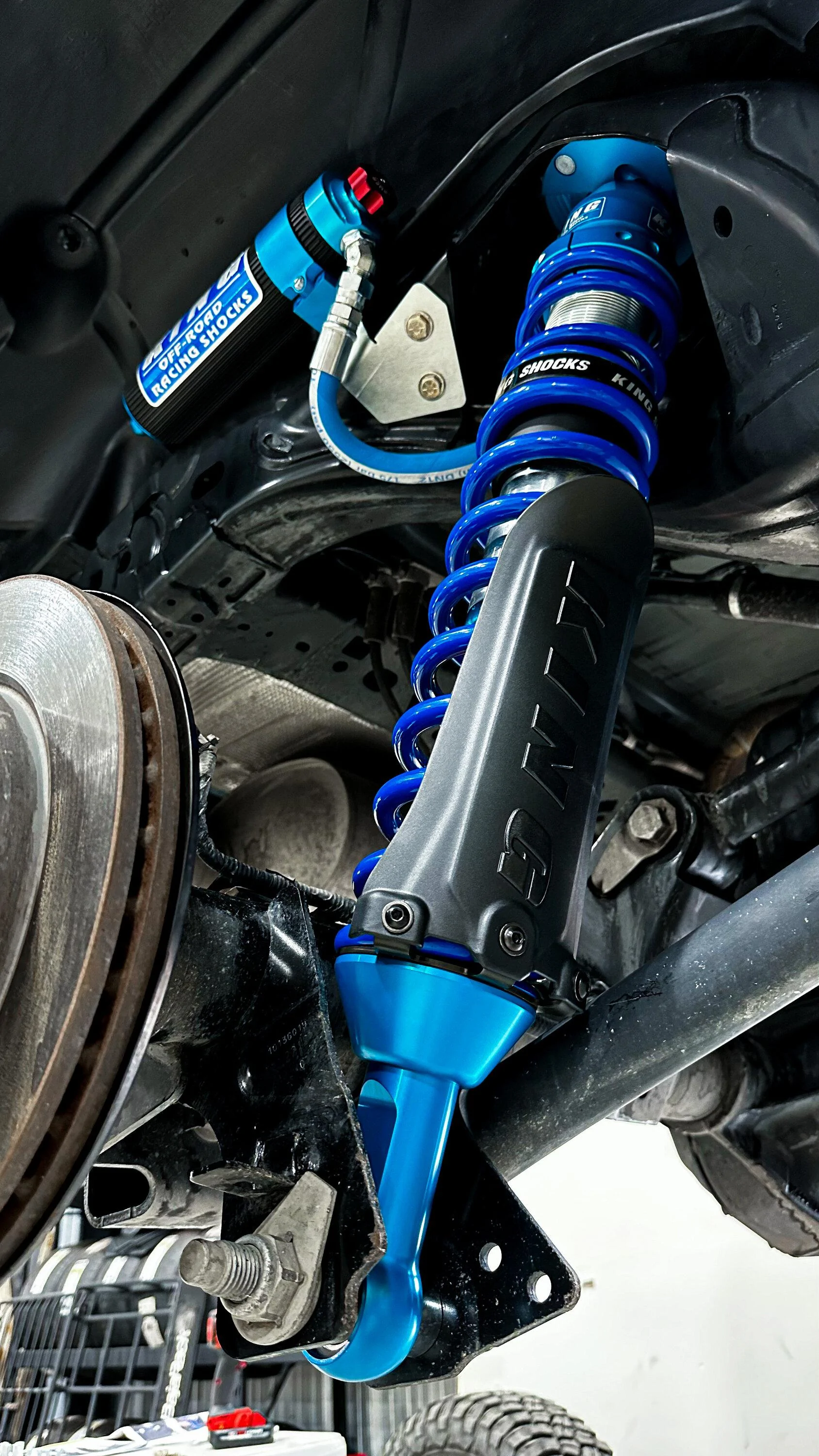

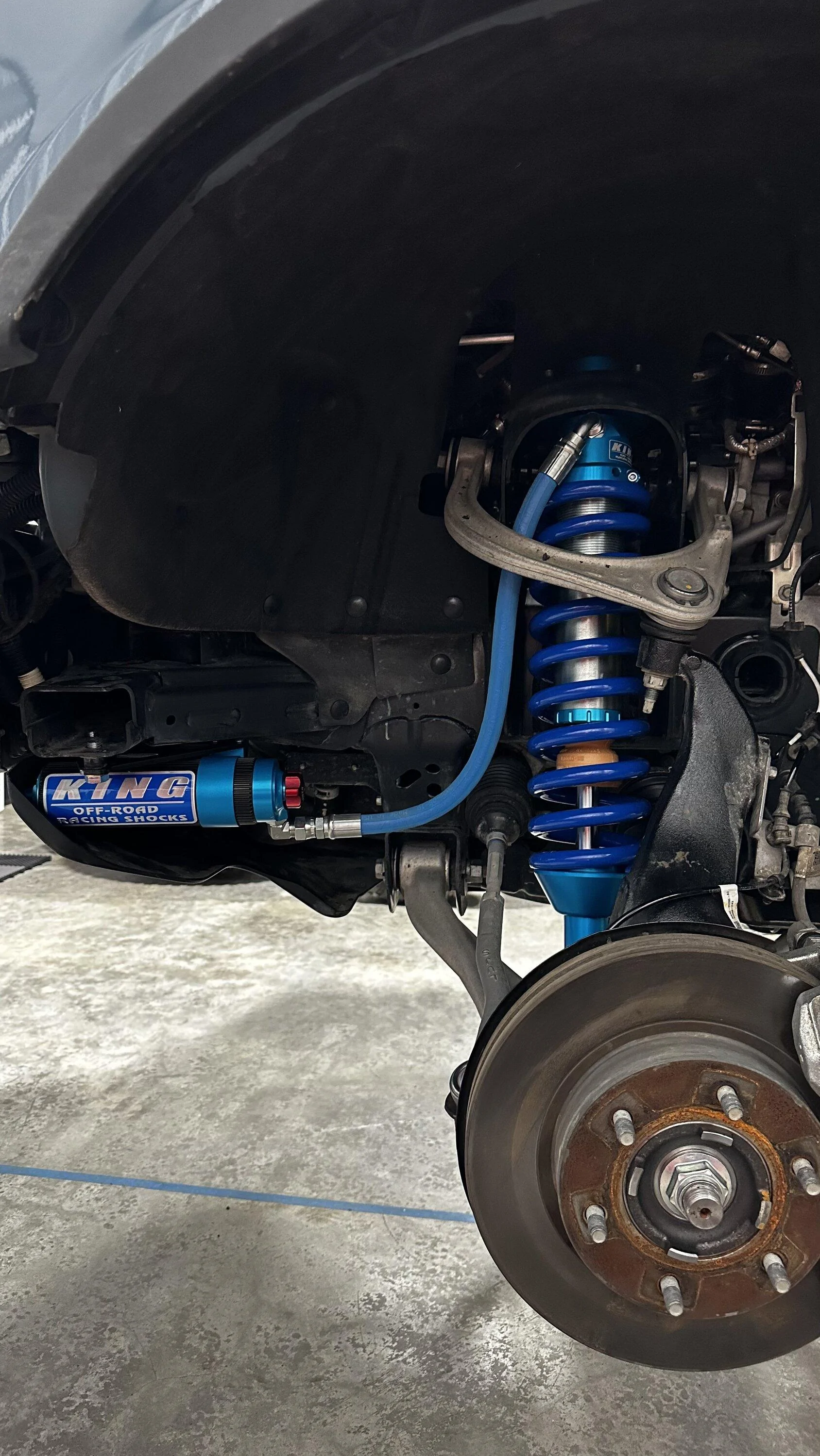

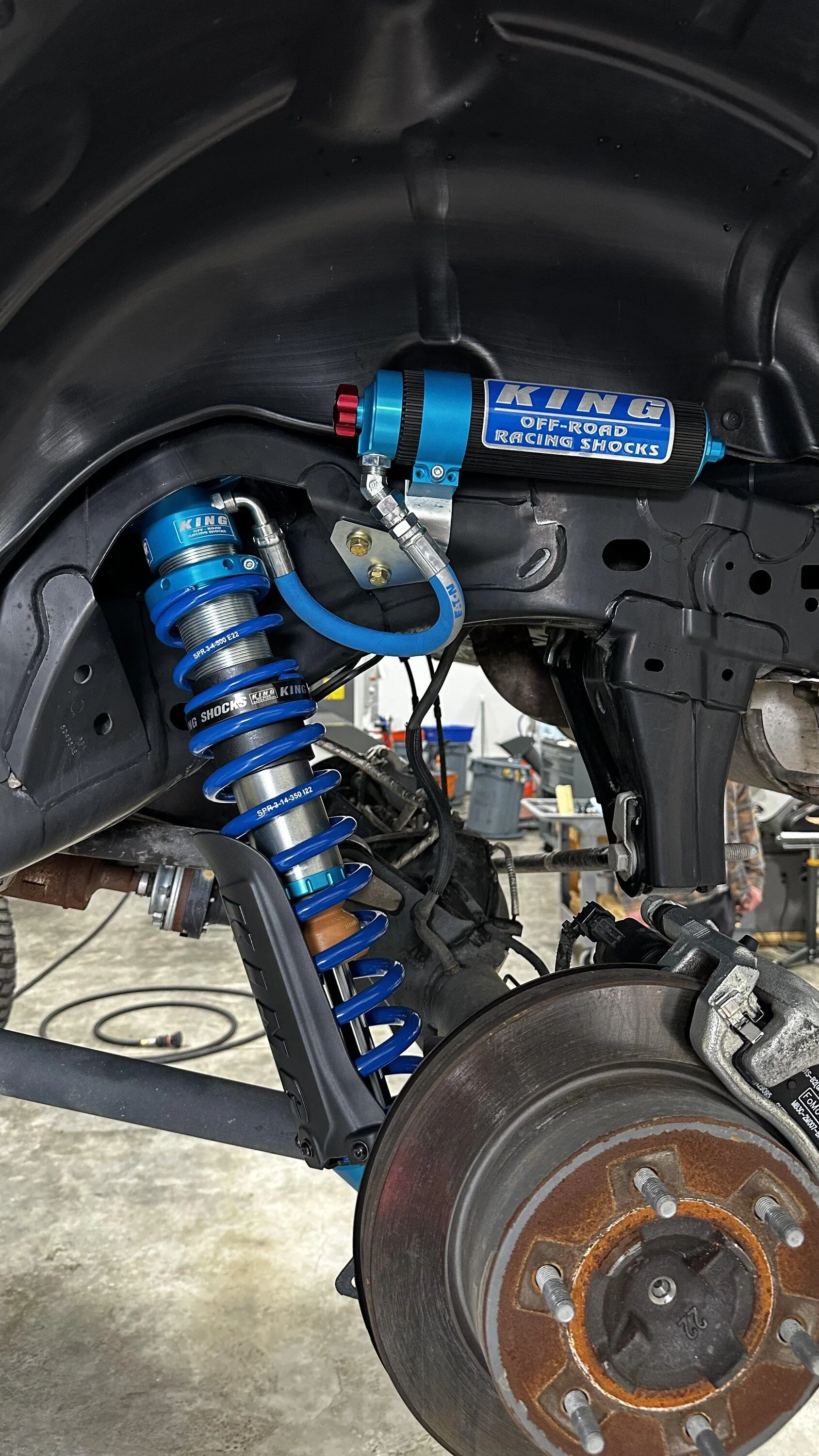

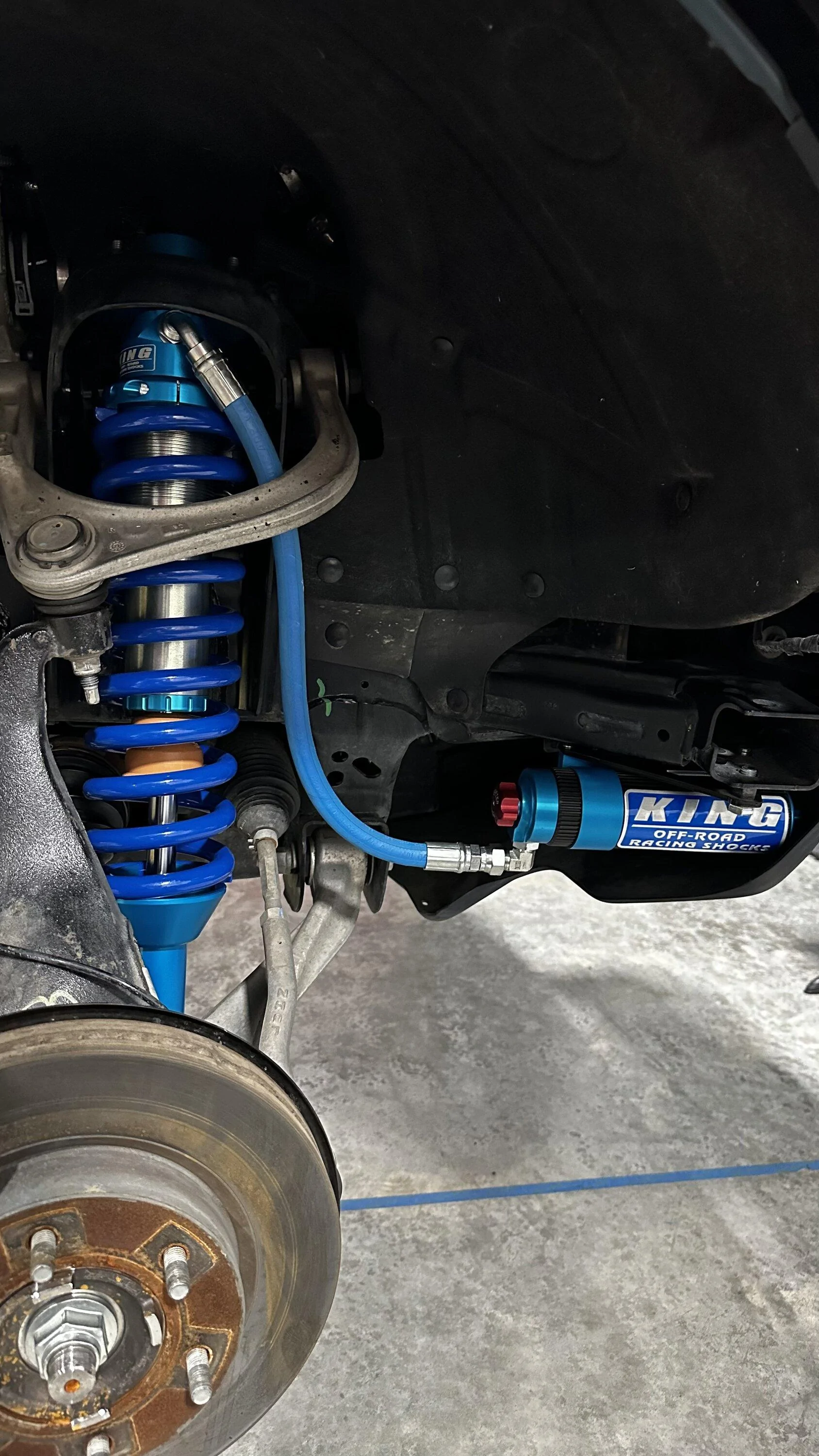

I ordered this setup about a month prior to the delivery of our First Edition, back in Nov of 2021. Fast forward to January 2023 and they’re finally on the work bench. These shocks were #1 on my mod list, but the most recent one completed.
I put the Bronco up in the air and over the course of three weekends I disassembled the front suspension and removed the Bilstein shocks from the rear. I don’t have big blocks of time to throw at projects like this anymore so that’s the explanation for the three weekends. Also, King shipped these with incorrect upper mounts for the front shocks. Overall, it probably took 4 hours to perform all of the work, aside from the alignment.
Install is straight forward. No crazy tools or spring compressors required. A lift definitely makes it easier. Maybe a third hand, here and there, may be needed.
The best part of the King 2.5 install is that it leveled the Bronco back out. Prior to, it had a serious rake due to the WARN winch install. There’s ~1” lift all around. Ride height can be adjusted, if so desired. Right now, these are set where King set them when they shipped.
The ride, on surface roads, is, for the most part unchanged. We have some sweet powerline trails near the house that I’m itching to take a rip on and dial in the dampening. Really nothing bad to say. Easy install. 100% on quality. They look cool. That’s always a plus. Now the Bronco sits level. Couldn’t be happier with them. 🙂
