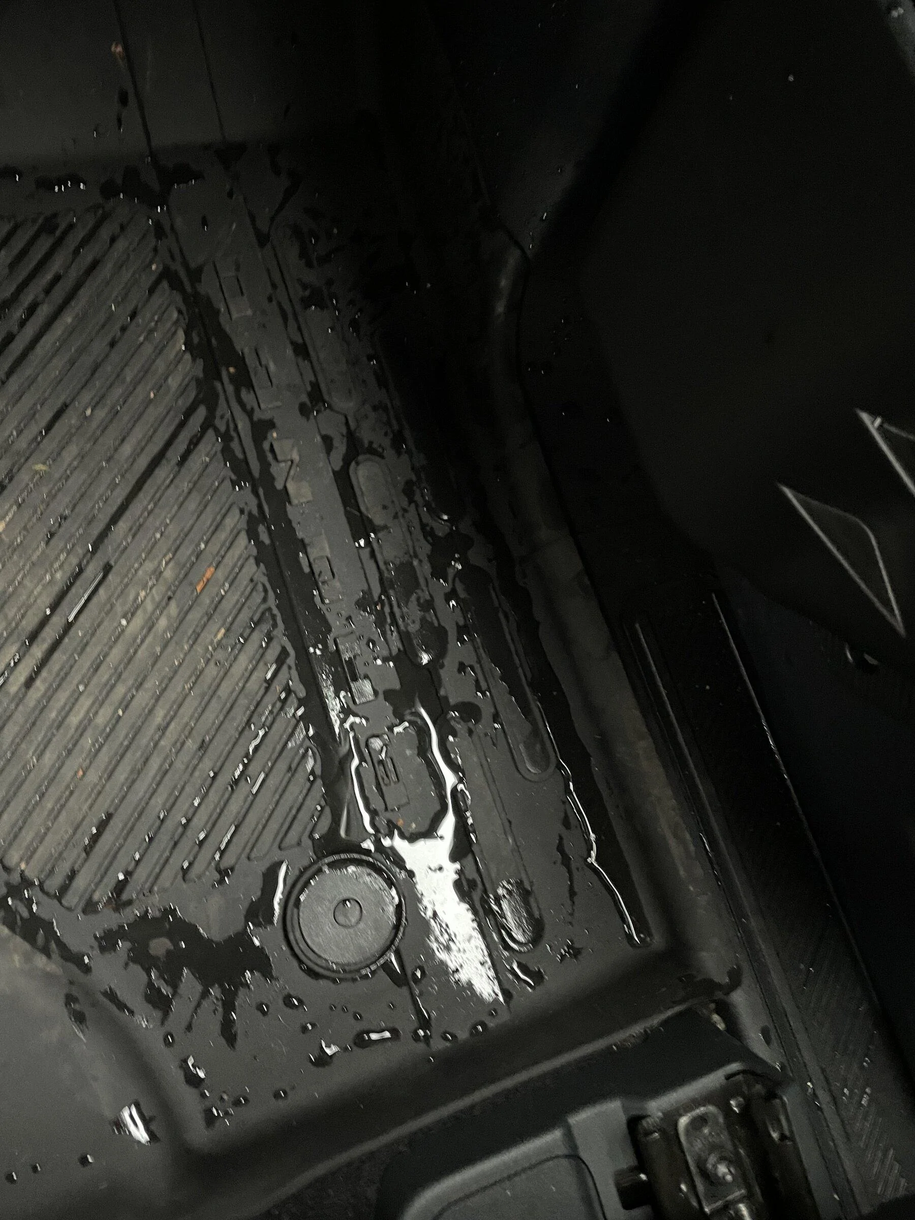

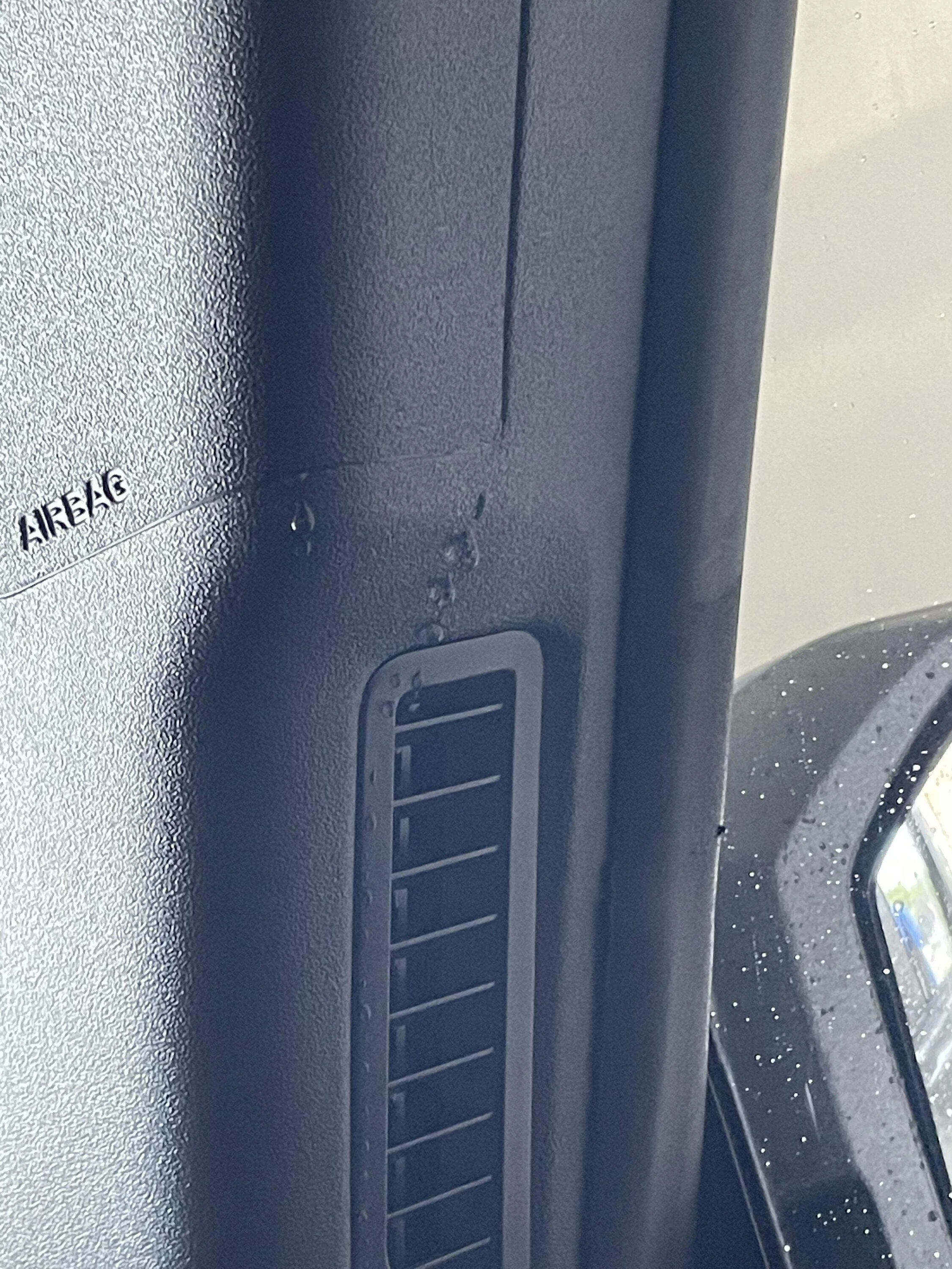

Every time I leave my 2021 Bronco out in the rain, the floor is filled with water. Anyone else have this issue? Seems to leak into the A pillar/vent and onto the floor.

No issue with mine some are hit and miss undo the panels check the gaskets or just take it to the dealer there is a tsb for the hardtop

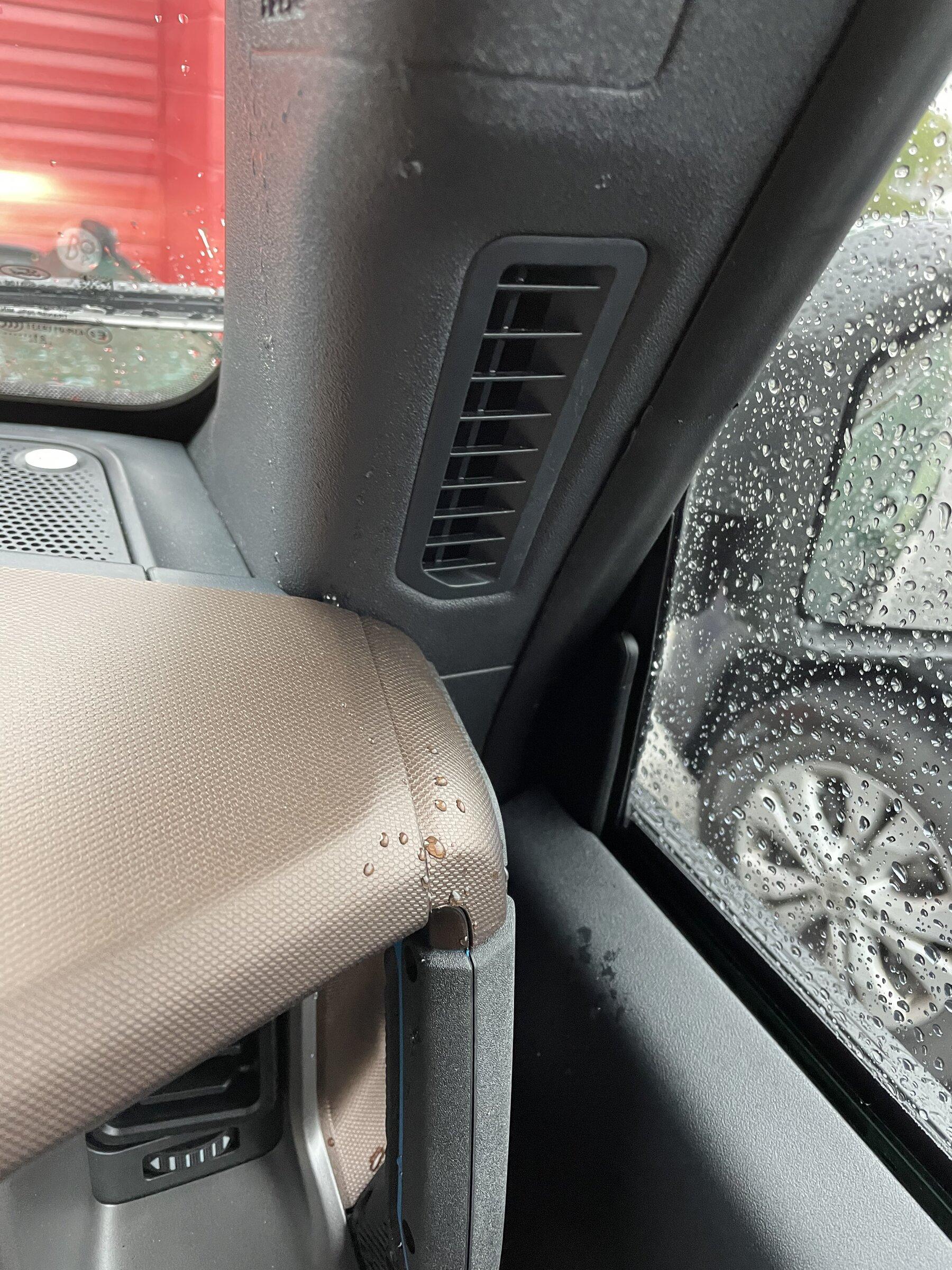

I have a similar issue just not as bad as yours. It just leaks at the very top, driver side, above the vent seem but only in heavy rain. I assume its from a bad seal on my hard top. But to be honest. My jeep leaked a little bit too so was to be expected.

I’ve seen that a little bit at the airbag panel at the A pillar… doesn’t do it much though.

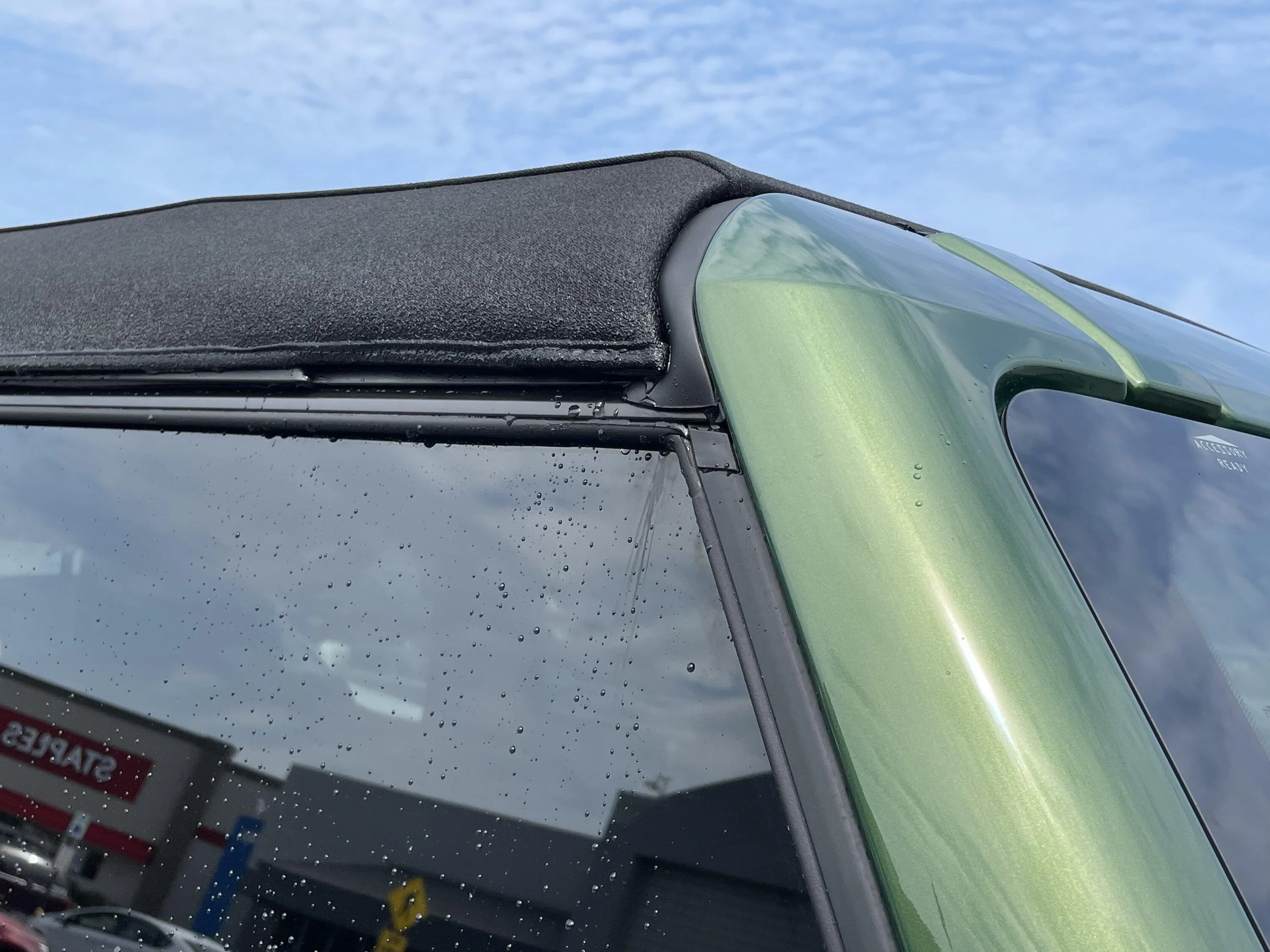

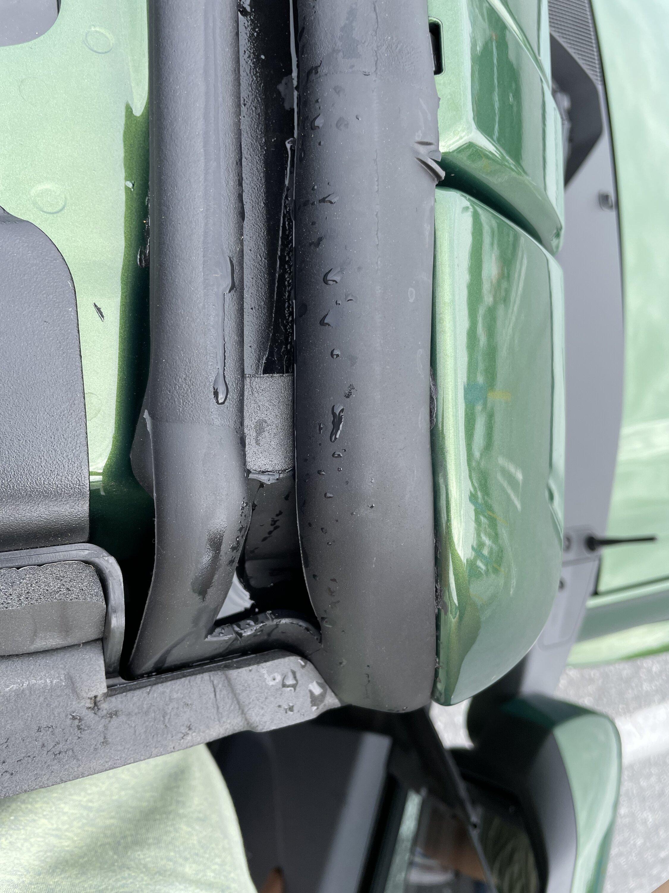

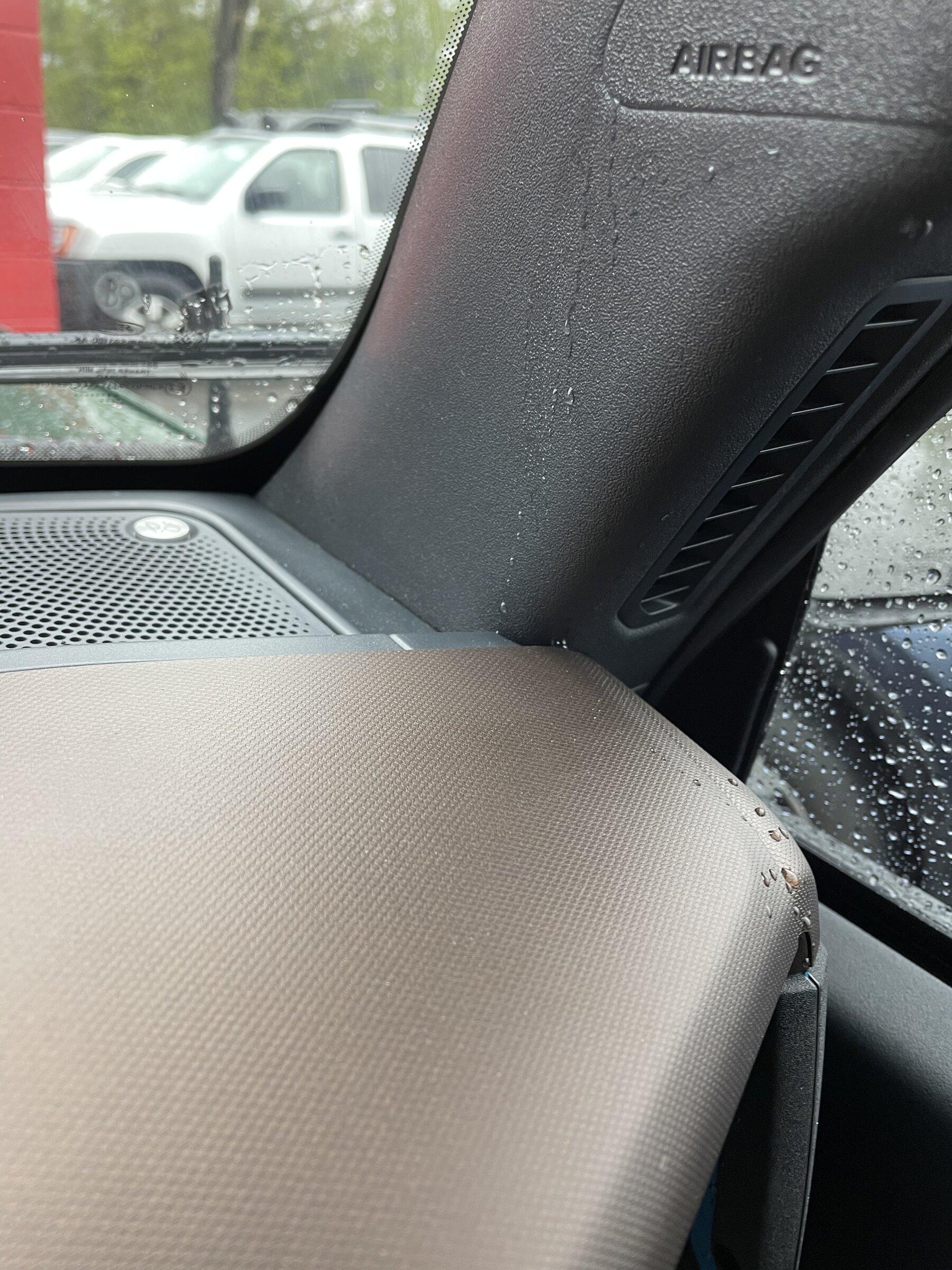

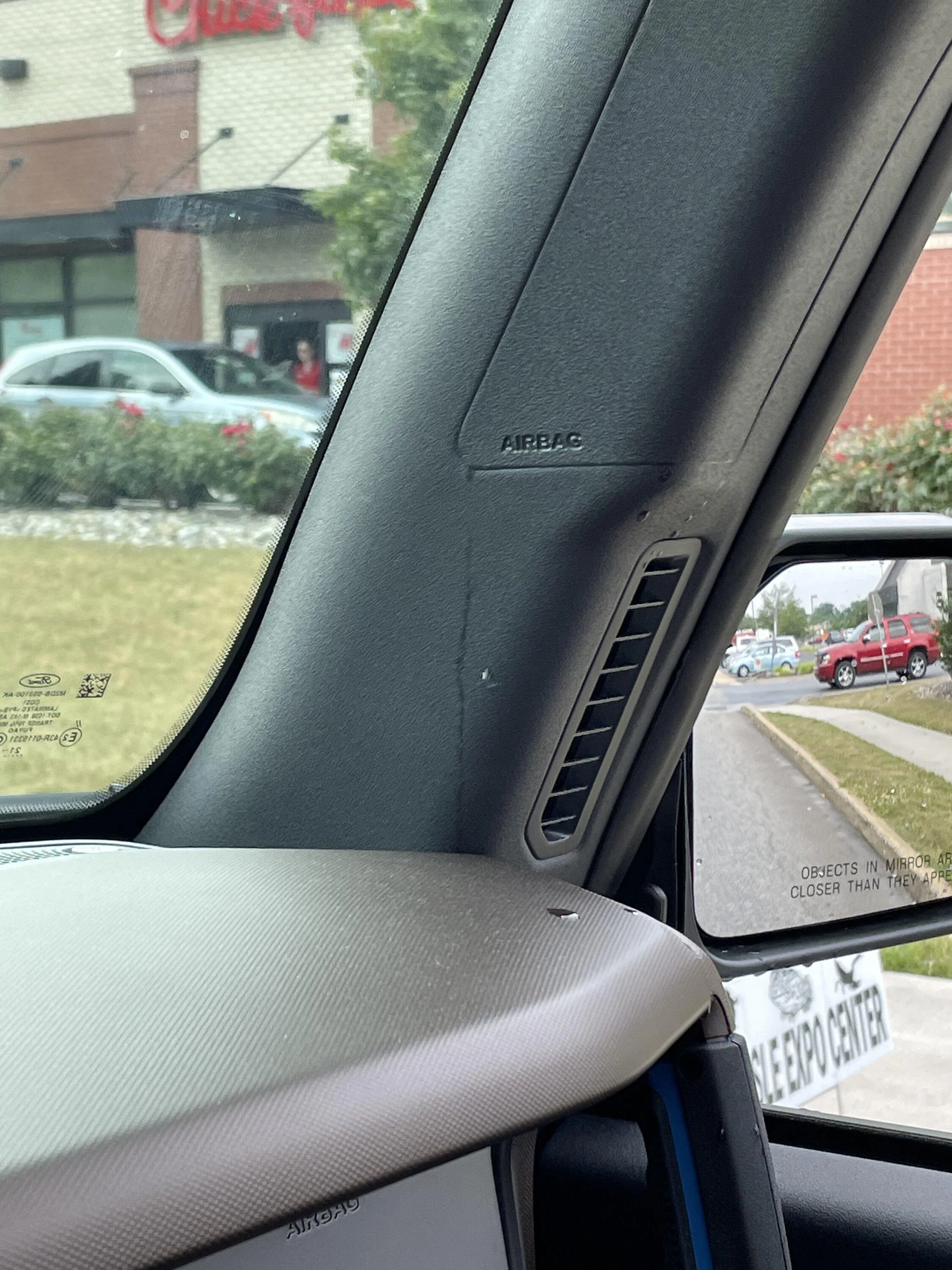

I’ve got a 2022 bronco with this same issue. The dealership had a leak specialist examine the issue who said there is an issue. I have a part in order but done have an ETA in when I can get it fixed. For me it’s both passenger and driver sides. I’m glad I have the all weather mats.

Just found the TSB and I think the dealership is using that to fix the leak.

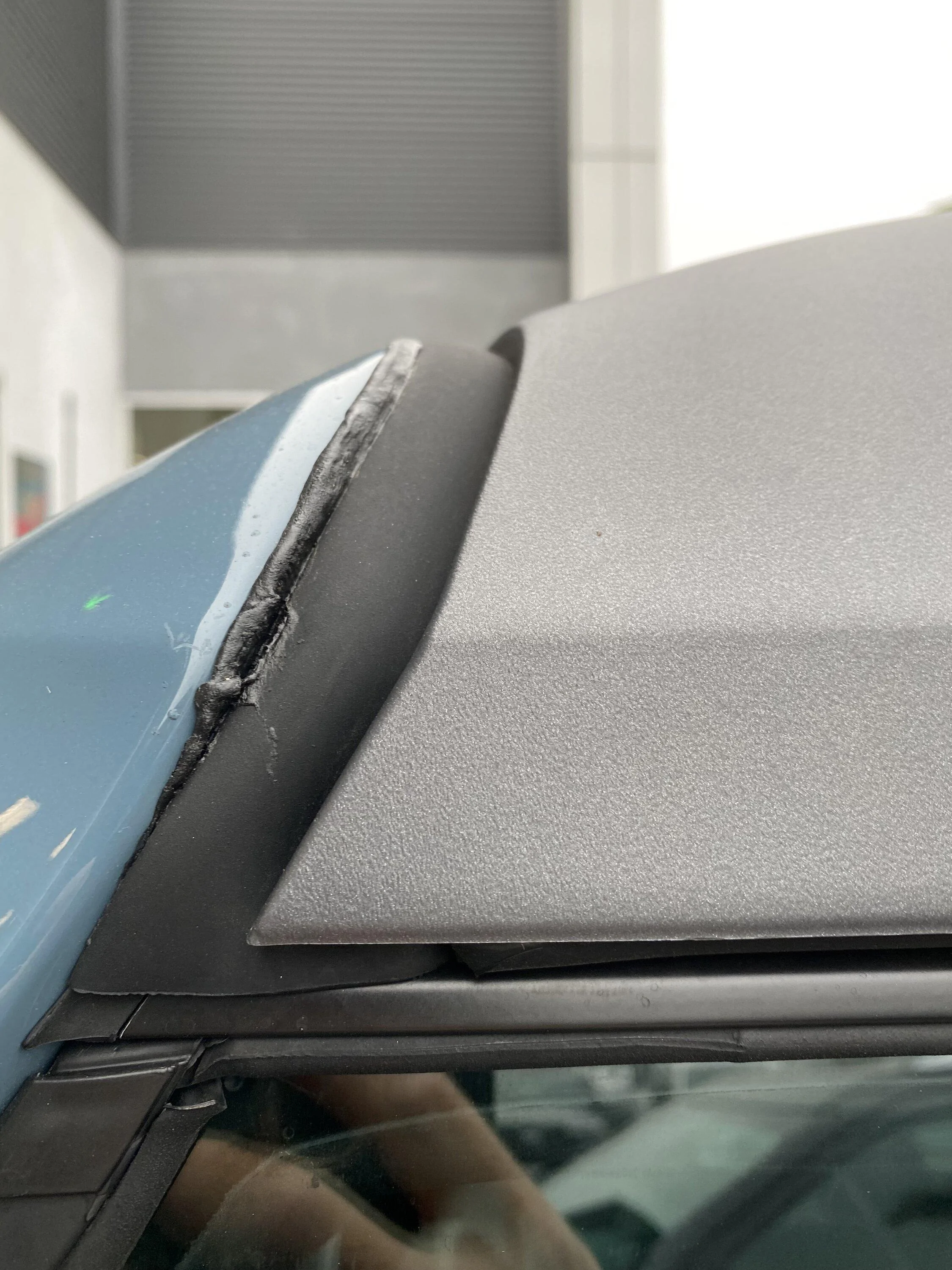

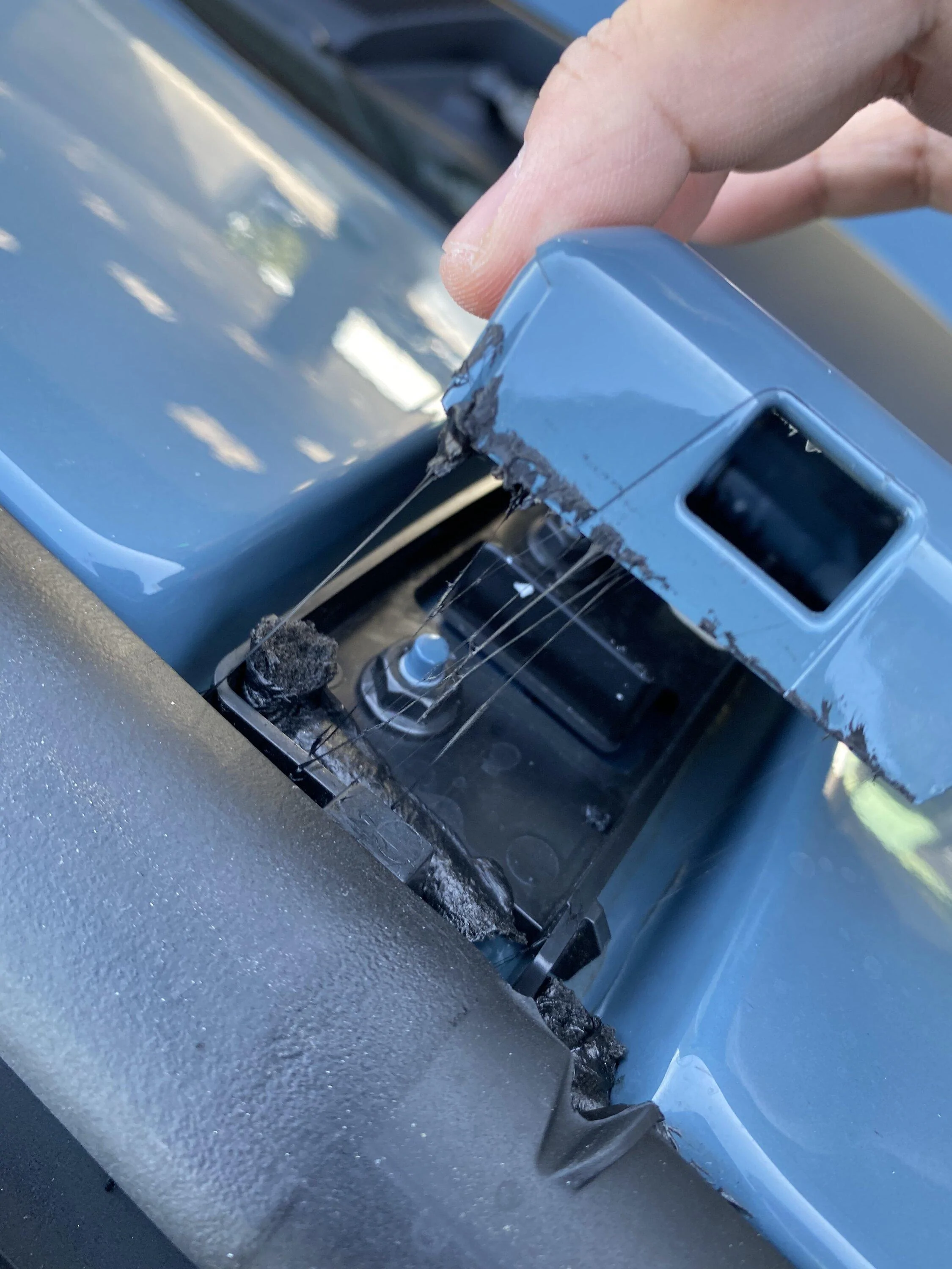

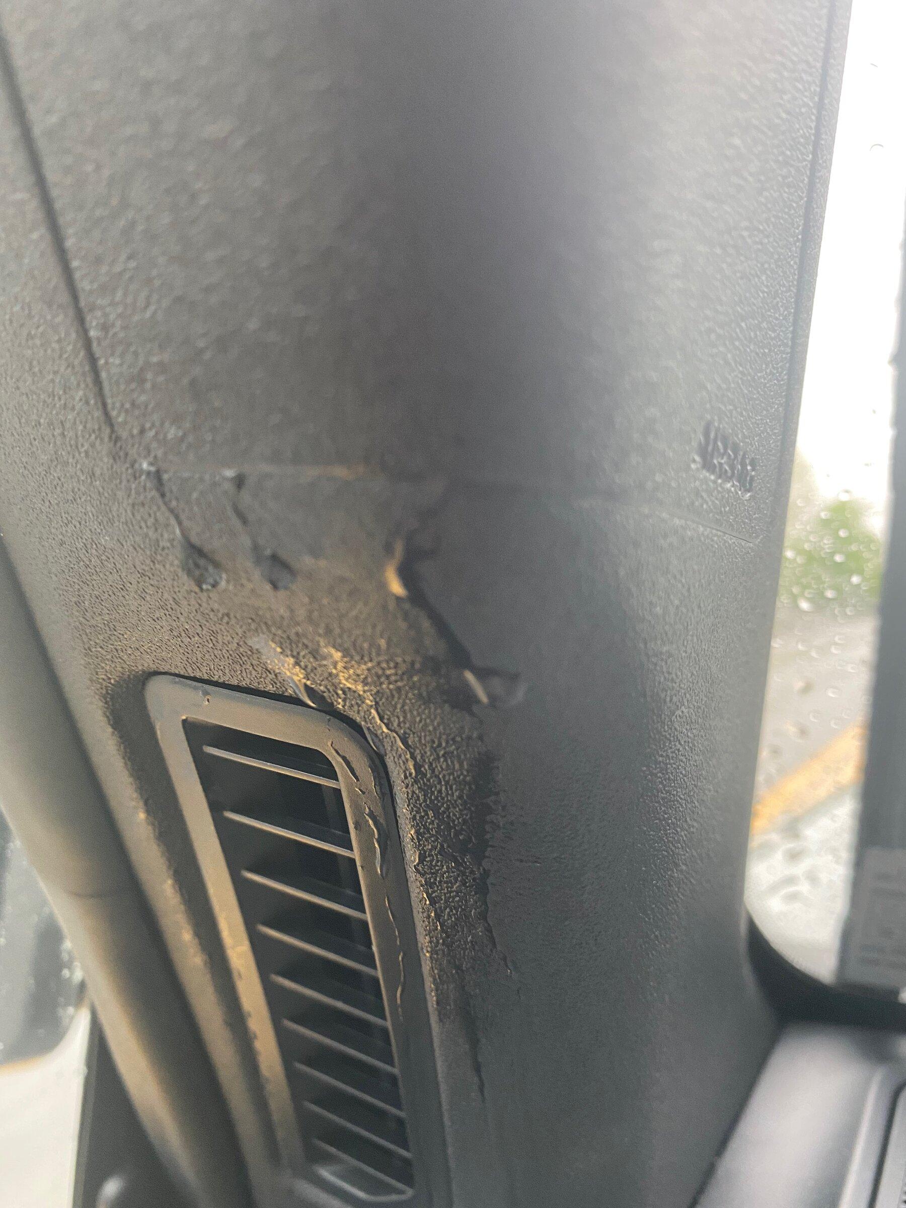

I've been having the same issue even after I brought my bronco in to have them smear a whole bunch of caulking/black silicone around the seams and still leaking, so I got a leaking top and silicone smeared all over the top 🤦‍♂️

Wow that looks horrible. They attempted to fix my leaks before this new safety recall came out and my dealership was much cleaner but I still have a leak much smaller but still there.
