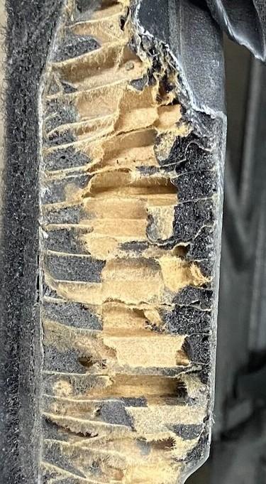

If you zoom in and look carefully you can see how the cardboard is infused with a protective resin of some type. This at least validates it is not plain raw soggy cardboard and will at least handle some amount of humidity.
This has nothing to do with the raw unfinished edges that WILL separate/delaminate from water and freezing.

Hello! My store recently replaced a MIC 1.0 top for one of our customers, and part of the replacement process required us to cut up the old top panels. Would anyone be interested in seeing the inside of the MIC top?
Edit: Below are some pictures that I took of the MIC 1.0. After inspecting the top and seeing just how thin that outer shell is, I can see why the honeycomb structure of the top was showing through when exposed to extreme heat/moisture.
Looks like honey bees got in there and made a hive. It might have been better if they had. 😁 ✌

I don't give a shit about the material in the middle.I just want the material on both sides to be thick enough to be strong, stable,durable,and completely and forever cover up the shit in the middle.
It's as simple as that.

Making a wild guess you don't deal in raw material very often.
https://store.acpcomposites.com/aramid-honeycomb-core-standard-cell?quantity=1&size=6
Not to mention sheet prices of aluminum, boron and steel are all up exponentially.
http://steelbenchmarker.com/history.pdf
20 years ago you used to be able to get steel for a penny a pound. But this isn't the year 2000 and if we wanted to use your outdated standards, it's a $40,000 vehicle.
