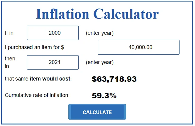

Making a wild guess you don't deal in raw material very often.
https://store.acpcomposites.com/aramid-honeycomb-core-standard-cell?quantity=1&size=6
Not to mention sheet prices of aluminum, boron and steel are all up exponentially.
http://steelbenchmarker.com/history.pdf
20 years ago you used to be able to get steel for a penny a pound. But this isn't the year 2000 and if we wanted to use your outdated standards, it's a $40,000 vehicle.
Oops, the real world checked in. Things are expensive. Price of cars has been stagnant for decades.
You are correct that car inflation has been quite low for the past 20 years, but overall inflation has been very very low as well by historical standards. The steel pricing you reference is very recent but very real. (And may show up in car pricing later)
I suspect that this design which is unique and has failed in some ways is all about a need to cut weight. Same reason certain models can’t get a roof rack, etc. And perhaps why Ford asked them to cut the materials by 30% which will cut weight.
