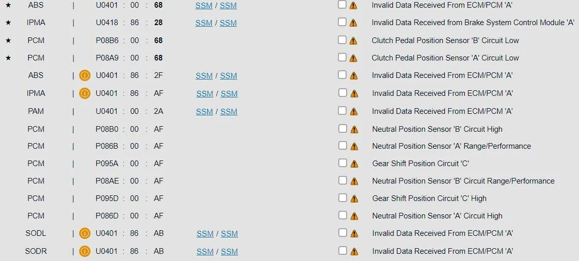

Looks like some type of wiring concern, possible rodent damage. Lots of manual transmission specific codes set, but not all of these sensors are located in one area. Some are on the transmission some are near the pedal.
