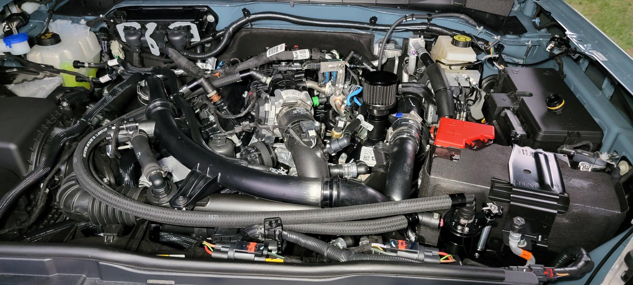

Alright guys so I installed a UPR catch can and oil breather cap on my 2.7 bronco day 1 with 40 miles. I have 1,600 miles on it so far with some hard use, first oil change performed at 1,000. At no point has the catch can picked up anything. There is a slight oil film inside but nothing more. Catch can is definitely installed correctly. Anyone else have this "issue" or know what could be the cause? The only thing I could think of is the breather cap is allowing the crankcase to breath so well that the catch can doest have enough oil to pick up. There is often oil coated around the cap. Any help is appreciated.

There is little deposit because on inline Ford motors they actually include an oil separator on the side of the crankcase.
It’s not much more than a glorified sponge but it helps baffle and collect a majority of atomized oil/fuel before it makes its way to the intake. It’s not the greatest though and you can definitely get use out of a catch can but in mild normal driving a single valve can will usually not pick up too much.

I wonder if the tubes for the UPR catch can are too long for the aerosols to collect into the catch can itself before settling in the tubes. I'm not an expert, but those tubes seem unnecessarily long and could actually limit the efficacy of the catch can itself.
I just installed my Mishimoto one on my ride this morning. Their catch can is installed on the firewall so it's much closer to the ports than UPR's. I'm wondering if Mishimoto's will collect more (opinions on the necessity of catch cans aside).

I installed the same catch can at around 500 miles. I now have almost 2500 miles on the engine and the catch can has a slightest coating of oil mist inside. I too thought it was installed wrong but UPR verified. Guess these 2.7s just run clean.

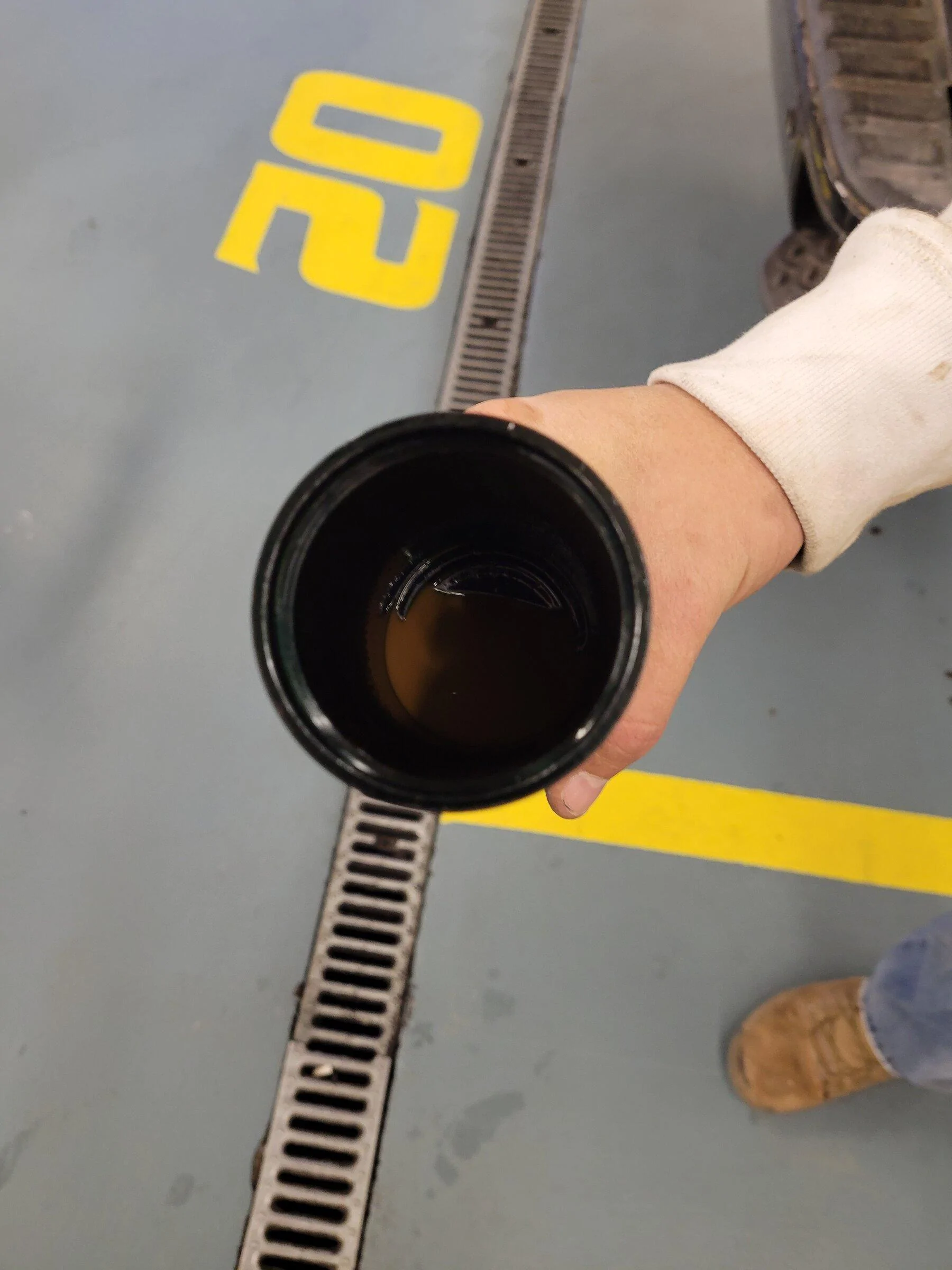

For those that say you don't
Ford Bronco Nothing in catch can? Catch Can contents
need a catch can. Check this :poop:. This is after 9,800 miles. That is not inside my intake and all the better.
