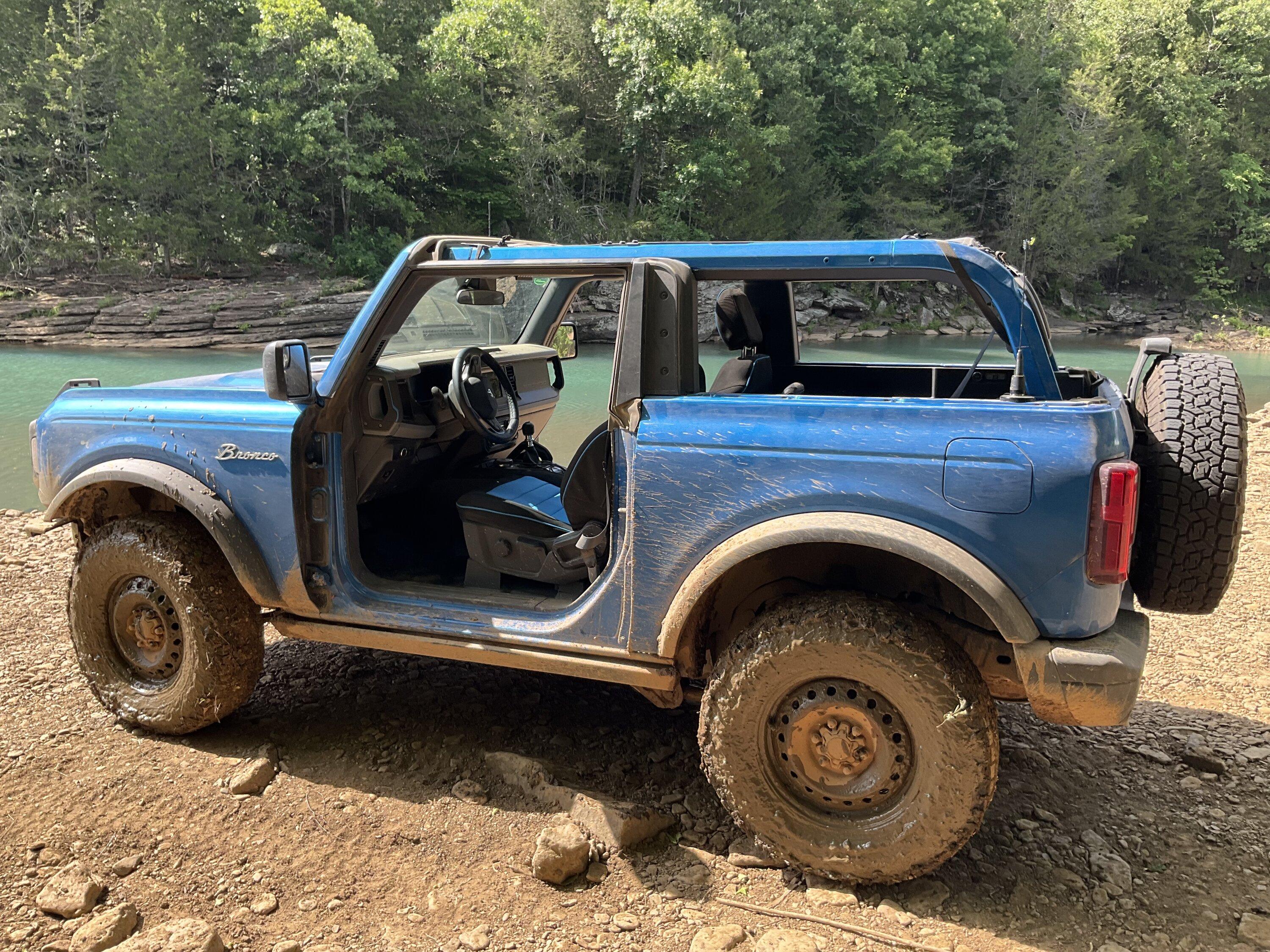

It is nice having the doors off but he is not wrong. Looks more like an afterthought from Ford with the way the exposed door jams look. Does not look really bad but does not look great either.
I think it looks great.
Ford Bronco Oopsie... dropped and dented my door this weekend 93FEBD60-2FC1-4A1B-BB71-8237742D5124

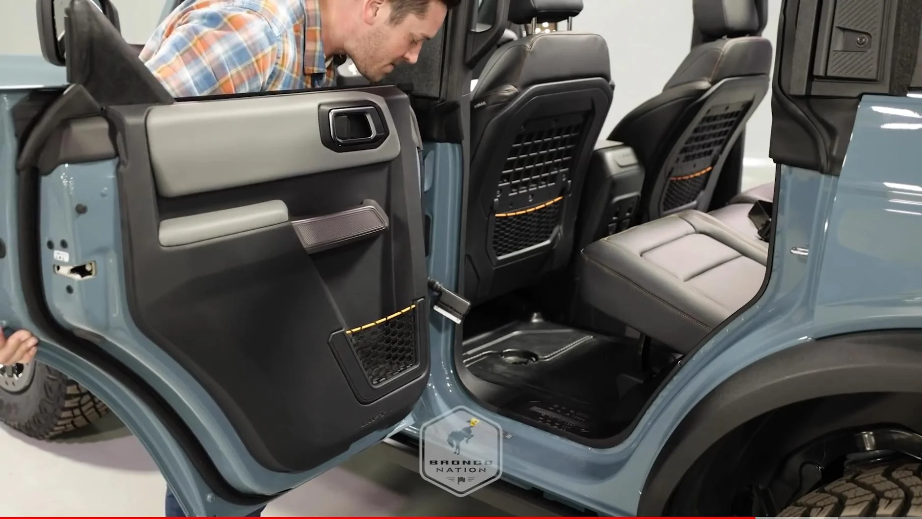

When I did it I was standing on the outside, because I wasn't sure how wide open I could have it and get it aligned. I suppose standing on the inside might be better. I haven't done it enough to figure out the ideal way to do it.
Interesting. I re-watched the Bronco Nation video, and they remove and install the doors from the outside, too. :unsure:
Ford Bronco Oopsie... dropped and dented my door this weekend D968FC3E-65A5-4103-AE7D-18E883F85DFB

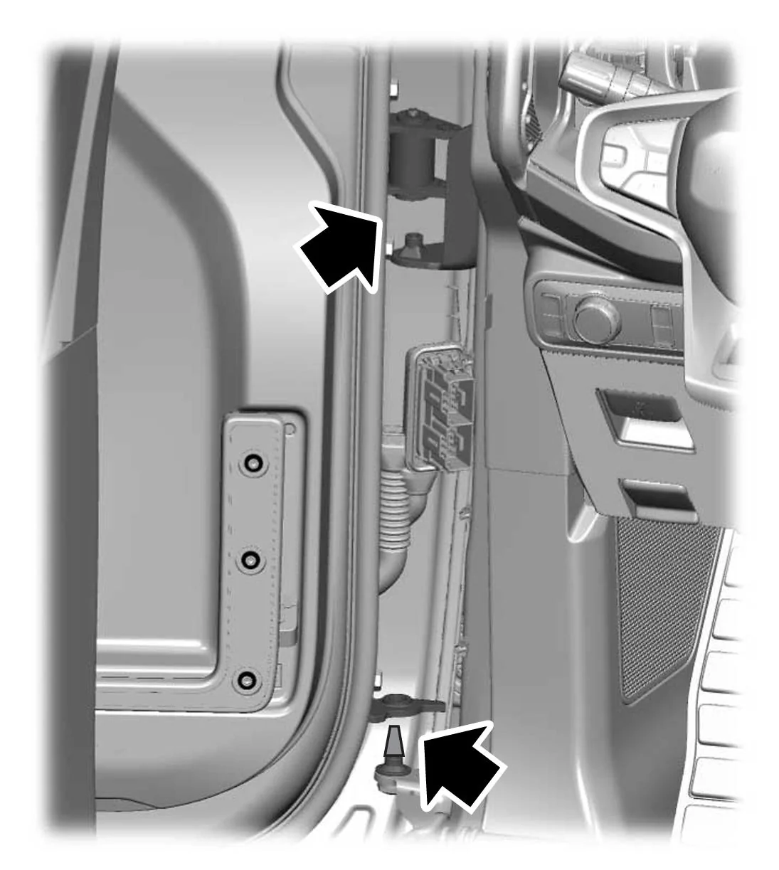

Next time you do it, try it from the inside. It makes it much easier to hold the driver’s side door handle with your left hand reaching over the door while holding the lower part of the door with your right hand. That way, your head will be facing directly into the hinges, which makes them much easier to see and align during door installation.
In fact, this drawing from the Owners Manual shows you exactly what you will see when installing the door from the inside, between the door and body.

That’s the most counterintuitive way to do it, but I guess now I better understand why people are dropping them. Hold the door from the inside. They even put a handle on it to hold on to. I can't imagine unbolting the door, then walking around to lift it up or trying to put it on blind, and then walking around to put the bolts in. Never even crossed my mind.

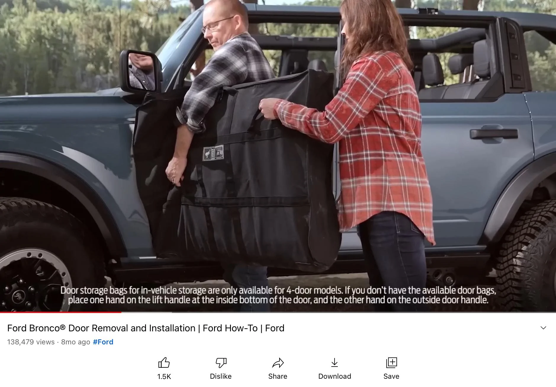

I just re-watched Ford’s own video on door removal, and although they also rely on door bags, the primary person lifting the door is on the inside between the door and body.
Ford Bronco Oopsie... dropped and dented my door this weekend 0B4AFD8B-9995-49A0-9A9D-C223B71C18A9

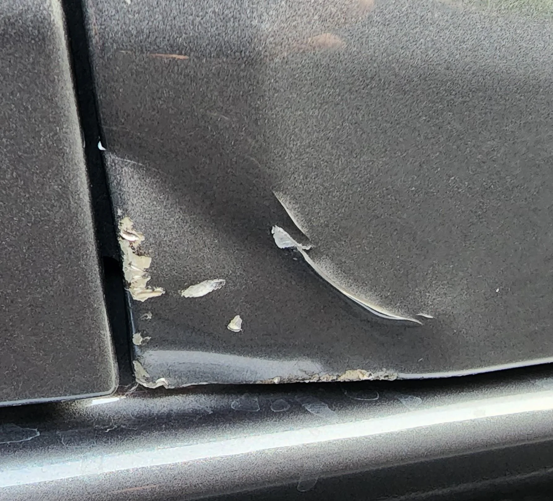

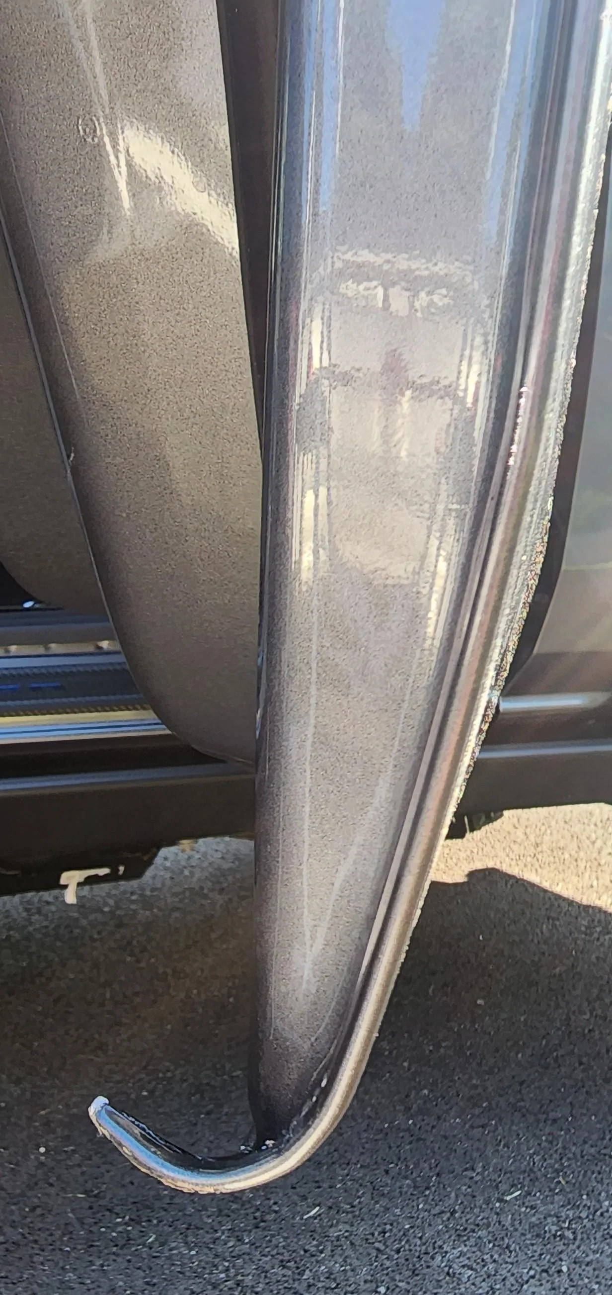

I feel the pain. Did this the first weekend I owed it. But by learning from my mistakes, I will have something to hold the door. Next summer plan to have doors off quite often.
Ford Bronco Oopsie... dropped and dented my door this weekend Door Damage 1
Ford Bronco Oopsie... dropped and dented my door this weekend Door Damage 2
