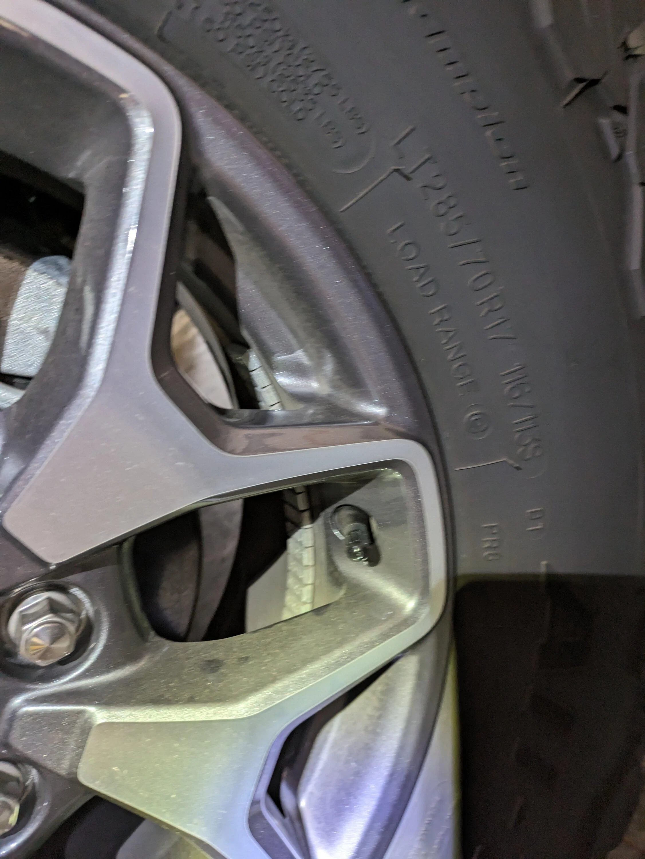

I generally like BFG KO2s and hadn't previously heard of any common balancing issues. THAT SAID, I have the OEM KO2s on my Badlands and 3 of the 4 have a shocking number of wheel weights. Like 6-7 ounces of total weights on a single wheel. I counted about 25-27 quarter oz. weights on this wheel (lost track).
I would be more inclined to believe it's the wheels. I transfered mine to black steelies and they required no weights. See my profile pic.
