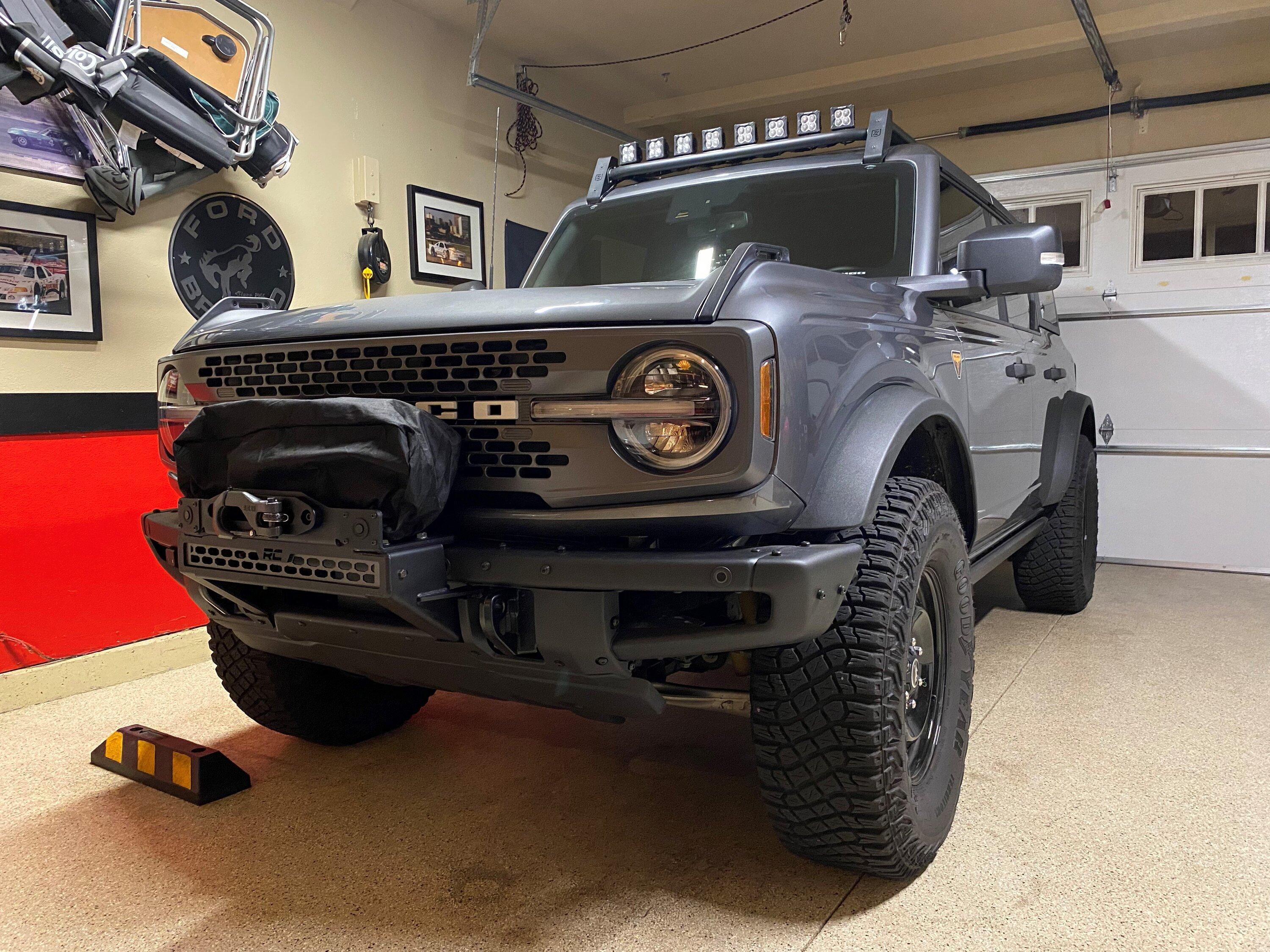

Yes, that was my thread. Here's the video when I was having the problem and the final result is listed after the video below. May help with solutions.
FINAL UPDATE: The dealer was able to remove the bolts, re tap, and put new bolts in. Took about four hours. The dealer did not charge and made it a warranty issue. Confirmed that the bolts were indeed not installed correctly from the factory.
RECOMMENDATION: Feel free to remove the rings, but if you run into a bolt that seems very hard to turn. Stop and put it back in. There's a good chance there are more and you risk stripping the bolts.
IF YOU'VE ALREADY STRIPPED THE BOLTS: Call the dealership service manager and go through him. Have them order the new bolts and make an appointment for repair. Calling Ford warranty department is pointless. Only the dealership service manager has the authority to make it a warranty issue (be very cool to him)
The service manager is the go to guy for this issue. The wheels are not covered under warranty, but the tires are. The service manager has to work with Ford to make it a warranty issue. Luckily, Newberg Ford has been wonderful to me and always seem to do the right thing.
Feels good to have Bubbles back together again.
I've since removed the wheels and replaced them with Black Diamond wheels:

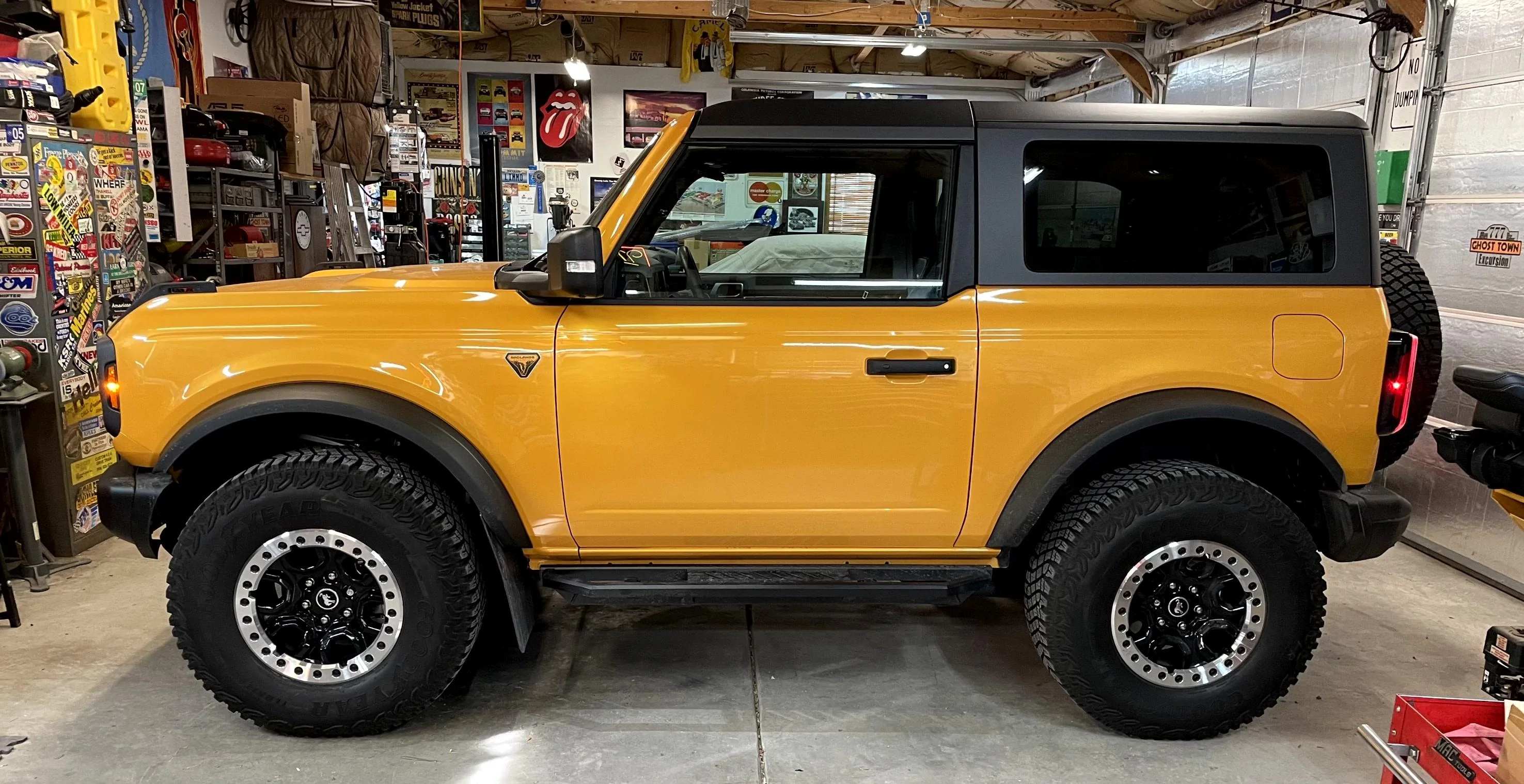

I removed my screws with a Snap-On socket and an electric impact gun. They all came off just like any other bolt I have ever removed. The new Ford Beadlock Bolts are torqued to 48 Ft. Lbs with NO Locktite or Anti-seize.
Here's a picture of the new Ford Beadlock Rings.
