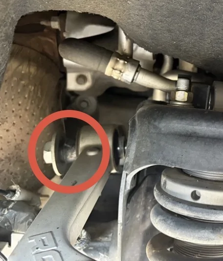

I don't see anything in that picture that seems off. Is there a bare bolt somewhere?

This is true. Paint mark is just a quick visual check to tell you the bolt hasn’t backed off.
Paint is often used in the factory as verification that a fastener has been torqued to final specification. This allows for fast visual inspection down the line. It won't keep a fastener from getting loose.

is with a wrench, one is visual. Bolts can stretch and be out of torque, bushings can compress.
I guess I look at it as the witness mark is only used as a visual indicator and should be applied after the appropriate torque has been used. If it moves, the connection needs to be looked at. Just a quick way to verify if something has loosened or not. Saved our bacon several times with the aerospace portals when paint marks on the bolts holding the brake brackets on weren’t lined up.
I agree, they can also function as a witness mark if applied properly. But sometimes they cover the entire fitting and you lose that feature.
Just have to clean them up for a remark. Had to do that more than once.

I may add...make sure your torque wrench is calibrated. While installing my ICON UCAs I was torquing said bolt and snapped it clean off.
