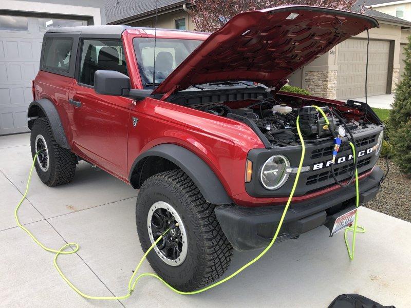

I researched all of this eariler in the year and bought everything in mid-April. I looked at all of the compressor options and the best deal for the price was the SmittyBilt 2781, which cost me around $150. I then built my own 4-tire inflator/deflator system for another $150. I can air down four Sasquatch tires from 40psi to 20 psi in three minutes. Airing back up takes 10 or 11 minutes. I've done it a bunch of times and just use a timer on my phone so that I don't have to keep checking the pressure. It takes a little longer at higher altitudes or higher temperatures.
Researching this subject, there were supposedly better deals out there, but they were always out of stock or it was a promotion that is no longer active. Note that I had to change the chuck on the SmittyBilt from the weird thing that it comes with to one that matches up with common air tools.
This is the sytem in action:
