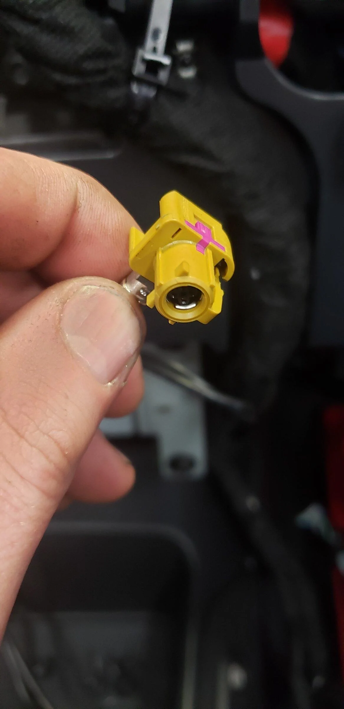

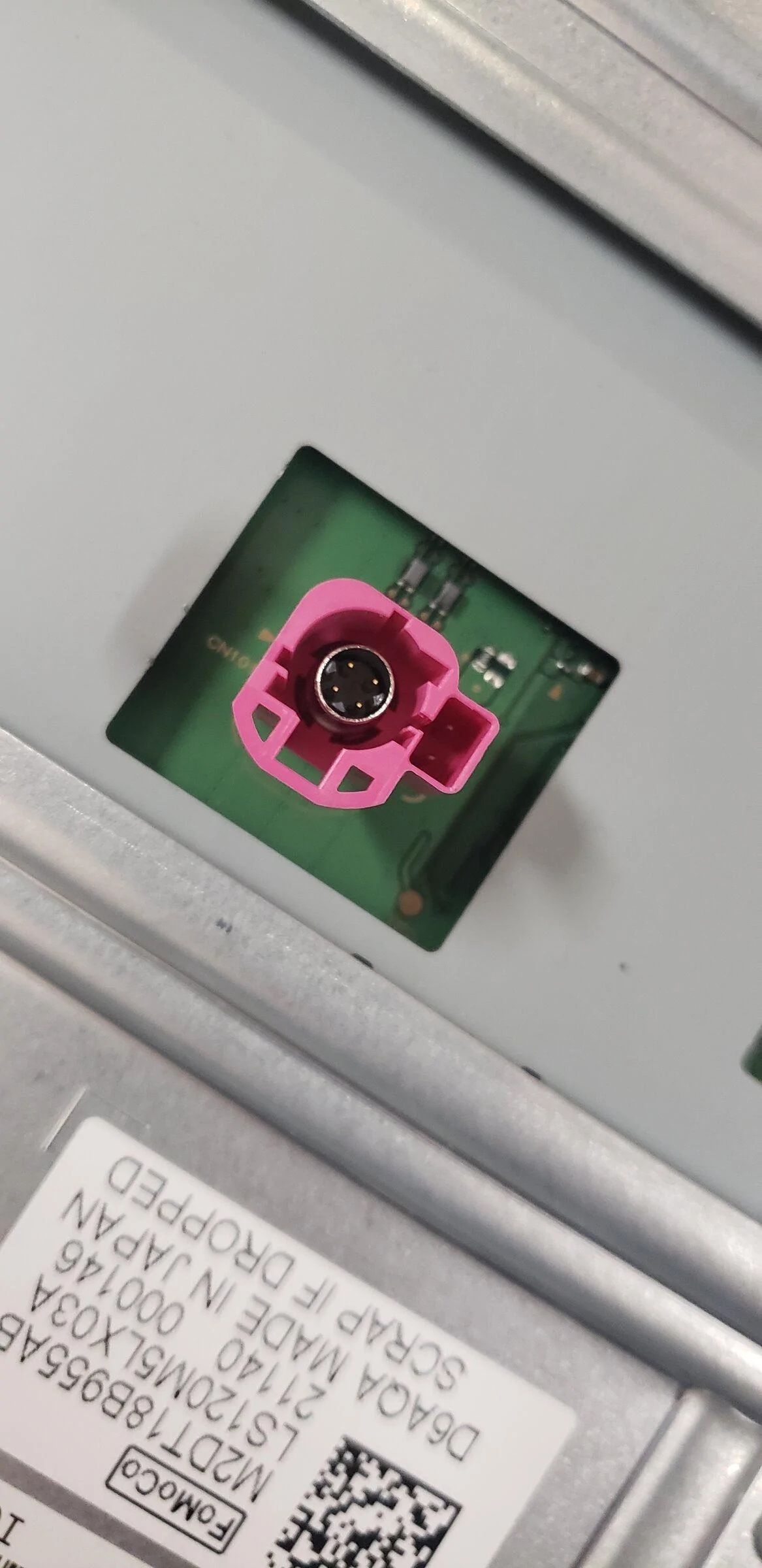

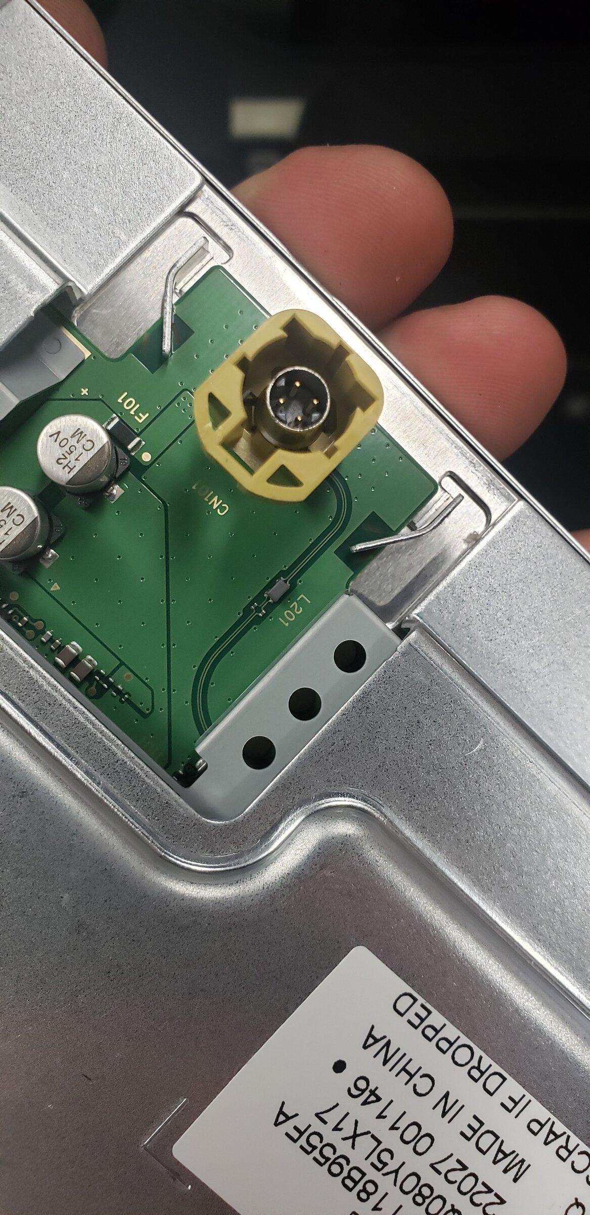

So after ripping the dash apart, I found that the 8" has a slightly different connector than the 12". 8" is a tannish color, and the 12" has 2 additional pins that almost look like an old hard drive jumper connector. I did not order the cable as I wasn't sure which was the right P/N for the 12". In addition, the 8" tan connector on the wire from the tuner has an additional tiny alignment tab. I cut it off to see if it still worked, but audio only. So short answer; you would need the RH dash panel, the 12" screen, and the 6-pin pink connector at a minimum for the conversion.
I did go through Forscan to see if there were any obvious settings to swap from 8" to 12" but nothing I changed kicked it on. I will order the wire and give it another stab at another day, but in reality I like the 8" screen... the 12" is almost, well too much going on with the dash. The 8" also has say a finger rest to help press the right button, instead of hitting a bump and impaling the screen with your finger on some random spot with the 12".
Gotta move onto the bumper and light installations since this was not successful at the moment.

I tell ya, I just took over a cancelled order on a Basesquatch, and had never seen the size of these Bronco's up close so I hopped on the forum and just dropped the dash and screen on my parts list, in the hopes it would work and I could help a ton of other members. Well, I'm on the fence about returning the screen and dash, which would more than cover the black tipped dual exhaust, but I also don't like failing or surrendering because I got my ass kicked once. Improvise, adapt, and overcome. If any members want me to get the required cable and continue trying, I'll do it just because I don't want to fail anyone here, let alone myself. Also I forgot a screw and lost 2 black clips somewhere...
Addendum: I did notice there is a Sync 4 and Sync 4 v2 listed in Repairlink... and my radio plug appeared to have where another identical, or optional plug placement would be to make the 12" screen work, so the possibility absolutely still exists that the entire radio module would need to be replaced with the screen and cable. The second plug on the back of the 12" screen appears to be just for the 360 cameras.

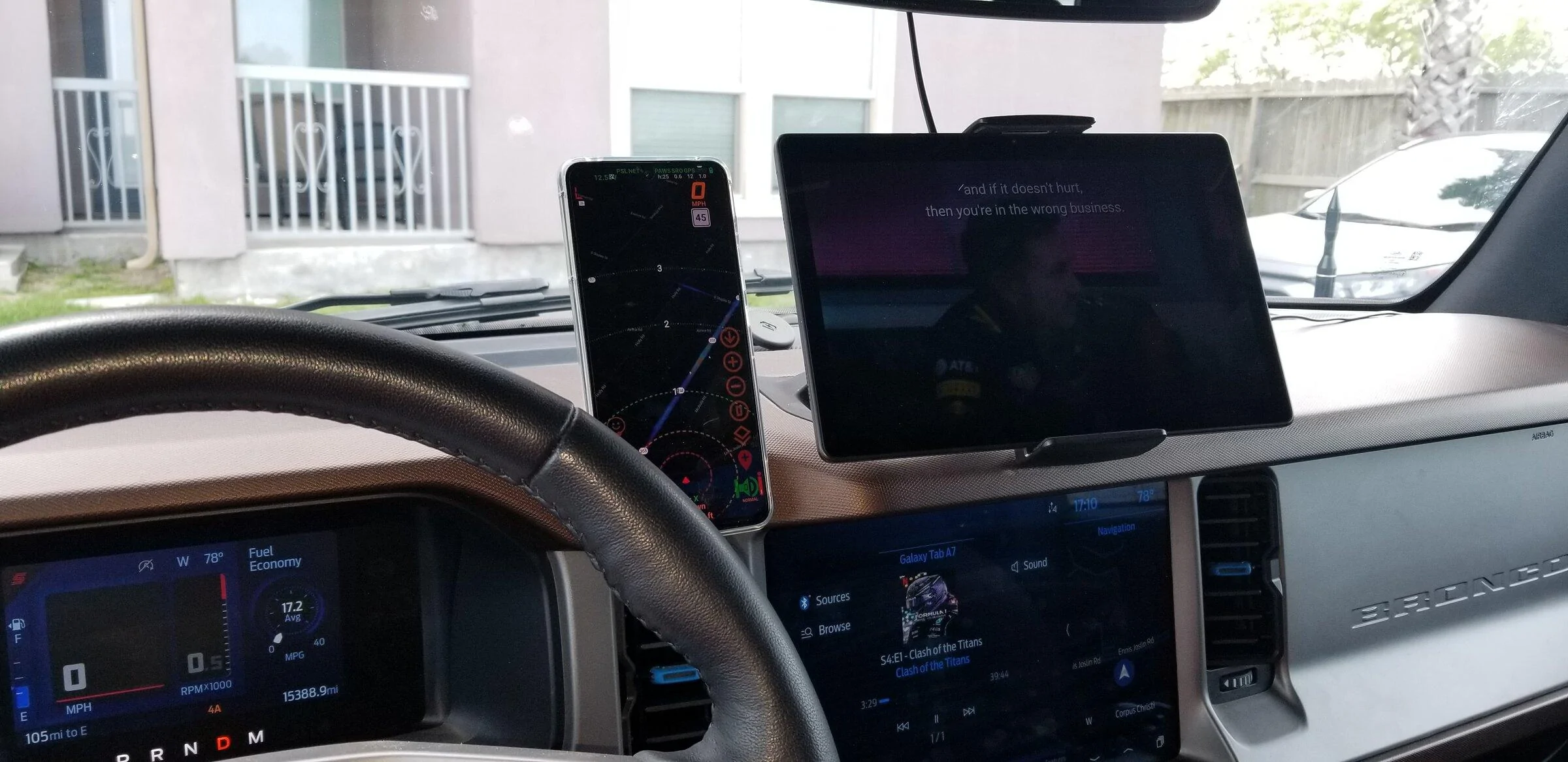

Although, I have the 12 inch screen, there is a lot that the vehicle won't let me do with it. So I mounted a 10.1" Samsung Tablet above the 12 inch table to watch what I want, when I want. For the most part, this works really well and allows me to move screen where I want it while driving (use it mostly for podcasts or JBV1).
so what does your tablet look like mounted and what mount did you get? I have the big iPad with the cellular connection that works like a champ for everything I would ever need.

That would be a huge help to me, if anyone would be willing to tear theirs down for us. I would need only 2 pictures: one picture of the back of the 12" screen where the 2 pins are next to the 4-pin pink connector, and a picture of the pink connector on the radio itself; I would like to know why there are 2 solder locations for the 4 pins on the radio, and if the 2-pin actually has a jumper terminal on it...
Hard to convince someone to tear a new dash down that far only for pictures, but here's my deal: I will offer up my Ford Service login credentials for as long as I have access (which should be for quite a few more years), which is good for all F/L/M products 1994 up; all service info, teardowns, torque specs, etc. This is not a cheap offer.

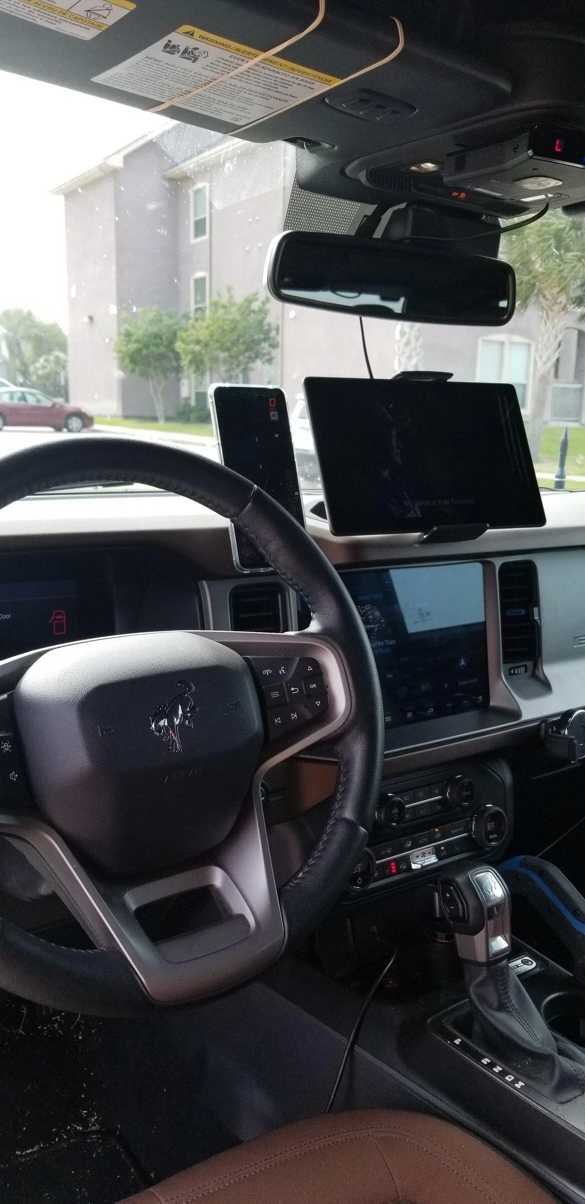

Here you go (I can switch the tablet to sit lower - and normally run it lower than shown here).
Ford Bronco Replacing 8" with 12" Screen? 20220425_171058
Ford Bronco Replacing 8" with 12" Screen? 20220425_171228
The lighting was bad, but they are easy to see if you are sitting in the driver's seat.
My cellphone is running JBV1 in this picture, Netflix is on the tablet, and my V1 radar detector is where the sunglasses normally go.

What’s the type of mounts? Got a pic from the back side of that to show how they are attached? Did you add a rail up there?
