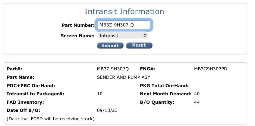

It shows that there are 44 pumps backordered right now, but it also shows 63 pumps will arrive at a depot on 9/13. If this is correct, it shouldn’t be much longer.

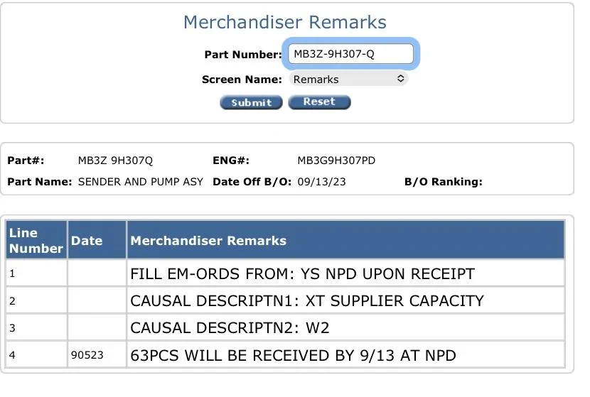

Ford Bronco Second Fuel Pump Failure IMG_1988

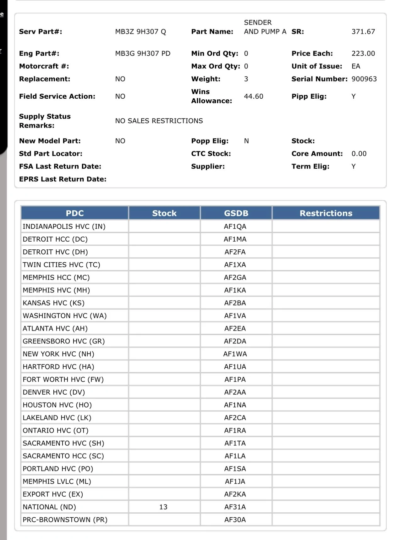

Ford Bronco Second Fuel Pump Failure IMG_1987
Thanks @Ducati1098!

Shows 13 in stock at the National depot so I’m not really sure why they haven’t received it yet.
