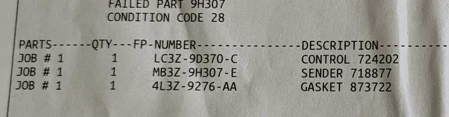

LoL... Technically, this will end up being pump #3. ;)
Controller and Sender were replaced previously but not a bad plan to look at other parts in chain.
