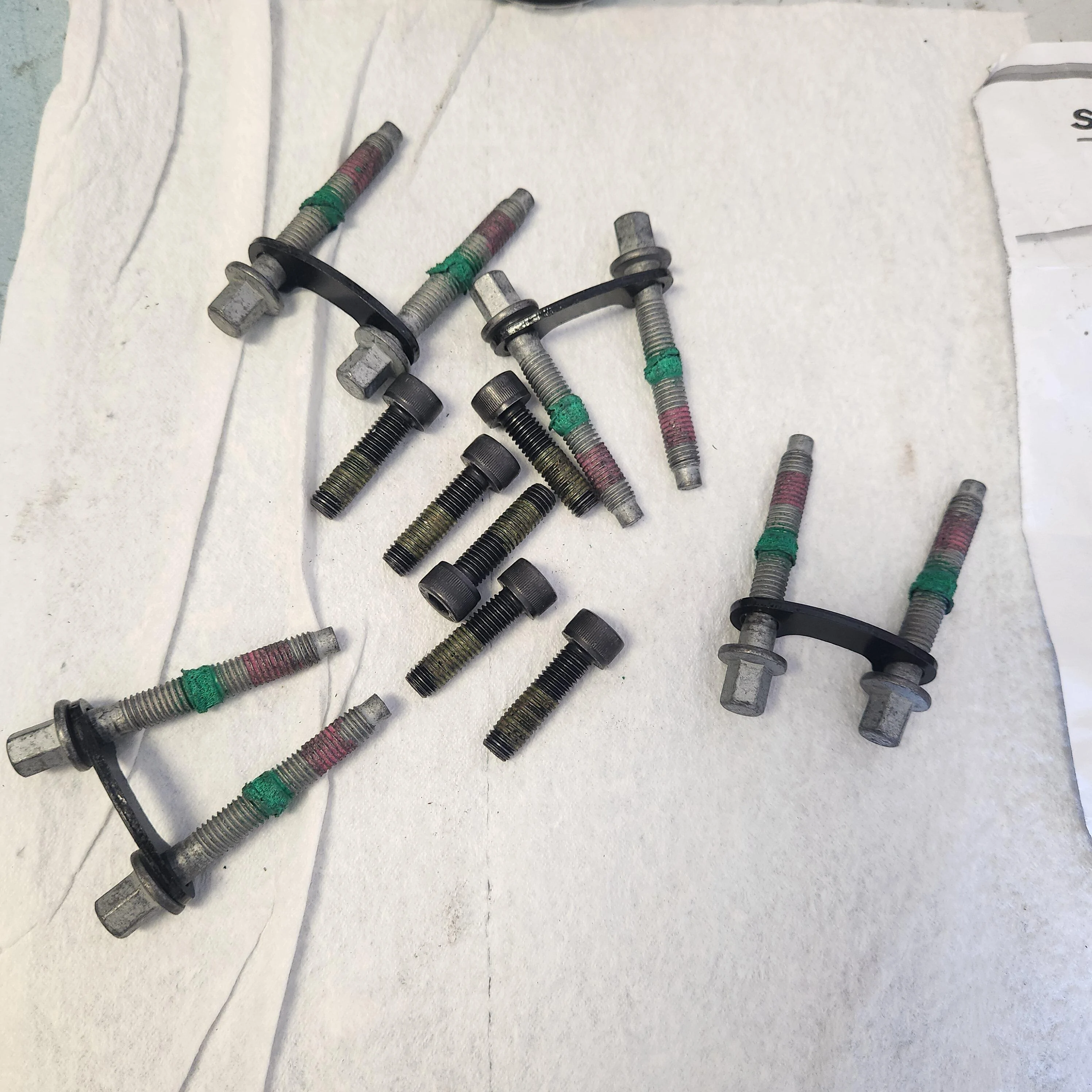

my new Heavy Duty Spicer driveshaft showed up this week and I slapped it in today. easy to do swap. looks beefier than OEM however I admit I was expecting a double Cartan U-Joint on the transfer case side. I'll run it hard with the 40s and report back if there's any issues ...comes with new bolts and instructions.
