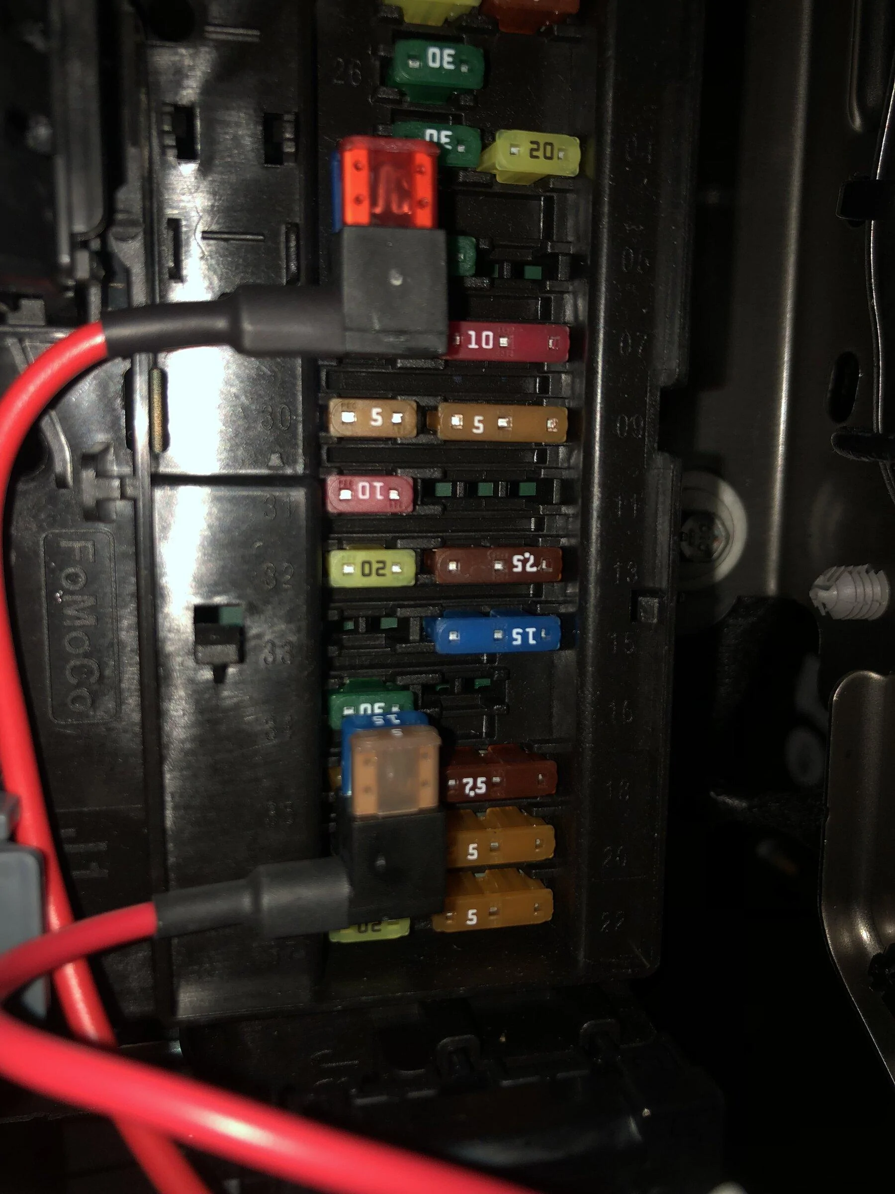

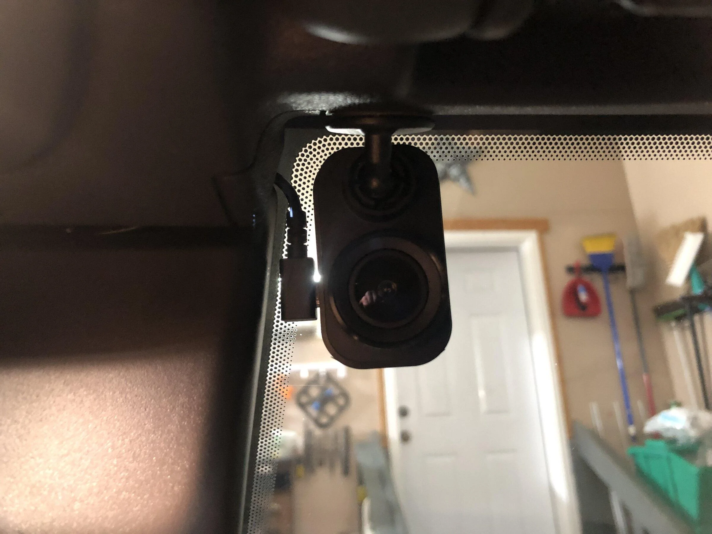

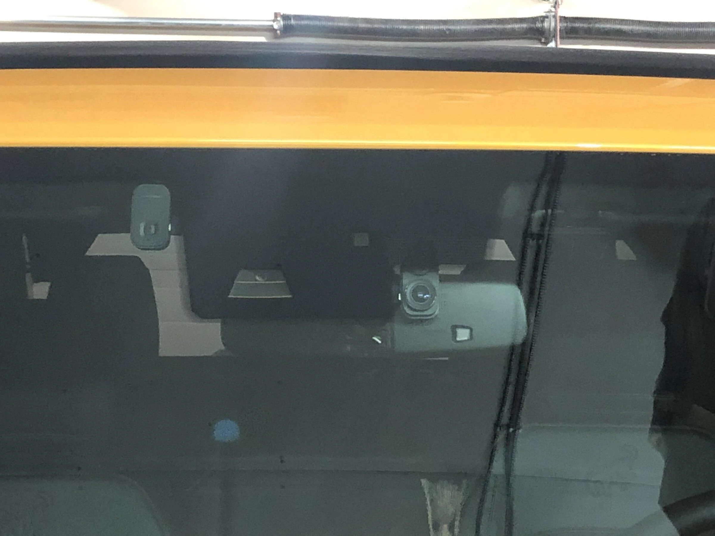

Funny you should ask - I just came in from taking pics of my dash cam install.

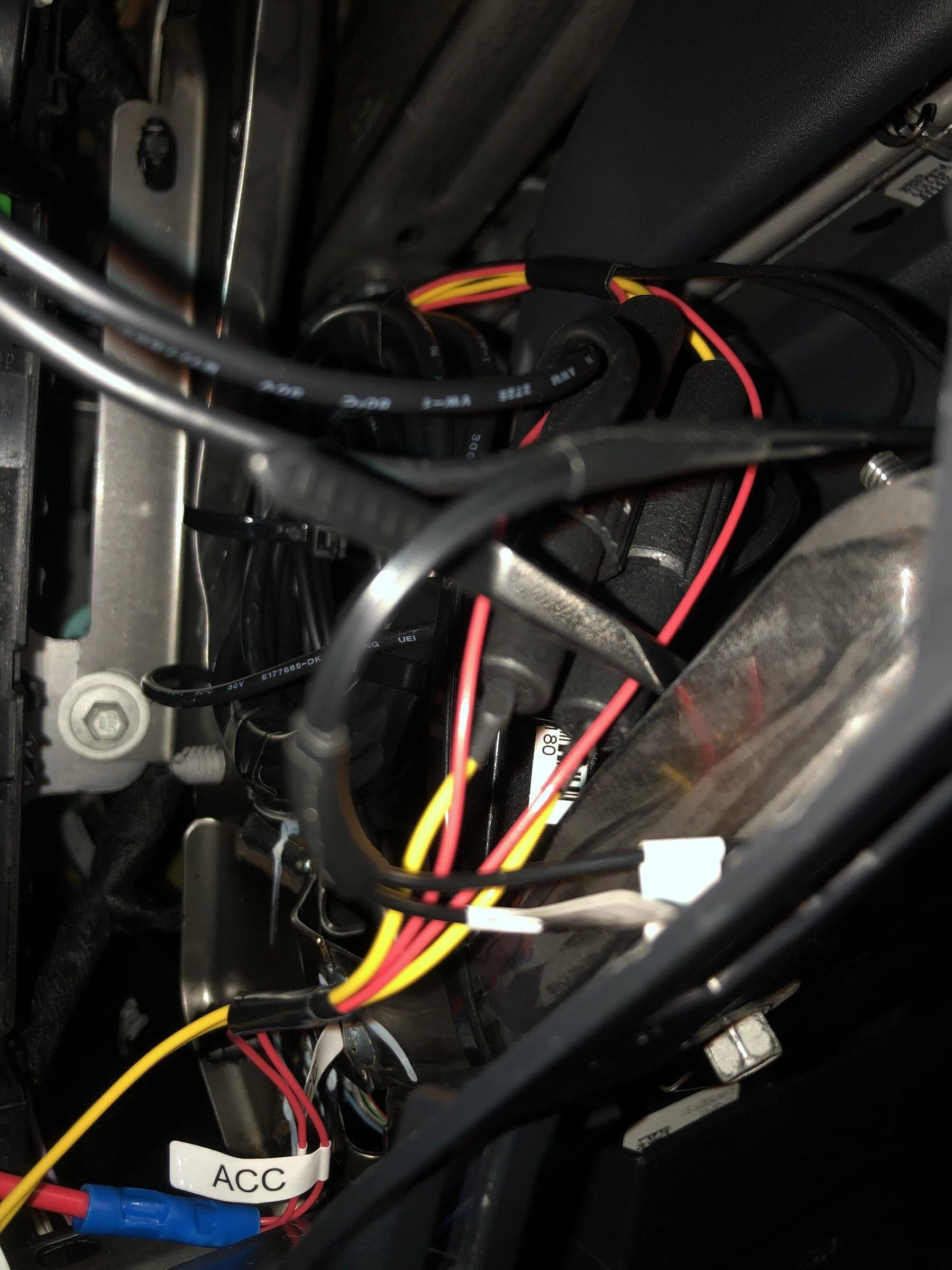

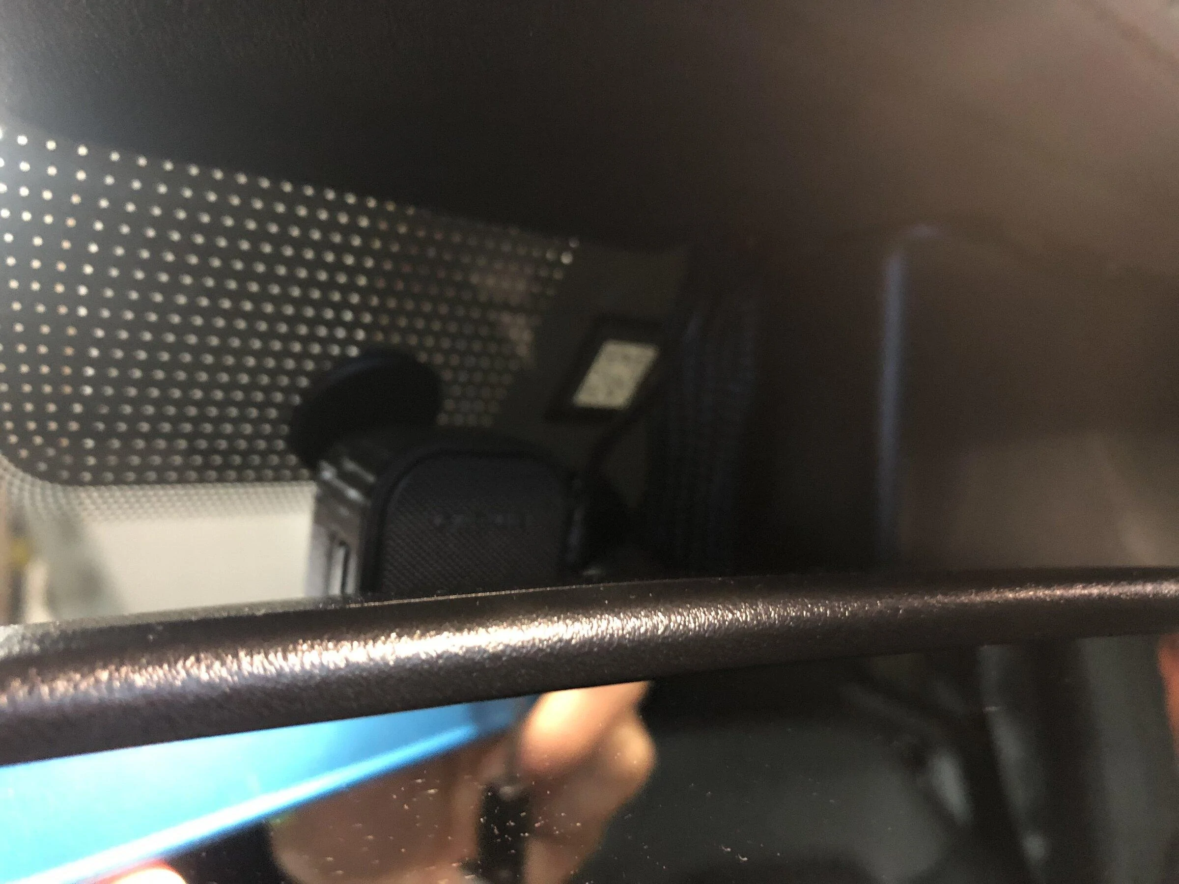

I decided to go with 2 Garmin Mini 2 cameras, one forward and one rearward-facing. My goal was to have one looking at the interior of the Bronco and be triggered by movement in case someone got into it. Both cams are permanently wired to power using Garmin’s Parking Mode cable.

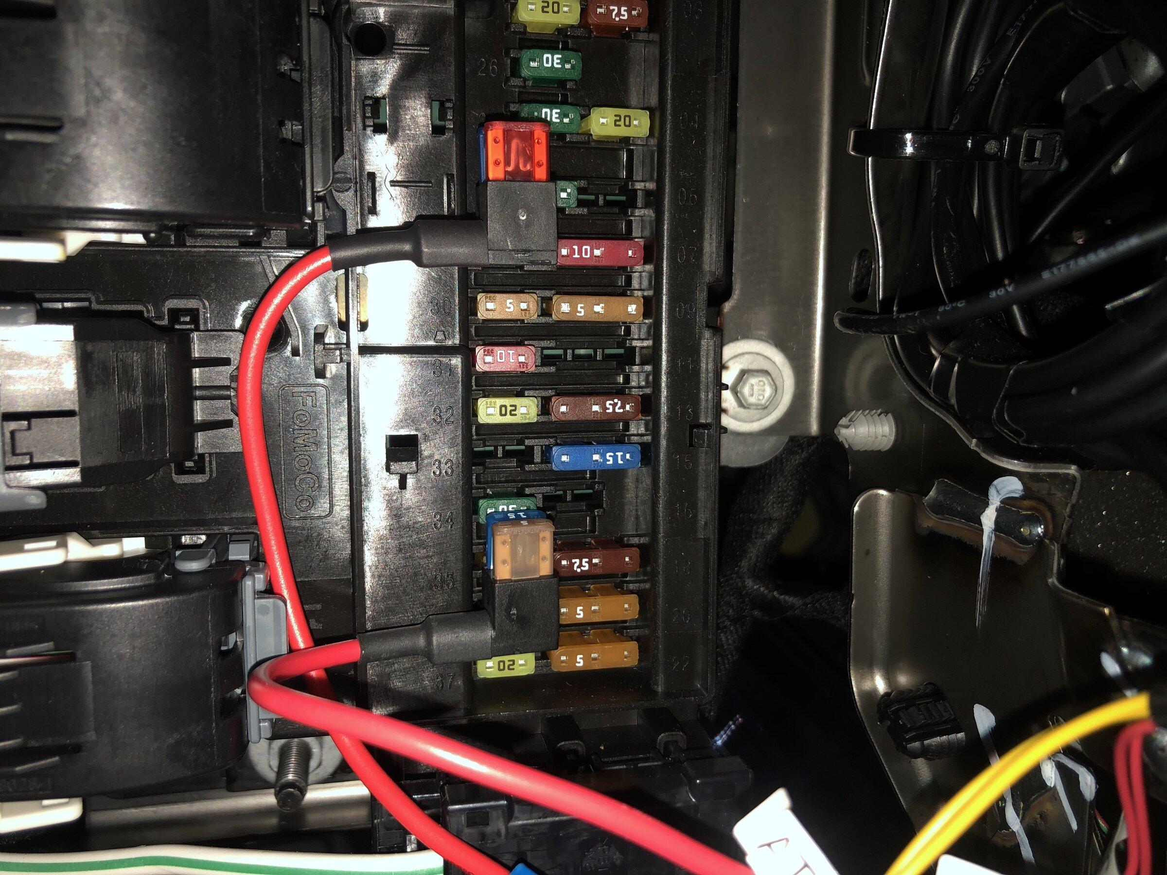

I have determined that spare fuse 35 is <edit - switched> power (at least past 1.5hrs of an undisturbed Bronco) and spare fuse 29 is <edit - permanent>. I used two add-a-fuse adapters to make the circuit addition straightforward. Wires were fished up to the A-pillar then tucked under the trim pieces to the mounting locations at the rearview mirror.
I went with the Mini 2s because of the excellent price point and the small size. You barely notice them.

Are you sure about the fuses? 35 on mine is switched with ignition.
Well, now I’m not sure though I was when I typed that message! I do know that my parking mode works correctly, as do my cameras.
Can you check and see if I have my labels backwards with fuses 29 and 35? My Bronco is currently an hour away from me.
Note I have a Badlands with the High Package, FWIW.
Appreciate it!

Yup I think you just called them backwards. 29 is up top and constant 12v, 35 is on the bottom and switched with ignition on mine. Also badlands but just mid package (man I wish I had that 12" screen)
