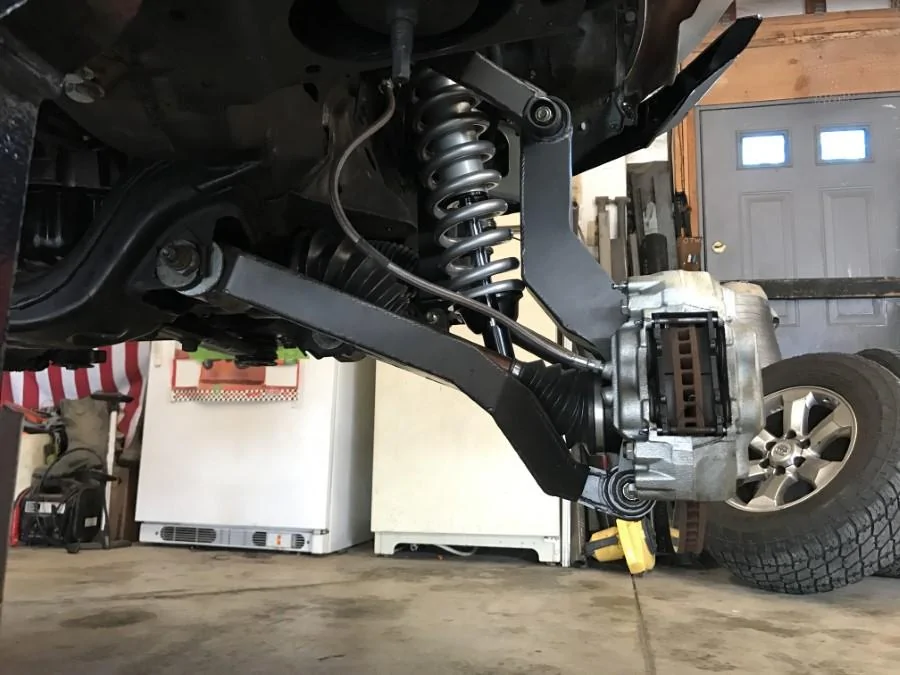

So if i'll play devils advocate a bit:
Again, if it is going to be IFS (lets assume solid axles don't even exist), Why is it
not a more extreme design, by a significant amount, vs what every explorer comes with?
And if it is, please point out where?

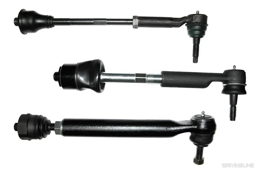

IE, are tie rod ends fully sleeved with high angle joints at rack?
Ford Bronco The IFS vs SFA Thread 002-chevrolet-hd-tie-rod-assemblies
Getting better than the std range adjustment cams on control arms?
Ford Bronco The IFS vs SFA Thread Chevy-1500-2019-Z6in-295-60R20-20-05
As I've mentioned, how about upgraded urethane boots?
Ford Bronco The IFS vs SFA Thread 740f2a0c927f1e0da0cd786c10a01934
High clearance upper knuckle for wide tires without them sticking way out?
Ford Bronco The IFS vs SFA Thread rclt-4r-002

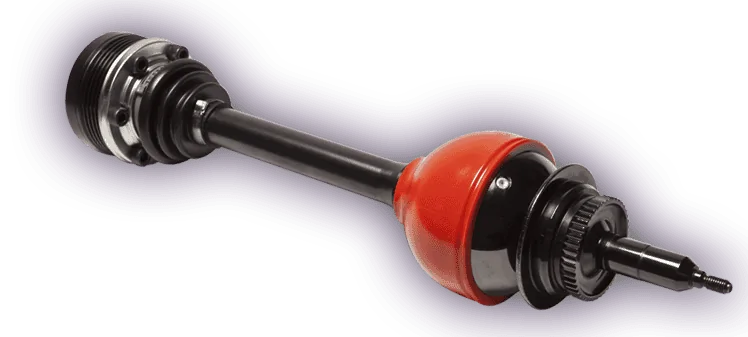

More diff clearance from factory angle of CV already aimed downward
Ford Bronco The IFS vs SFA Thread rclt-4r-005
and/or lower control arm clearance..
Ford Bronco The IFS vs SFA Thread rclt-4r-006

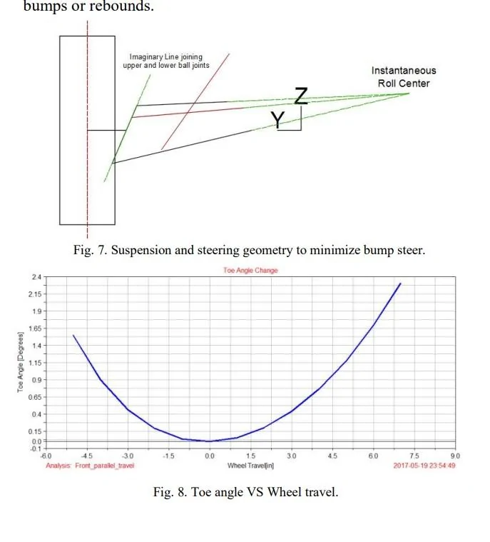

We getting above average bump steer (meaning less) and how? Something better than this?
Ford Bronco The IFS vs SFA Thread bump%20steer

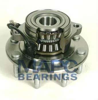

Better than typical IFS (Edit, meant ball) roller hub bearings??
Ford Bronco The IFS vs SFA Thread heel-hub-bearings-hub-units-515036-for.jpg_350x350
Obviously, many of these things we don't know yet, but the obvious from external pics
is not leading me in this direction so far.
