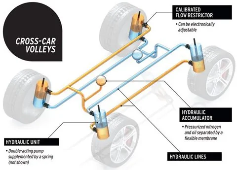

What you're looking for is called a Hydraulically Interconnected Suspension.
It decouples the 4 modes of suspension movement (pitch, roll, bounce, and warp) and allows you to tune the 4 more independently. You can get stiff roll and pitch stiffness and soft bounce and warp stiffness.
Ford Bronco The IFS vs SFA Thread kinetic-suspension-anti-anti-roll-bar-inline-photo-521291-s-original
You can combine it with electronically adjustable damping to get a pretty amazingly tuned and effective passive (read: immediate response and low energy demands) system.
A company out in western Australia called Kinetic came up with a version (H2 CES [CES are Ohlins' electronically adjustable damping elements]) that they showed off on several different typies of vehicle, then they were bought by Tenneco. McLaren uses a similar system (possibly Tenneco/Kinetic-sourced or co-developed but I never found confirmation of that).
HIS is the holy grail of decoupling suspension motion but there are similar system that use hydraulically decoupling rollbars. Versions of it have show up in Toyota and Lexus SUVs, Citroen used it to great success in the Xsara WRC cars, and I think Land Rover (and probably many others) have used it.
(video below is one of Kinetic's promo videos)

kinda figured I wasn't the first person to consider something like this, figured there was something already out there. I'll have to look into this more.
