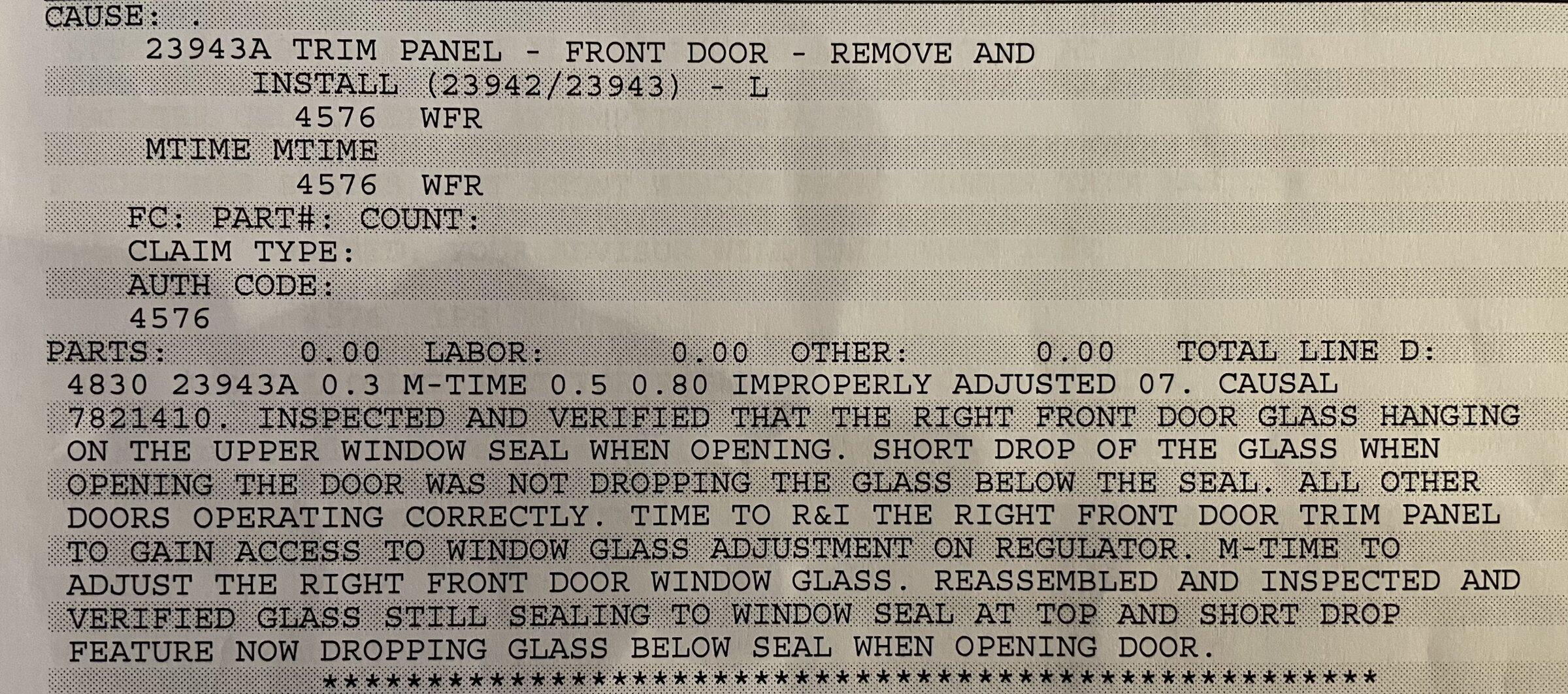

This was Don Davis Ford in Arlington. The service ticket is a lot to type so I’m just gonna post a picture here. DM me if you want to know the service advisor’s name. I just don’t feel like putting his name on a public forum here

I just printed out the screen shot and sent him a message to get the service advisors name. This is driving me crazy considering it's a 3 week old truck as of today and Ford acts like it is nothing.

I think there are things they can do but of course most are going to be reluctant. You and I just got lucky I guess, but if other dealers can call these ones that do appear to have a fix, then maybe more will get on the same page. I already DM'd @Swynn106 with my service advisor's name and if anyone else wants it just let me know.
