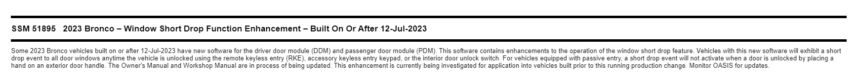

My Wildtrak was built just this past August 2023 and i do believe all builds after July 2023 where given a "fix". When i unlock my door(s) with my key fob, with my keyless entry pad, or with the unlock button on the inside, the window(s) come down before touching the door handle to open it. I just wished the fix worked on when i grab my handle for the keyless entry....it doesn't.
