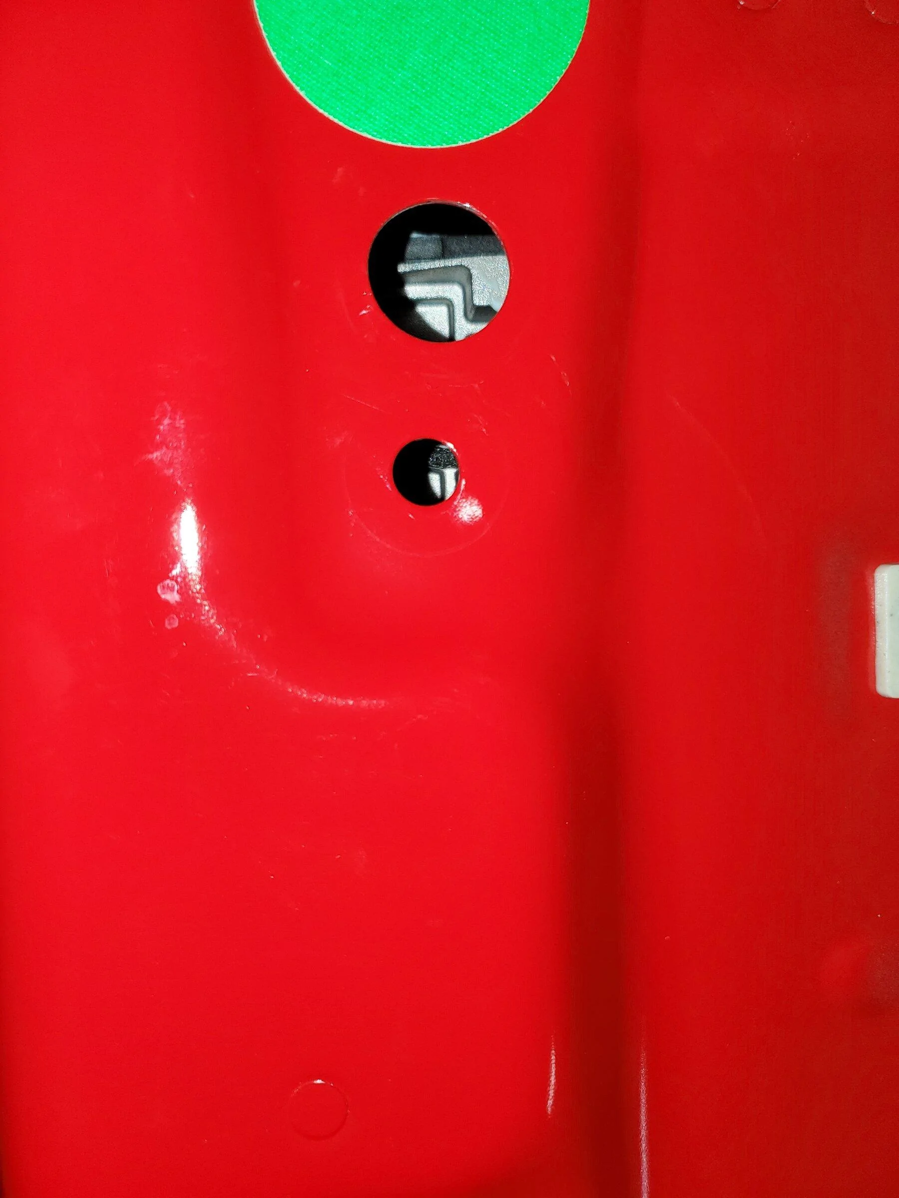

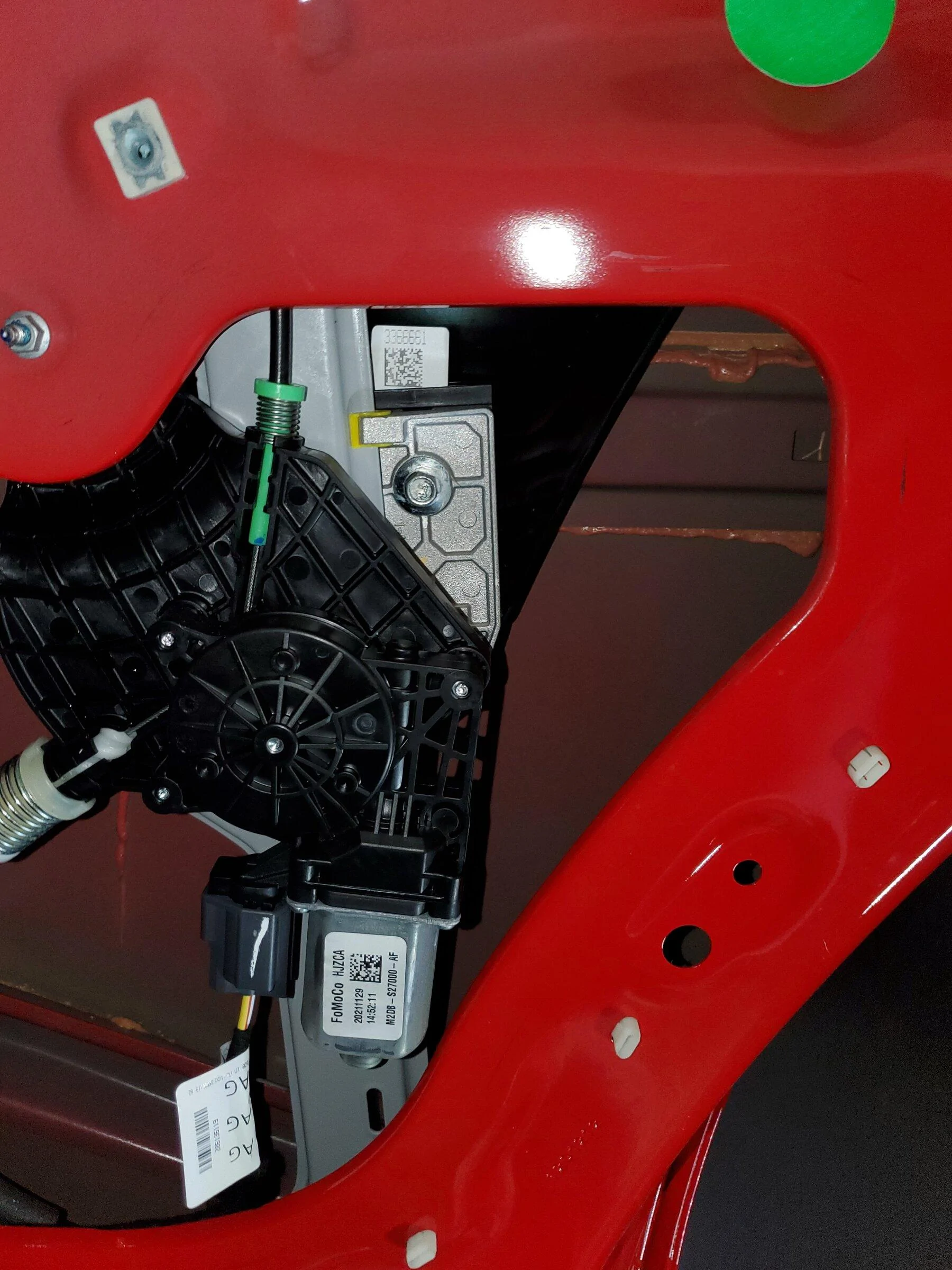

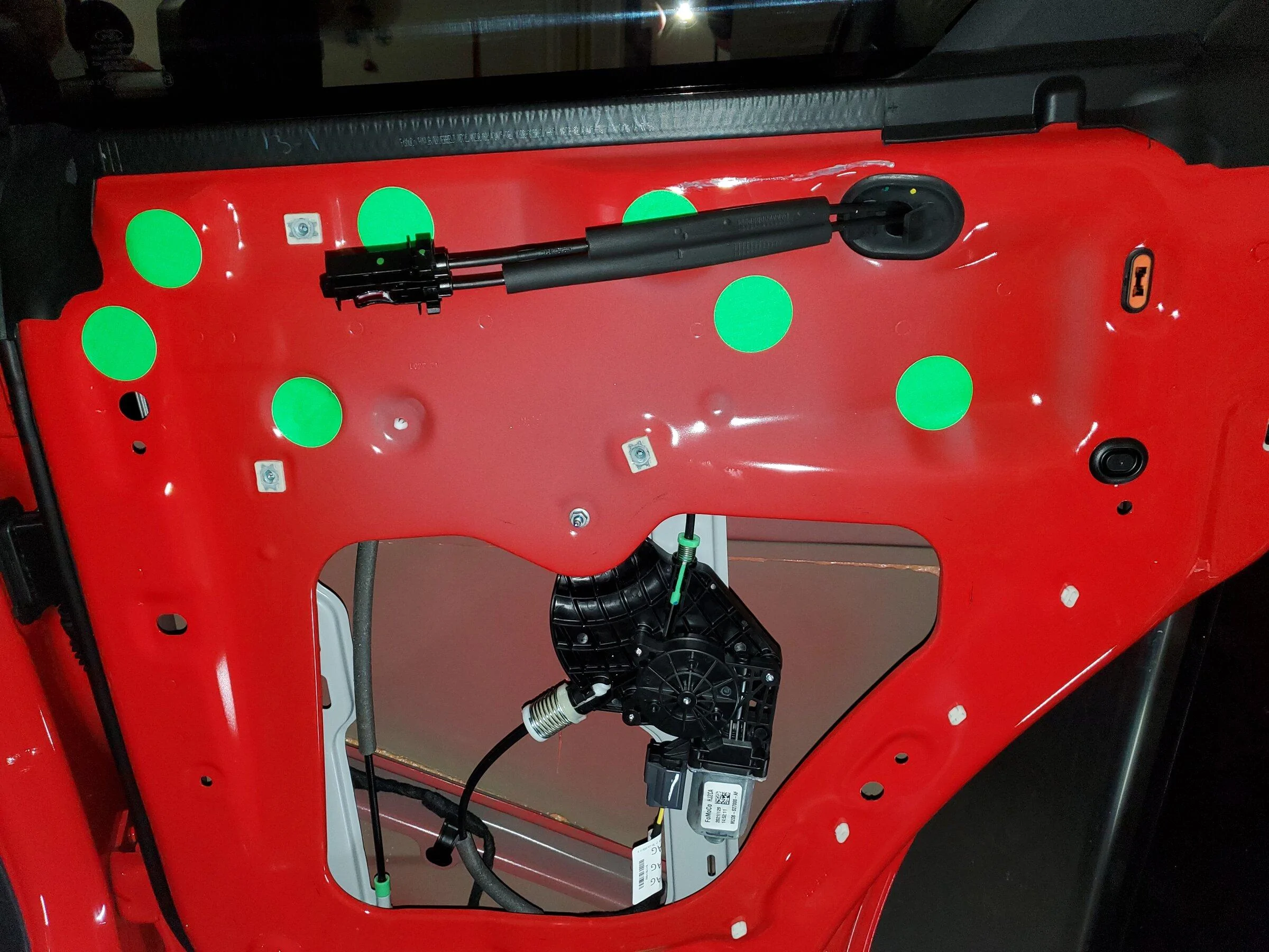

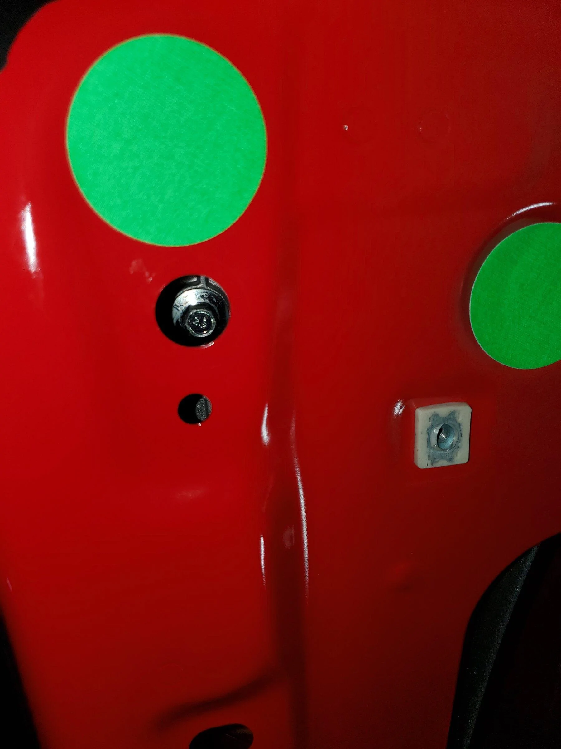

My window is fixed!!! No longer catching at all. It's sitting even now and flat the weather seal on the top and sides also.
The window is adjustable at the regulator itself. There are two bolts holding the glass in. There's half an inch of play on each one that goes up and down. Mine had to be lowered on the part of the glass towards the left, if you're looking at it from the outside. Once that was done the opposite side was raised a bit. It works great now.

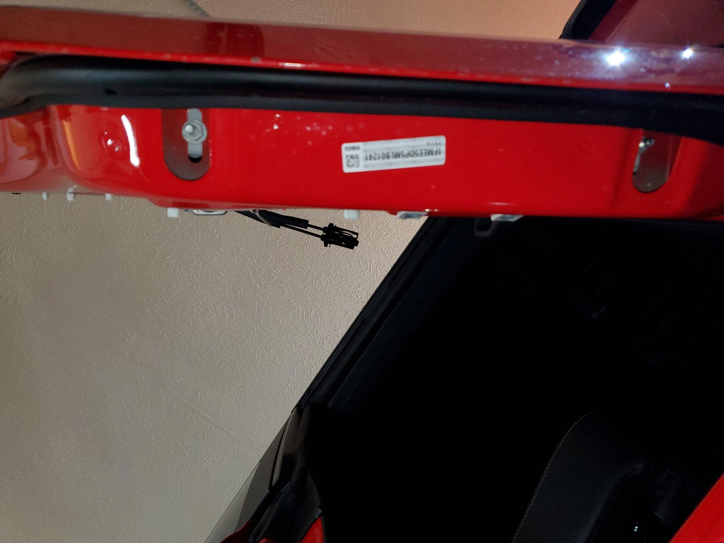

Also, if it is sitting in or out too much, under the door panel at the bottom of the door are two nuts that can be loosened and the bolts sticking through can be moved to adjust the entire regulator un and out.

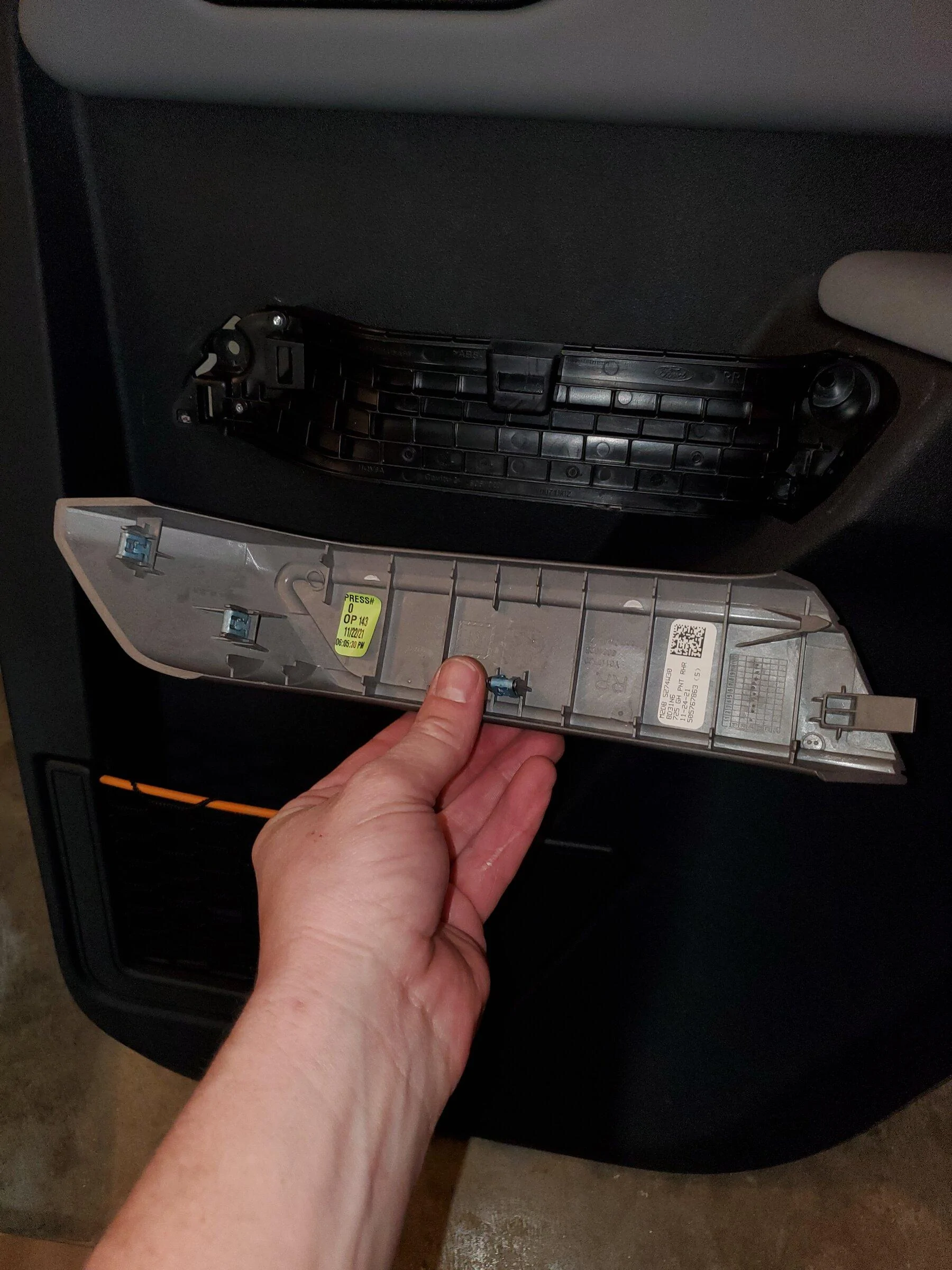

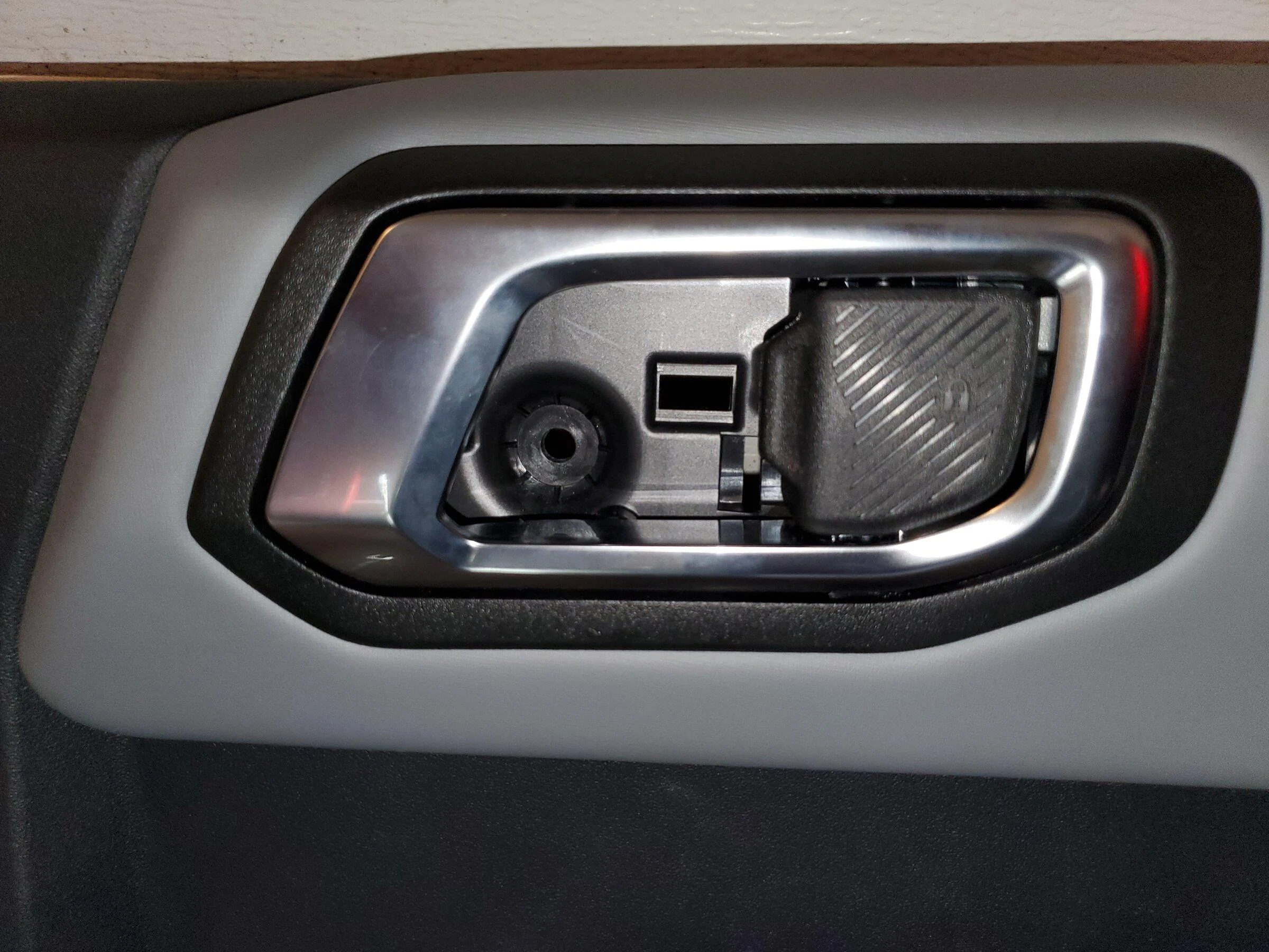

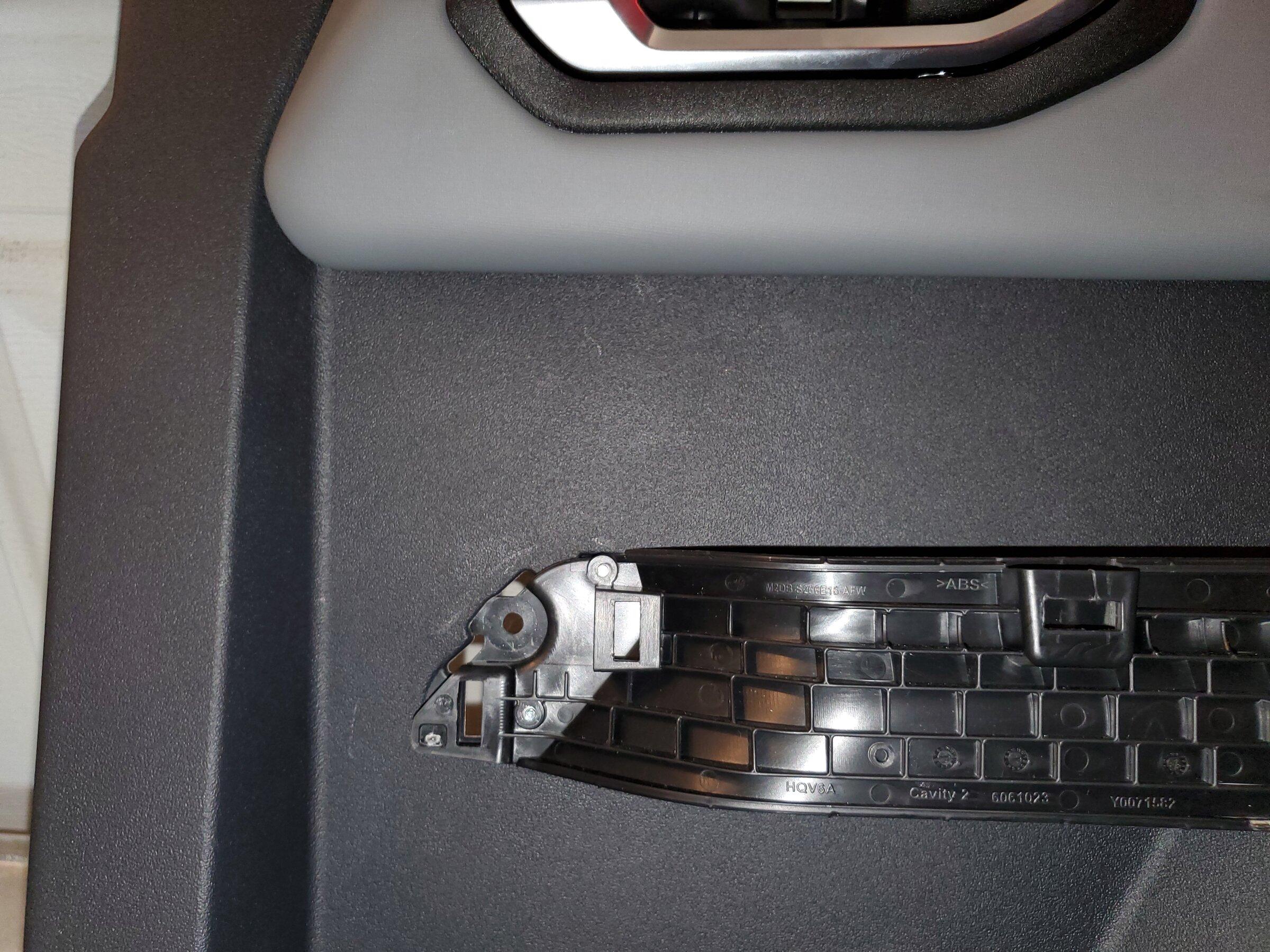

I didn't take a before and after of the glass itself but in my case the glass was sitting very slightly uneven and it was making the left-hand side grab the seal and shake violently when opened. I can't speak for everyone's vehicle but there's enough play in that window attachment that you can probably adjust it however you need to.
I've attached several shots of the door panel and door itself.

I did the same thing with mine. Same window and the same problem. Thank you for the pictures and showing this.
Better than letting the dealer do it.
