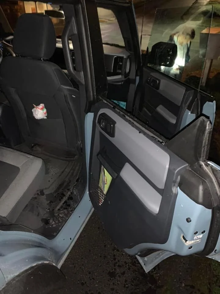

These windows are going to be in an issue. Already seen two broken ones, both rear passenger which happens to be the worst on my Bronco.
Sorry to see that happen to you. Our rear passenger side if the 1 of 4 that hangs just too long when opening that it catches. The other 3 work just fine. I have seen others mention the rear passenger one as being the problem child. Not sure why that would be a common issue...bad electrical design to that side of car that results in a voltage drop causing slow response on the window motor?????

The 2 door windows are more likely to break because of the large expanse of glass. The larger the frameless glass, the more unstable.

My 4 door is at the dealership right now because of the rear passenger hanging up. I get scared every time I open it.
