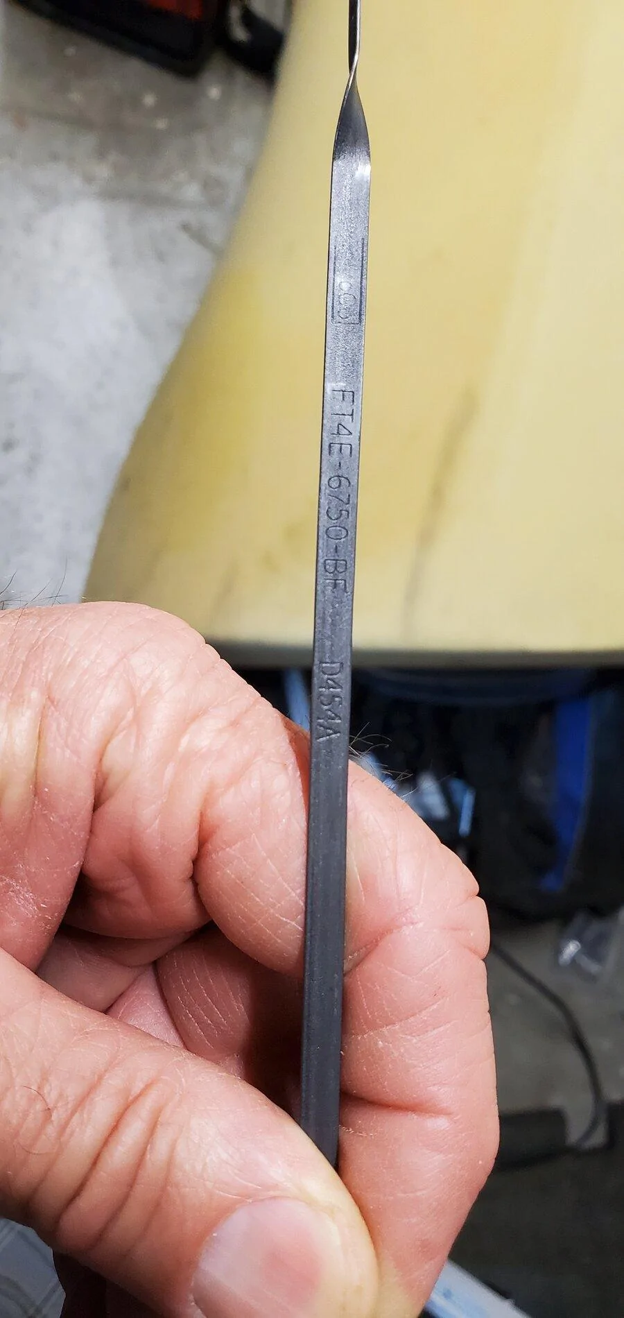

As requested, here's my brother's 2018 F150 2.7 dipstick part number.

Thanks so much! Different engineering number than the one in the Bronco. Is it possible to get a measurement from the top of the max mark to the base of the plastic handle (where it contacts the top of the dipstick tube)? With that info I can rule out yet another possible scenario. I can now get a PN for the Bronco and the F150 dipstick tube assembly and compare those to figure out if our overall height from the top of the dipstick tube to the block is the same...and that should give us an answer to the mystery of the correct oil level height.

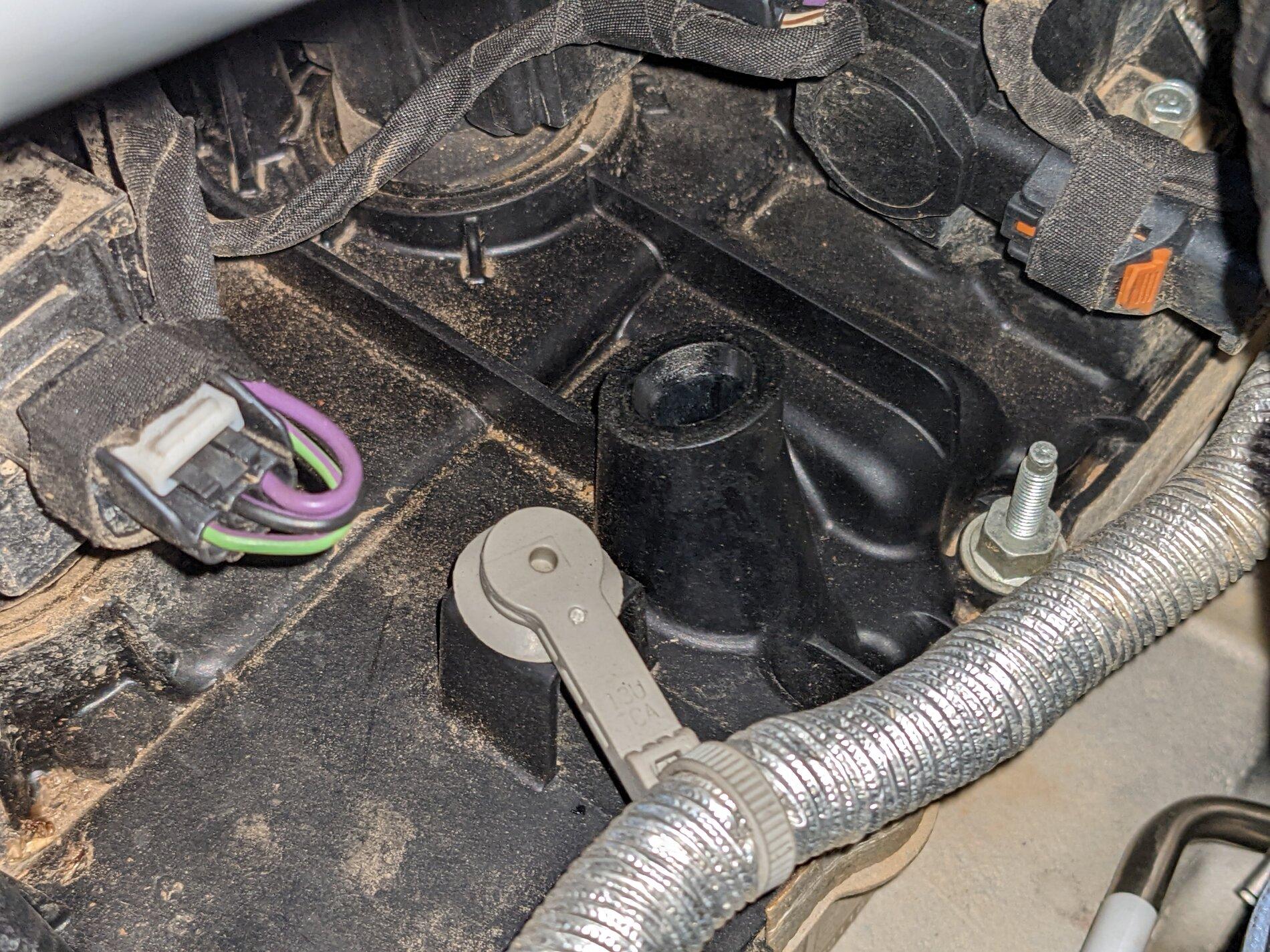

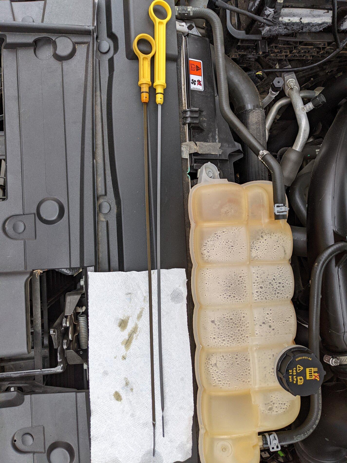

F150 is considerably longer but I didn't measure it since it's going to be hard to use as a reference as the "tube" is part of the valve cover.

Thanks again! It appears the only thing to reference the Bronco with is itself...sigh...I wonder if the 2021 changed things up?

Top is bronco oil pan, bottom F150. There are differences just looking at the pic but nothing to say differences in depth. F150 refill capacity is 6.0 so one could assume an extra quart would put it over in about the same place as the broncos. I don't have one (F150) in stock to compare and not sure if we even have a truck here that does.
My bet is the stick in the bronco is 1/2" too long and engineering just used the F150 length because of similar parts. They didn't take into account the bronco gets an extra quart.
