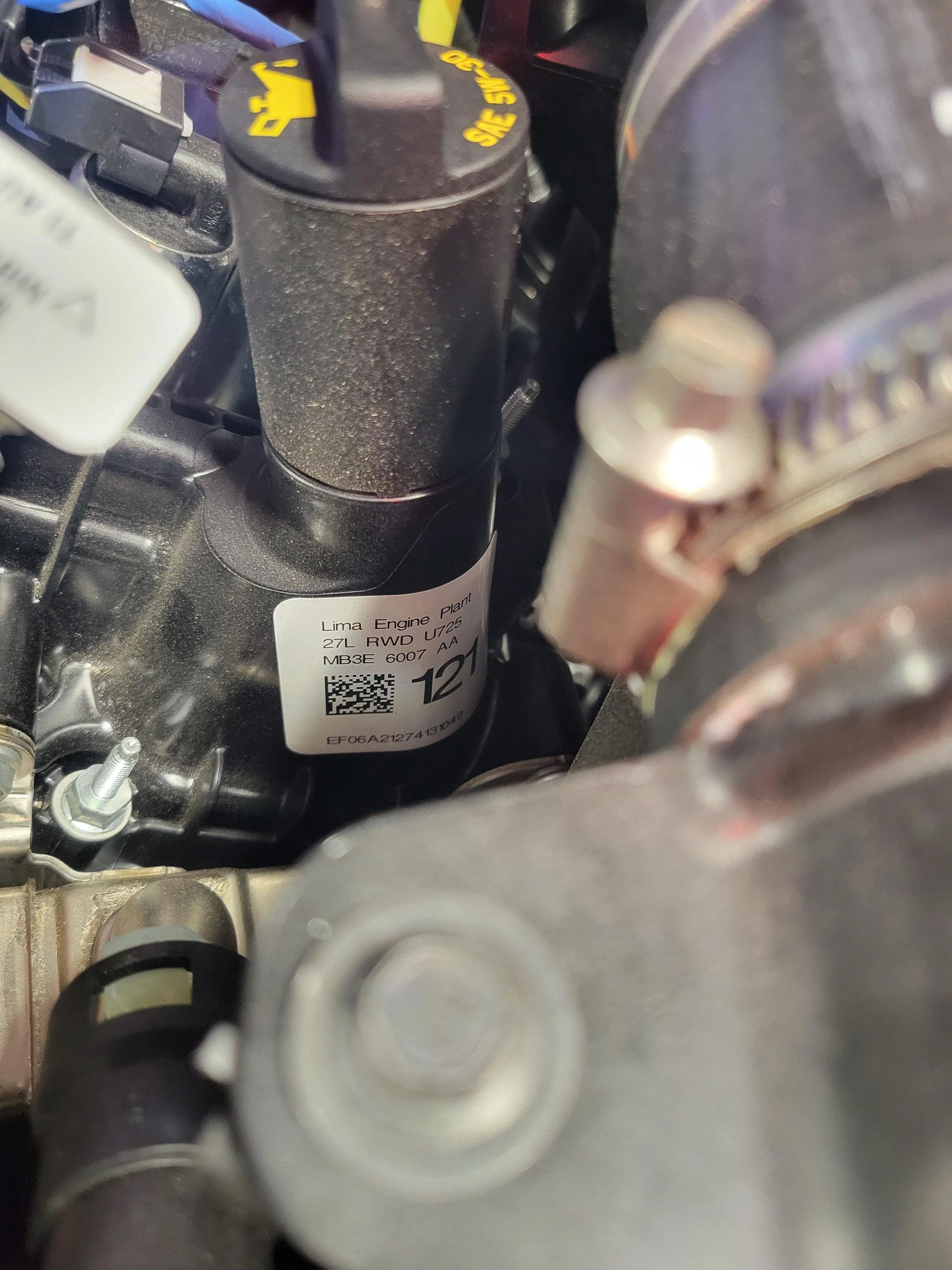

Do we have a current list of engine failures? I have a 2021 Bronco, engine 21274 with only 3500 miles on it. As you can see I don't hardly drive it as it is a 2nd vehicle. Does anyone know if engine 21274 in the "failure" zone? I plan on keeping this Bronco "forever" so I don't put many miles on it. Thank you!

. . engine 21274 with only 3500 miles on it. . . Does anyone know if engine 21274 in the "failure" zone? I plan on keeping this Bronco "forever" so I don't put many miles on it. Thank you!
see this post, and this post, and this post
the "Hot Zone" was 21159 thru 21228
we believe the new valves started with 21266
(Friday NHTSA reported "October 2021")
when Ford replaced blown engines, many of the early replacements had build dates 21273 & 21274
Bottom Line: Looks like you got a good one

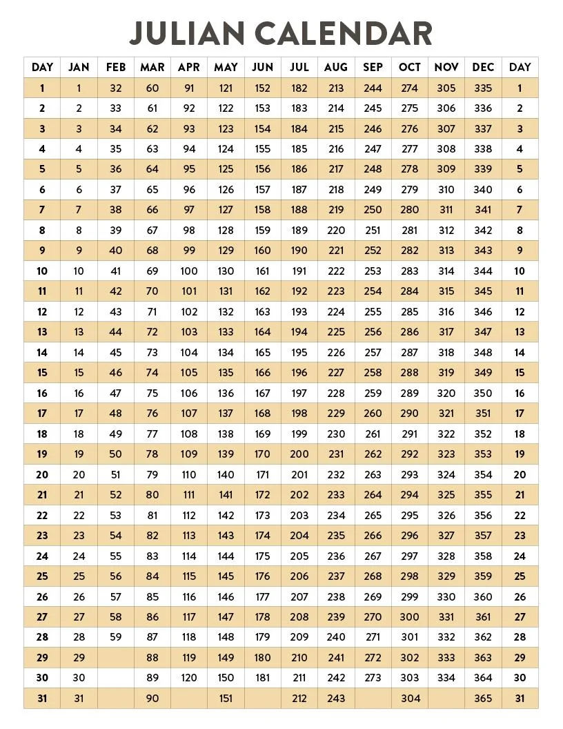

[M]any of the early replacements had build dates 21273 & 21274
Is that March 27, 2021 through April 27, 2021? Or, which dates? I don’t think many Broncos were built before mine at July 2, 2021.
Those 5-digit codes are the Julian build dates
e.g. 21273 --> Sept 30, 2021
Ford Bronco 2.7L blown engine failure list . . 68 so far [Updated: December 13, 2022] Julian Calendar
