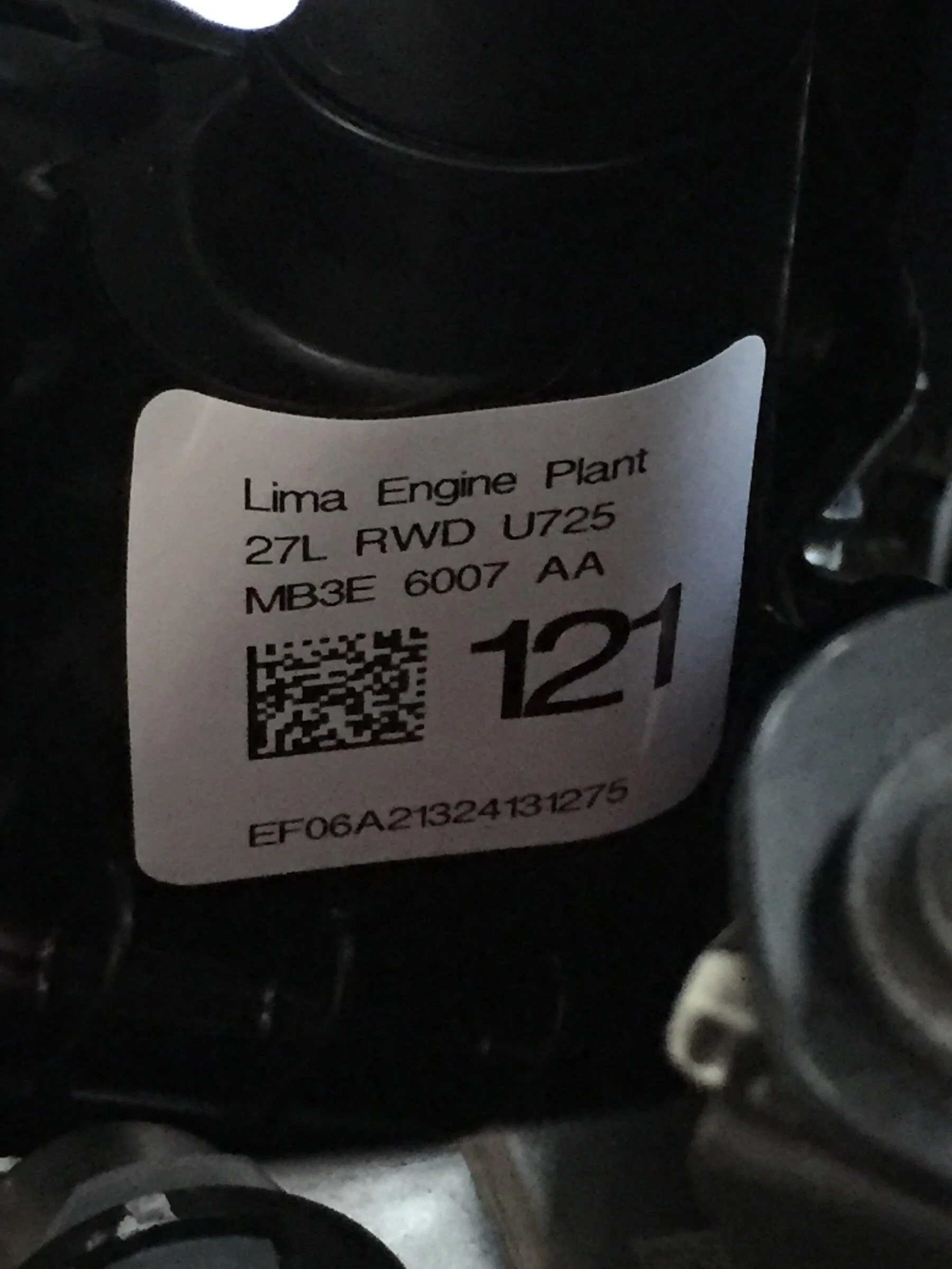

21324 in the middle of your label means the year is 20"21" and your engine was built on the "324"th day. Rather than do the math, just google 324th day of 2021 and you will get November 20th. Currently the known "Valve Droppers" ( courtesy of first Red Dawg, then North7, funny and sad) dates are not past August. Anytime you see an engine failure posted going forward, just put in the build date and you will know. If engines were being built today Saturday Jan 15th ,2022 the number would be 22015 .

Brian,
Regards,
George
