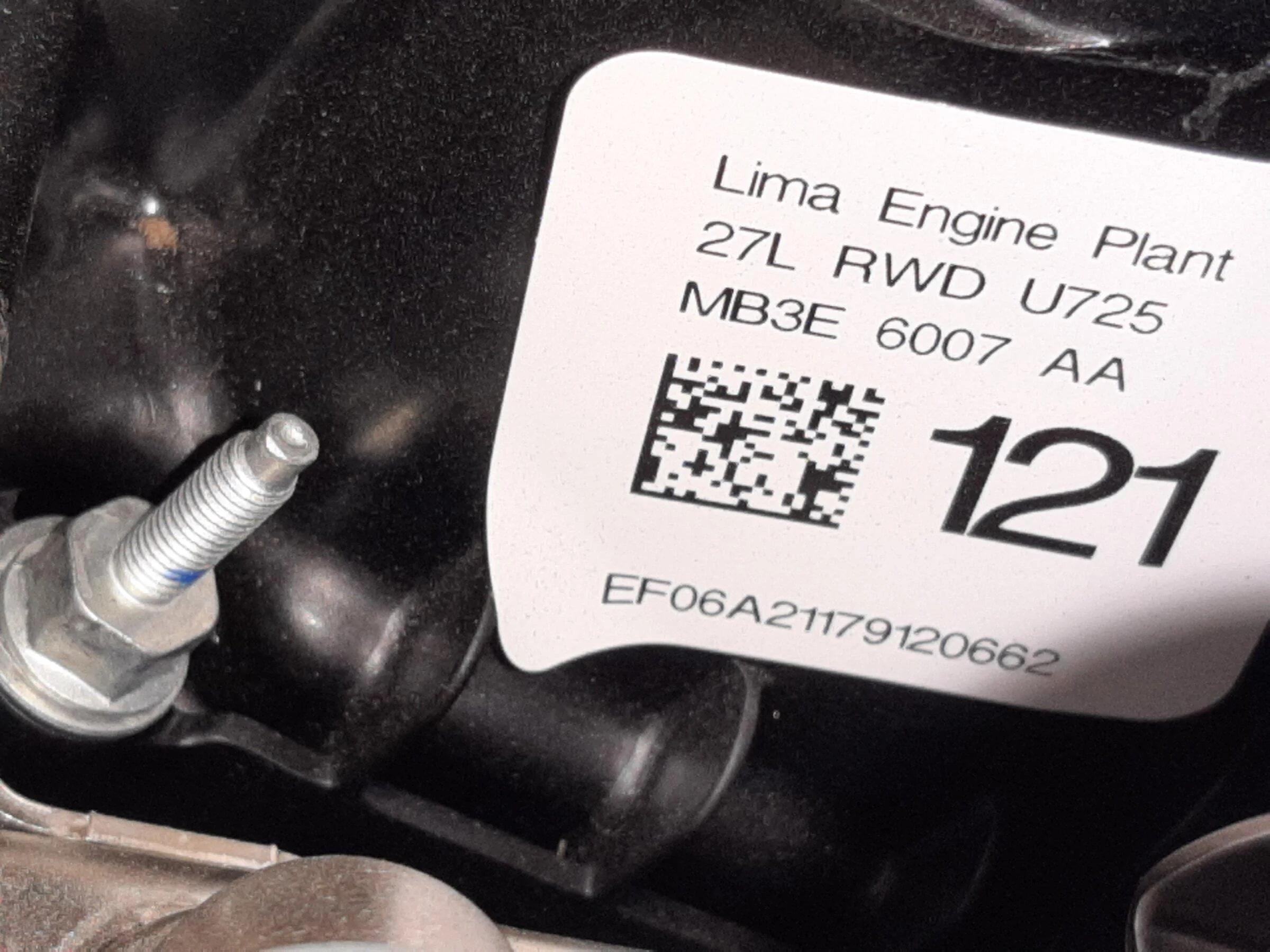

You should go pay it a visit in the showroom and get a pic of the build number/assembly date sticker on the engine.
Already did, mine is within the same time frame and engine #'s as the known bad engines already.

I've attached a picture of the sticker from my Bronco. Let me know if this is correct. Again, build date August 9. Also attached a picture of some other info mechanic gave me.
Ford Bronco 2.7L blown engine failure list . . 68 so far [Updated: December 13, 2022] 20220118_172154
Ford Bronco 2.7L blown engine failure list . . 68 so far [Updated: December 13, 2022] 20220118_180108
You’re at the end of the first batch of failures, or the beginning of the start of a gap between the next series of failures. 179 is your Julian date. 21179
Ford Bronco 2.7L blown engine failure list . . 68 so far [Updated: December 13, 2022] A0B7B322-6BA3-42E5-A6C8-DC76F5A1A44E
