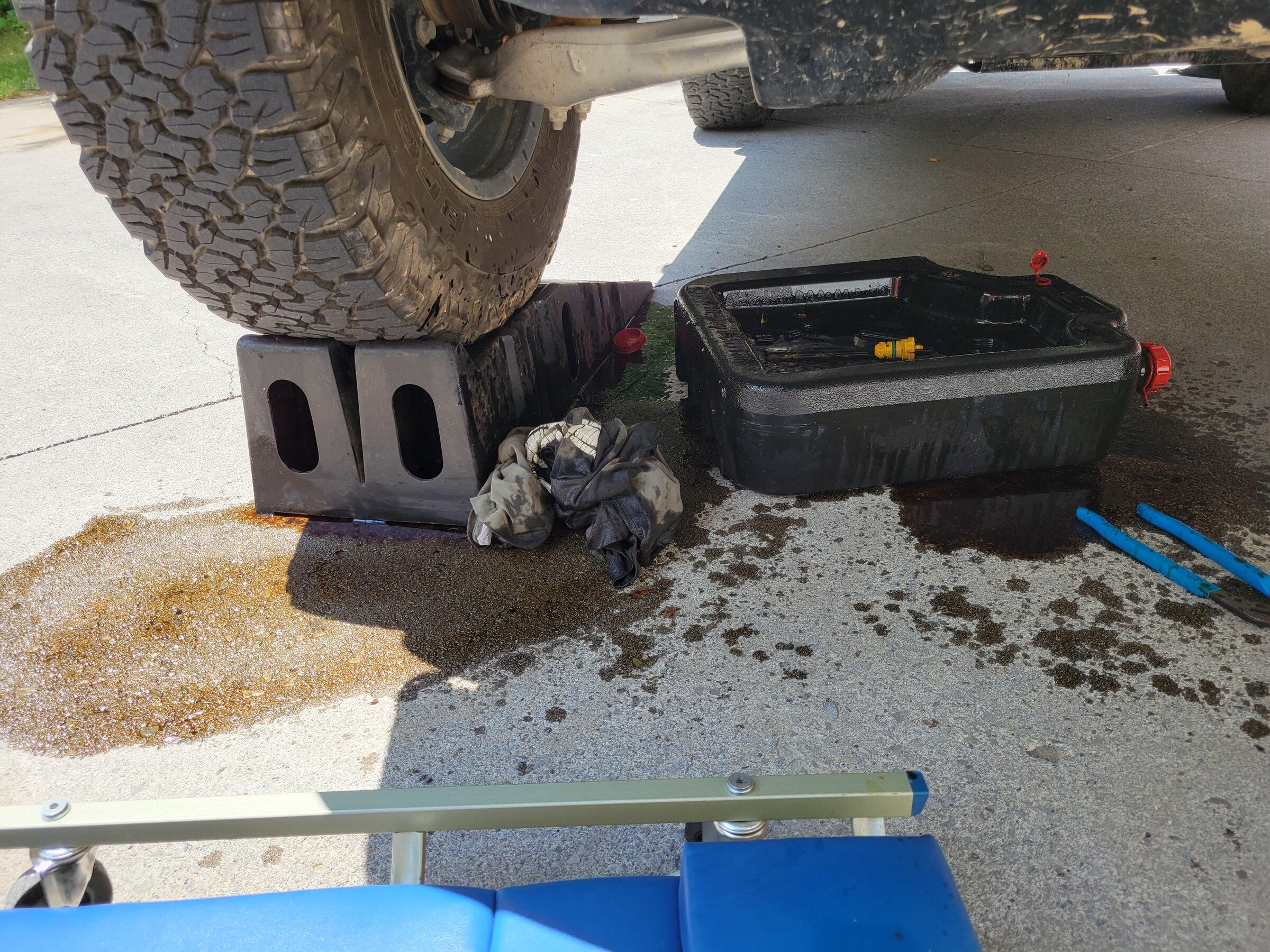

This was the scene after the factory plug pull.
its hard to tell from this picture but you need to raise the driver's side to get the most oil out on the 2.7L engine .... i dont know where the drain is on the 2.3L ... also use the plastic lift that you have on both drivers side wheels .... front AND back

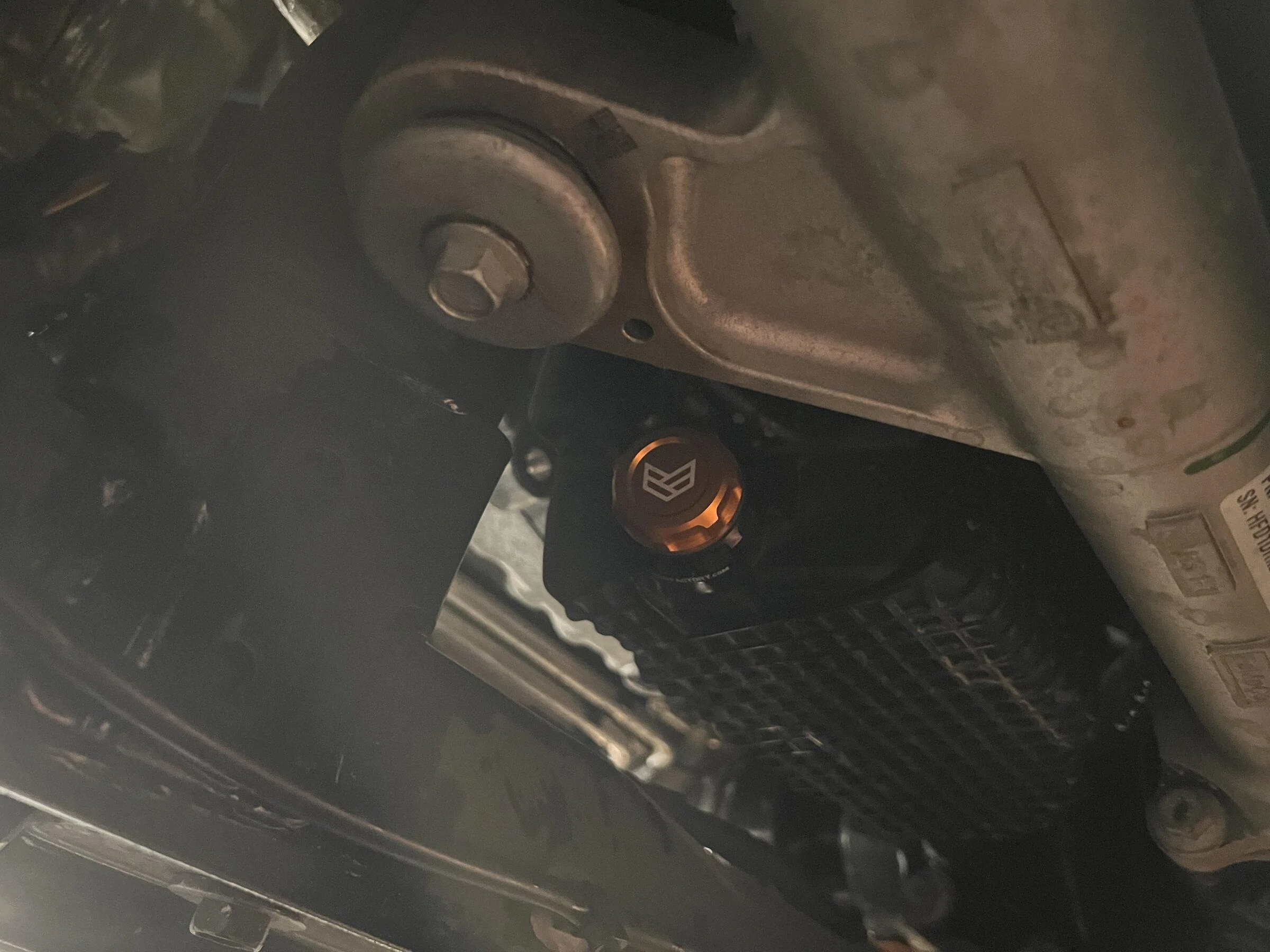

Well, I took the risk, ordered one, and here is what I find out.
Yes, it does fit. (No issues on the 2.7 whatsoever)
It has a magnetic tip. (should catch metal that is magnetic)
It's like the others in that it doesn't positively "lock" against the external tabs and relies on a spring washer for tension. I put 500 miles on it so far and no leakage, but I still want to safety wire it so that there is no chance of it rotating, because it "feels" too easy to rotate by hand. Other than that, it appears nicely made and has a nice little ball valve and a drain cap. That will make controlling the gush of fluid much easier, and as a result oil changes will also be easier to accomplish.
Overall 4/5, If it had been predrilled for safety wire, I would have scored 5/5. Works perfect and the price was not excessive.

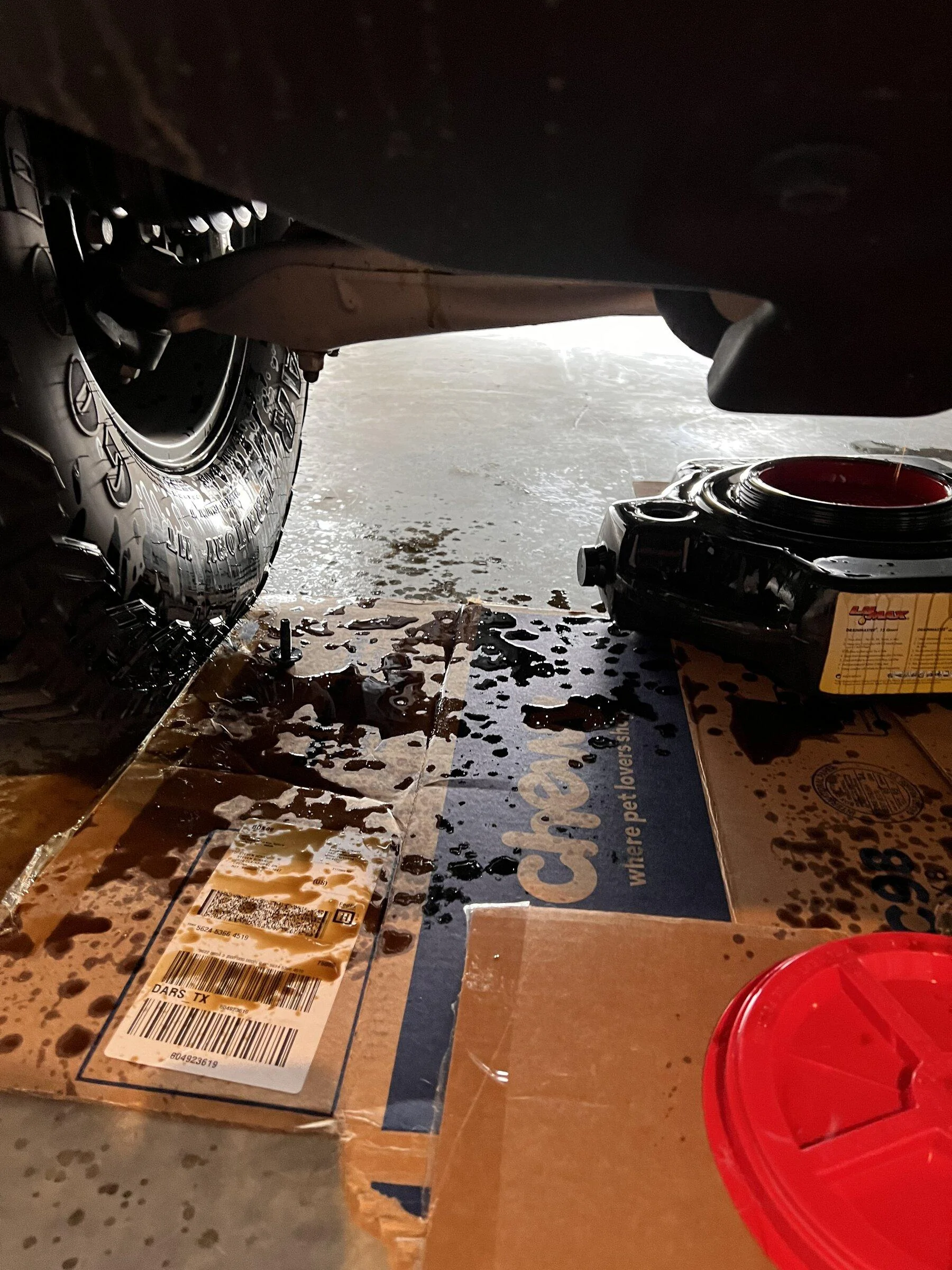

I just got dong doing my first oil change with my son. They were not lying about the oil coming out fast! We are talking like a fire hose fast šŸ˜³šŸ˜‚šŸ¤£. My son had the drain plug and I had the pan and we were ready and it didnā€™t even matter lol. Oil everywhere!
I put the Ronin plug in to make things easier and it went in just as prescribed. Very simple after watching this video on it.
