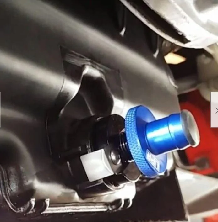

There was another one I saw that I liked better and it was about $55. I will see if I can find it again.
UPR Billet Easy Oil Drain Plug with Drain Valve - UPR Guaranteed - 100% LEAK FREE - Compatible with F150, Raptor, Mustang, Explorer ST
https://a.co/d/8QfFPW9
$55 on Amazon
Ford Bronco 2.7L Oil Change Tips + Replacement Drain Plugs Billet Oil Plug.JPG
https://www.ebay.com/itm/2940702719...MI7aCb7or49wIVKRitBh2Q3QFyEAQYAiABEgJAwPD_BwE
I liked the Billet one as my second chose.
The others require a separate part to screw into the plug.
I can see that part come up missing in my shop.

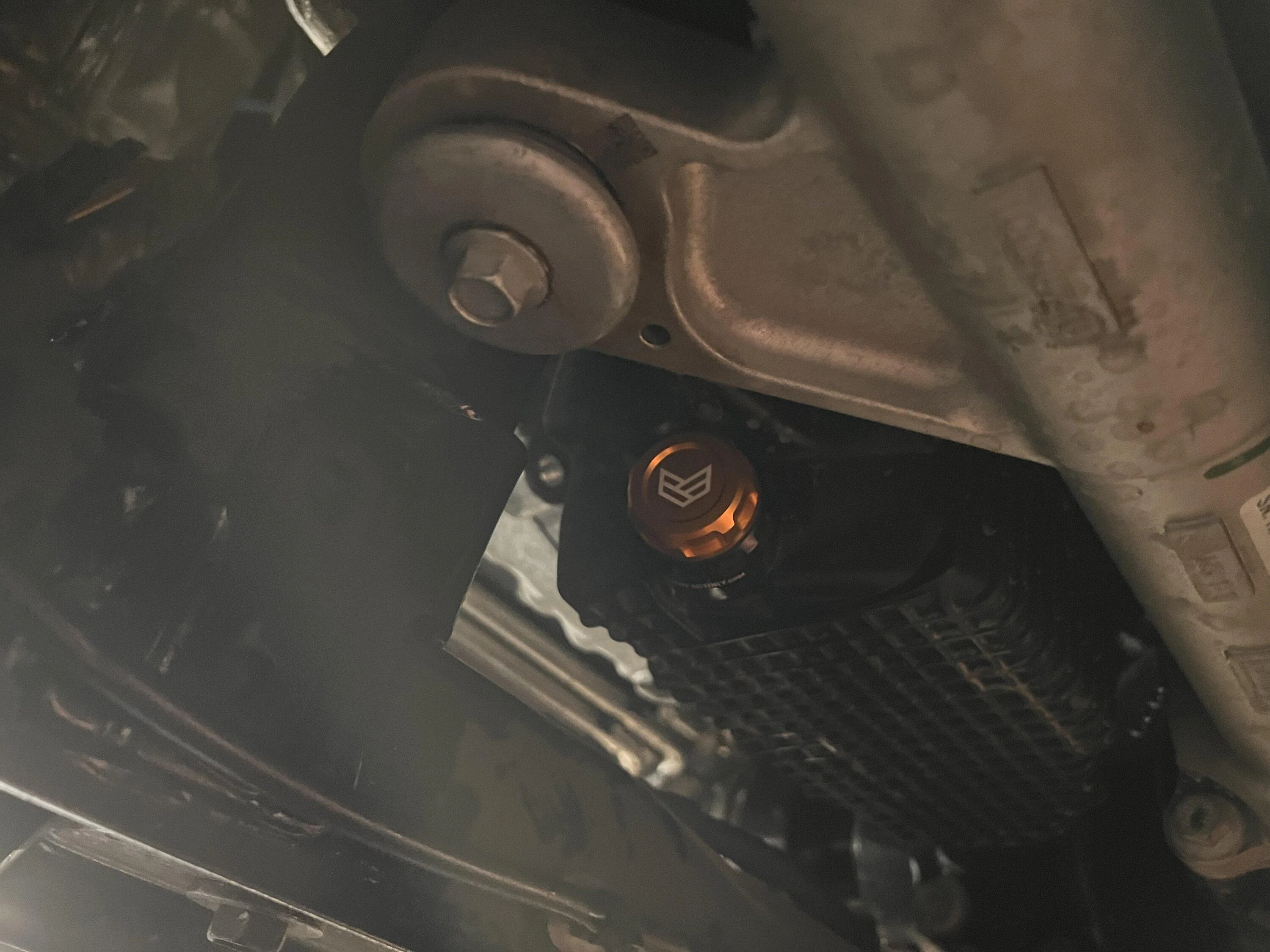

The Ronin plug is great.
Ford Bronco 2.7L Oil Change Tips + Replacement Drain Plugs 371B277F-5B87-4D61-A1C9-BC3DE7378038

Update to the dipstick thing. My Badlands w/2.7L was built early July and still has the same dipstick w/PN# FT4E-6750-BF that from factory shows oil to the twist after several days sitting in the garage.
Some posts on the Ronin plug indicates the way the plug projects into the pan will leave up to 12 oz in the pan which I think accounts for their recommendation to tilt the rig.
As for the 15 minute wait to check a hot engine oil level I assumed was to let the oil settle in the dipstick chamber through the check valve - will do this procedure after I run it next to see what the level is then and update.
The new player in the replacement plug game from UPR seems to be a great option since it looks and functions much the same as the OEM for install and locking as an OEM, double O ring but with drain control we all want to prevent messes where a 1/2" hose can be used as well; also has a magnet on the tip. It can even be removed like the OEM to get that last bit out. Not as pricey as well.
https://www.amazon.com/dp/B081D6RB2V/ref=cm_sw_r_apa_i_NSD9T3M2XDZMWPA2WRBH_0
I like this design better than the Femco that I was contemplating on getting. https://www.femco.com/product/ford-...mLS5Tz1gIBdJBnaOyq-Usy6H74WTB__kaAgmoEALw_wcB

Went to the UPR website and found it for a little less there than the Amazon offer. Am using ValvoMax on my other rigs, however, they don't have one for this yellow plug in the plastic oil pan set up; though their website does show one... am in discussion about that with them. The convenience of guiding the drain with a hose and having the ability to start/stop it at will is great - much less mess potential in my garage! On my 21 Ranger, I no longer have to remove the skid plate, just the right front tire for the filter change.
