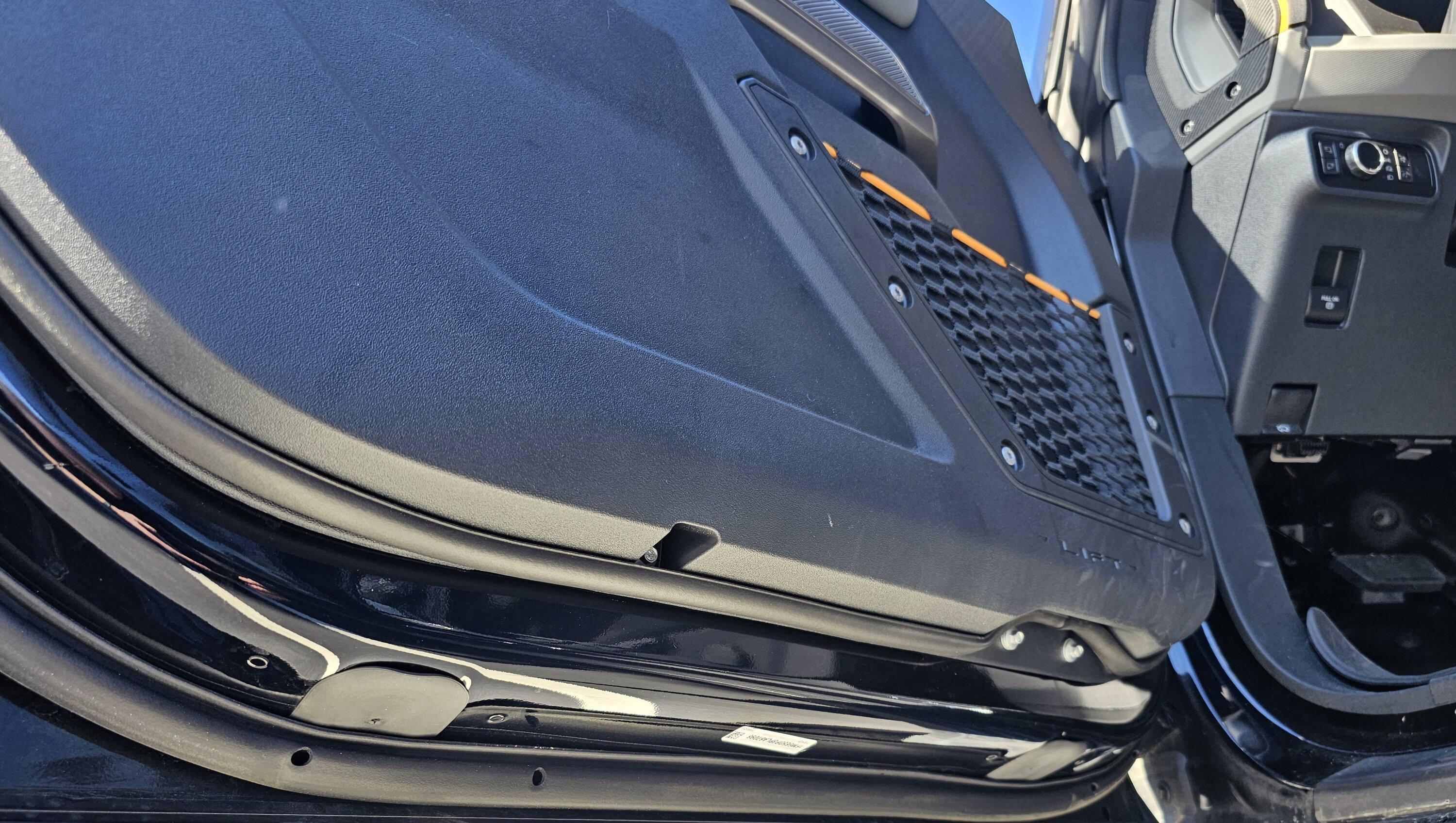

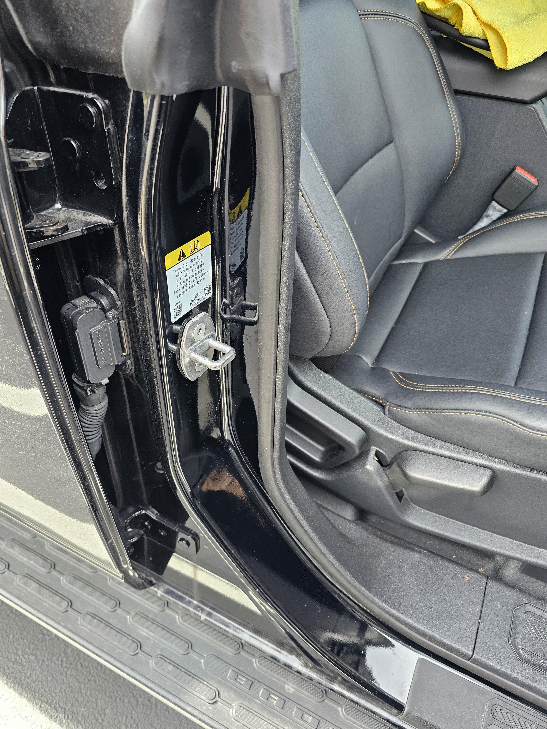

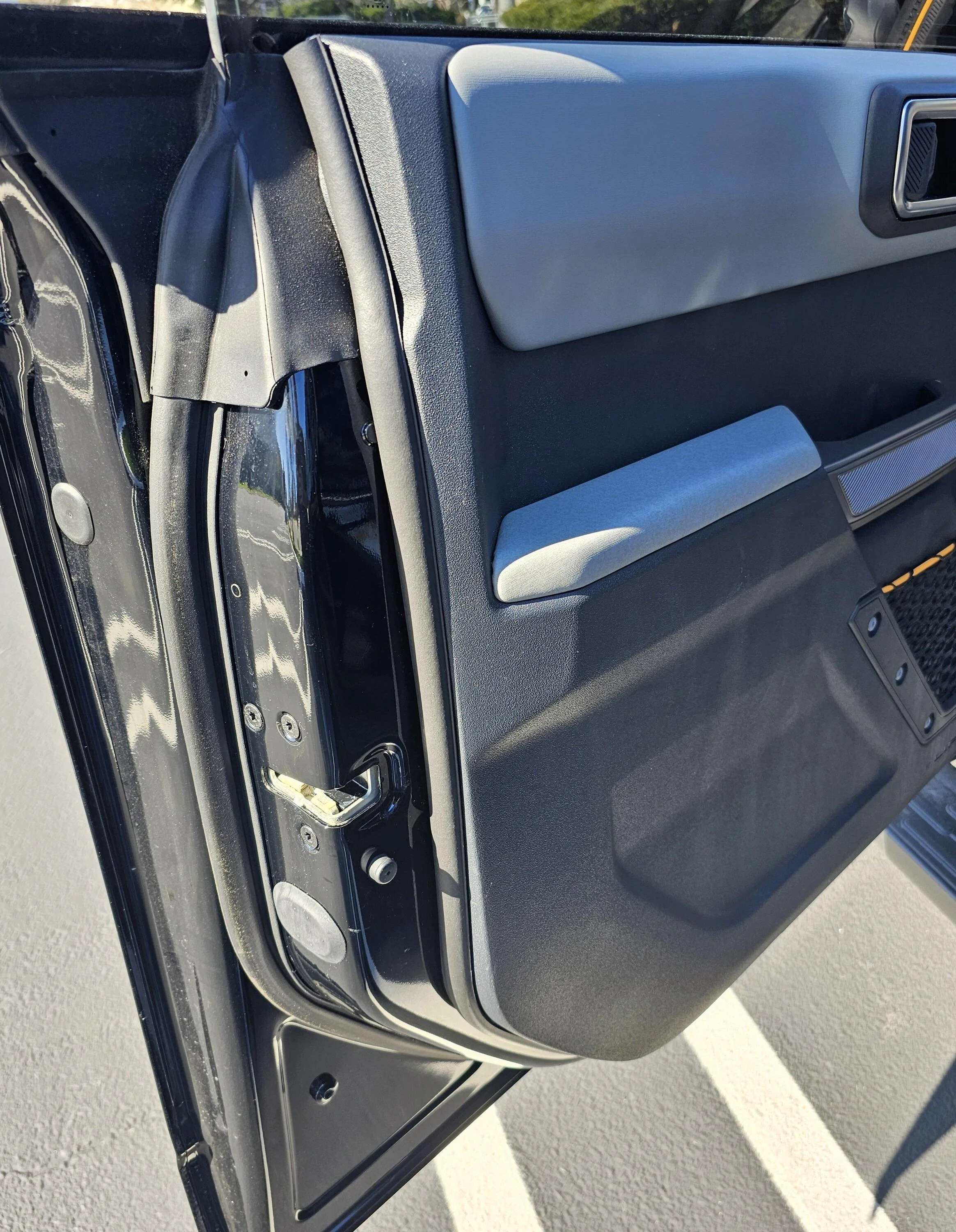

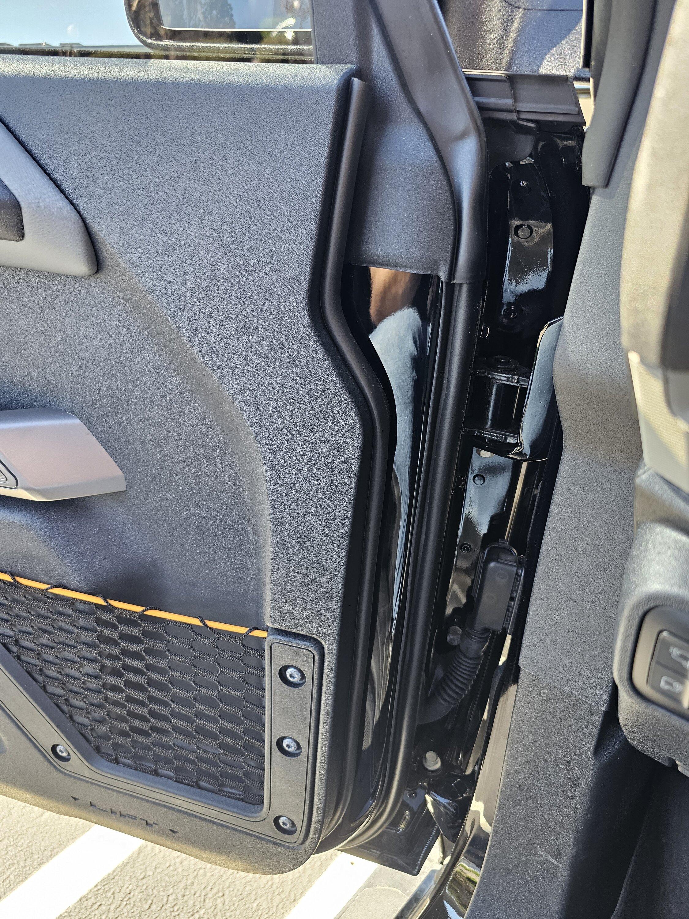

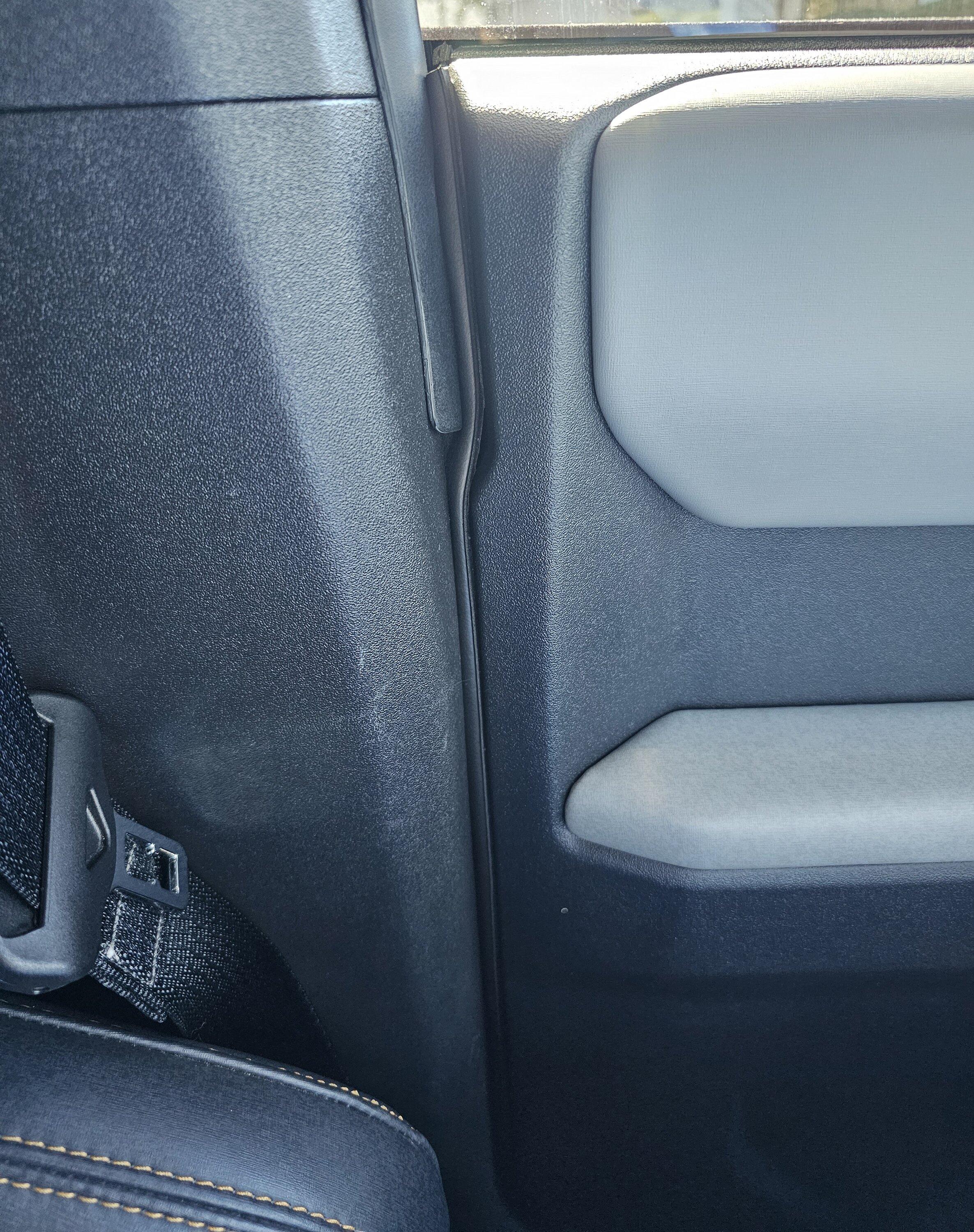

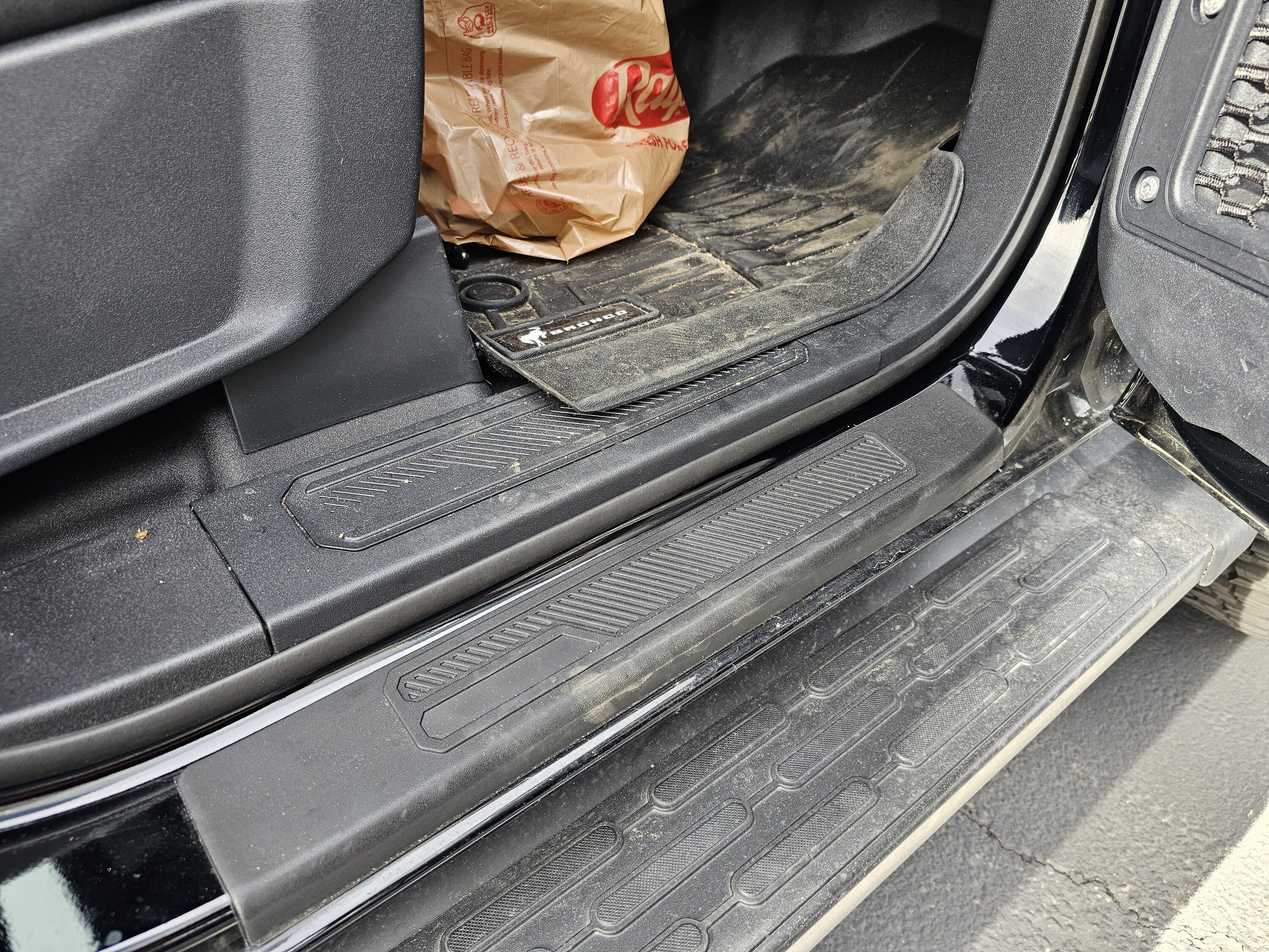

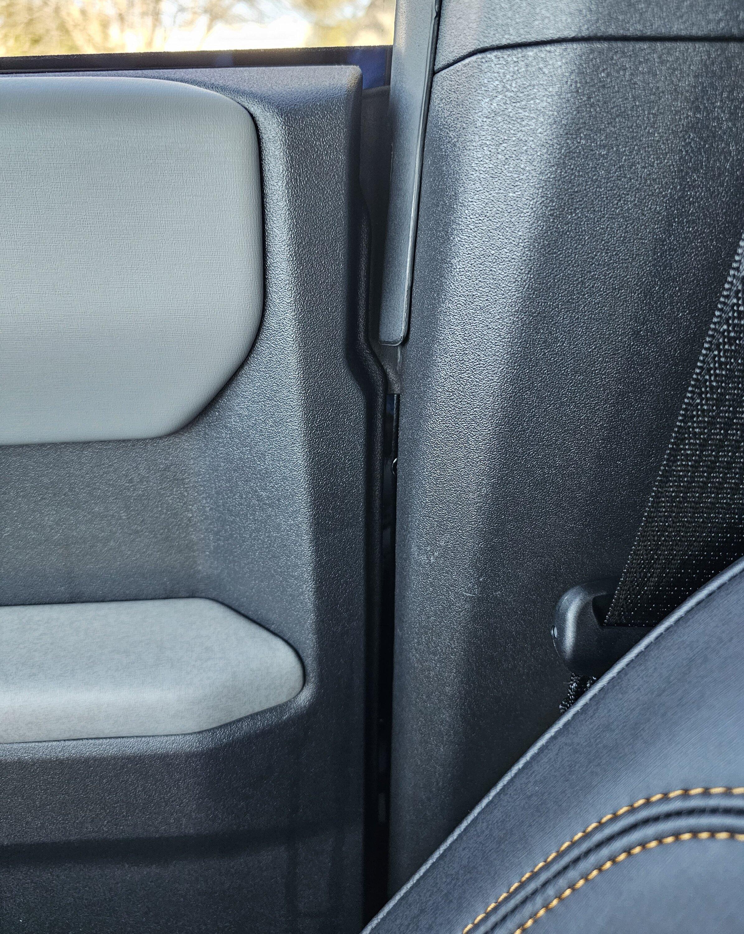

I followed this MIC wind noise reduction guide a while back and, although it greatly reduced the noise from the top, it also left me noticing the road/exterior noise a bit more now.
It seems quite a bit of noise leaks through the doors and windows. Don't think I can do much about the windows, but I used some of the leftover weatherstripping (93085K525 from McMaster) to add another layer to the door.
It's fairly thin and flexible so the door still closes normally, and it also blends in pretty well so it's hard to notice. I'll be taking it out on a drive later and seeing if the difference is noticeable.
Has anyone else tried or had any luck with adding weatherstripping to reduce road noise? Curious to see what other experiences with this may be.

Update (for @adamruiz2001)
Went on a quick drive (just streets no freeway) and it feels like I wasn't hearing the cars beside me as much as I usually do, especially the ones passing on the other side of the road. I might try ordering more and finishing up the rest of the doors as I only have it installed in my driver's door right now.
Tire noise didn't seem to change too much, but it could be because it's mainly coming from the footwell area.
I'll take it out on the freeway soon and post another update.

Do you feel like it makes the doors more difficult to close? I already have an odd issue with mine, where I frequently need to two 2-3 times, especially on the passenger side. However, I need to work my sound deadening and this looks like a good idea.
WheresMyBronco
WheresMyBronco
Sep 27, 2021
474
645
Los Angeles
2023 Badlands
I only installed this on my driver's door so far and it didn't seem to make closing the door any more difficult. I have the same issue as you with my passenger door though so I'll let you know if it makes things worse when I install some there

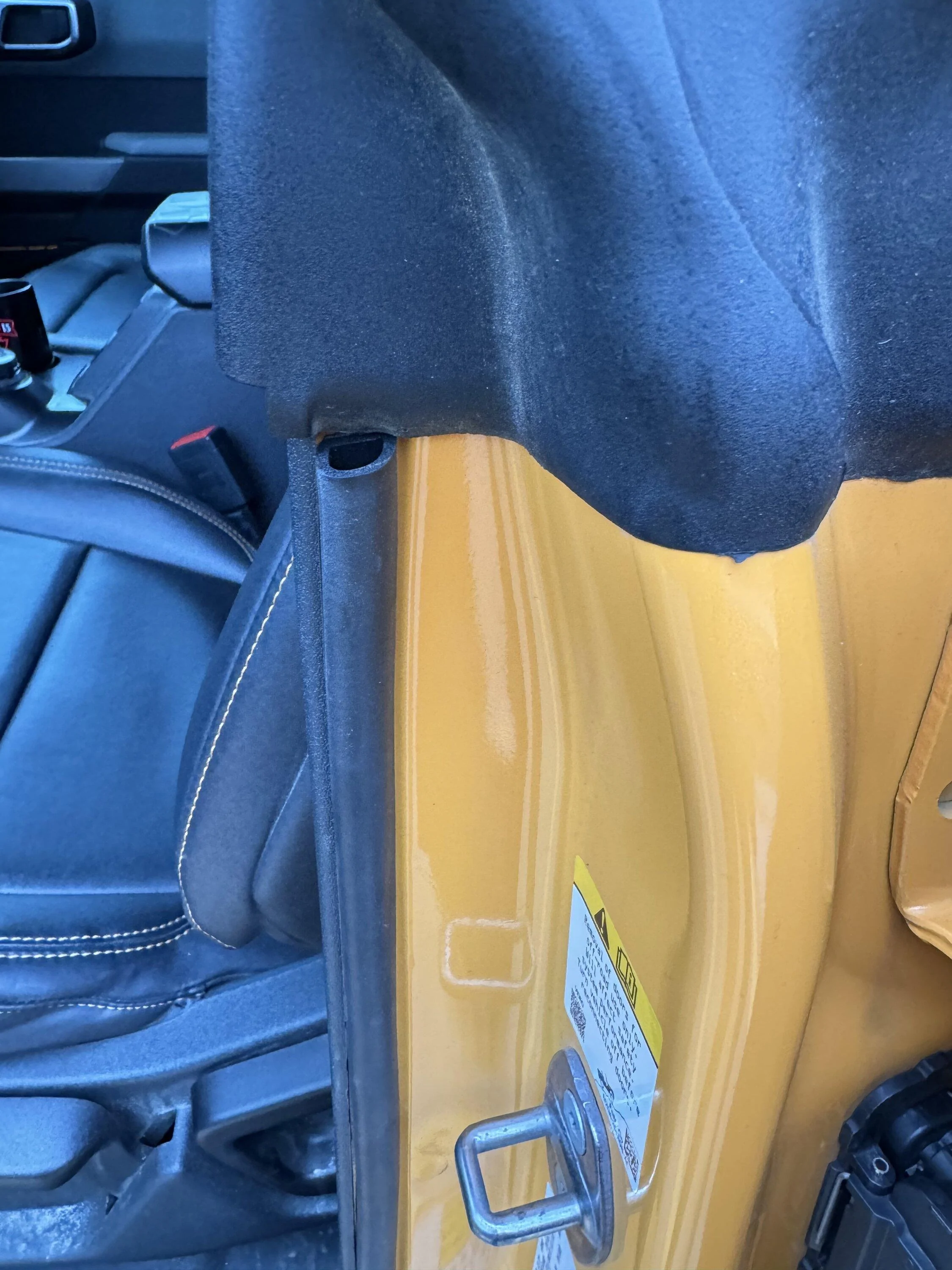

I put mine on the body channels
huge impact on noise
Ford Bronco Adding More Weatherstripping - Tackling Road Noise IMG_4333
Oh nice, this is a good one. I'll probably do my other doors like this since I only have thicker weatherstripping left.

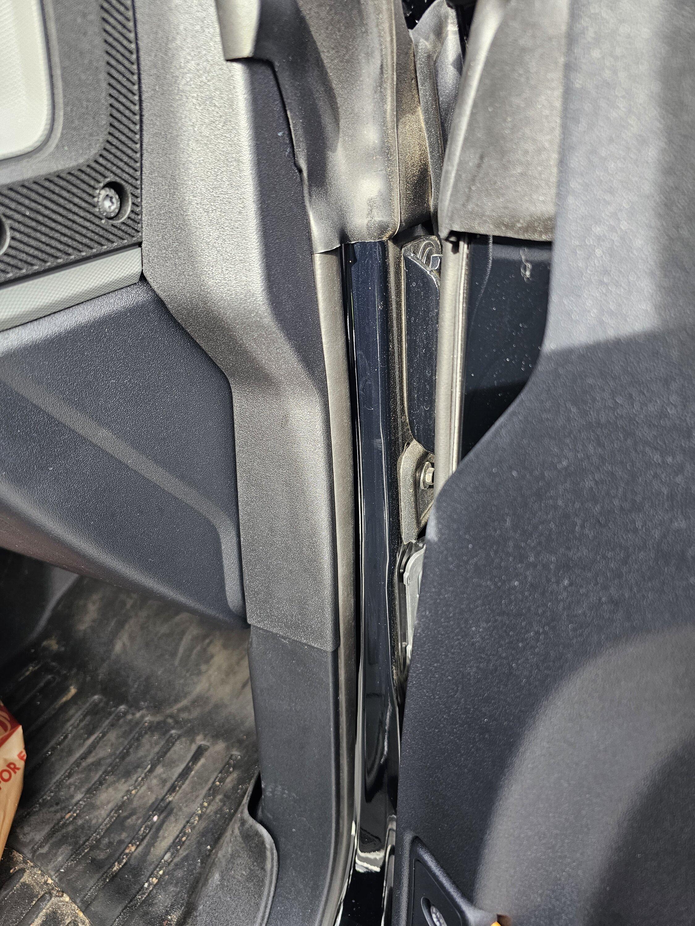

Installed weatherstripping on the body channels like @Easy-v, but I also tucked it under the rubber flaps/panels so that it blends in a little better. Going to finish the rest of the doors and take it on another ride later
It doesn't seem to make the door closing any worse like this either @userdude.
Sorry for the terrible pics
