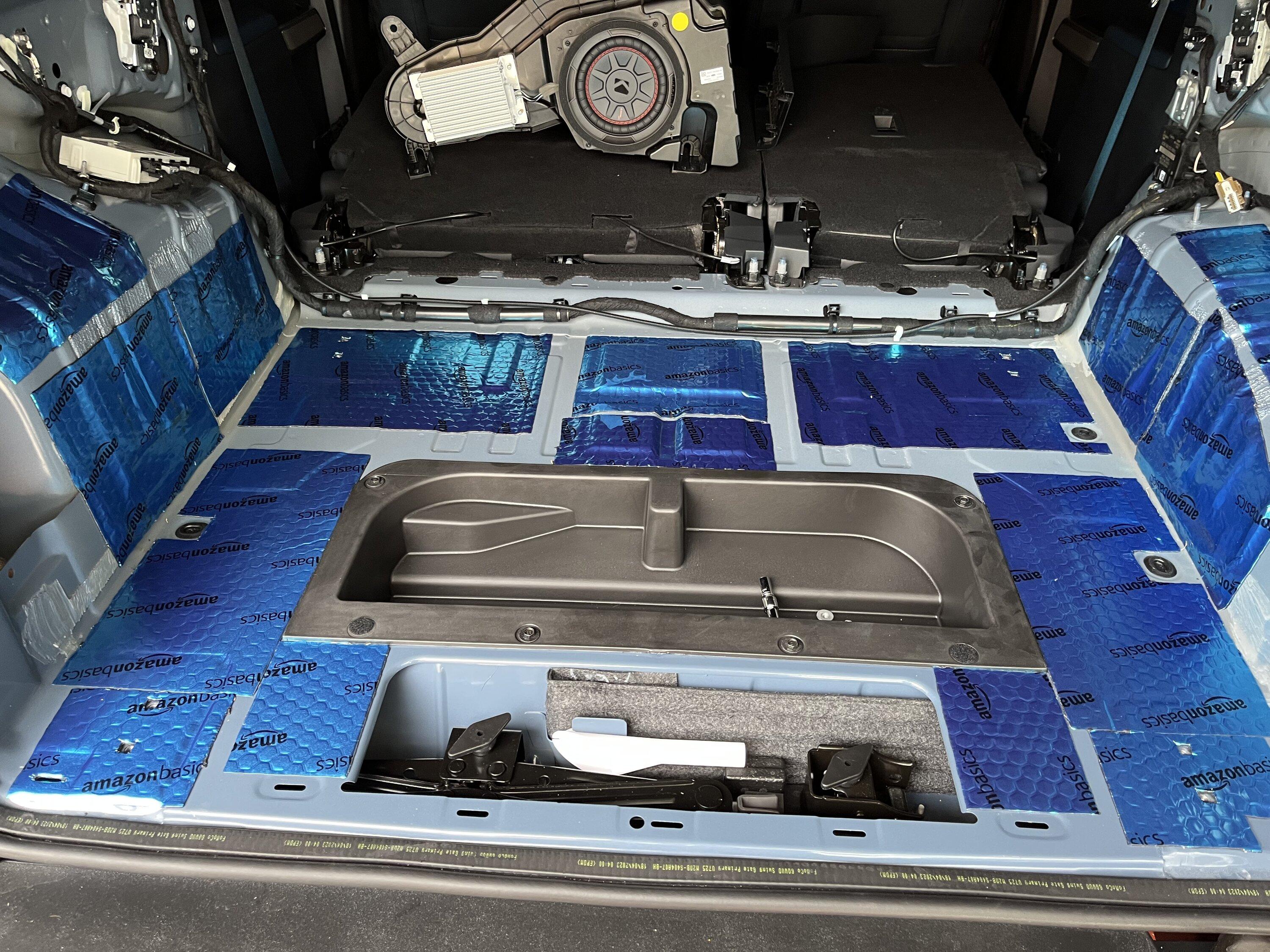

I bought 100ml Kilmat on Amazon. Measured out the cargo area. cut for the grommets and tie downs. Whole thing took less than 2 hours. Went for a test drive. Definitely an improvemnt with respect to tire noise. Those 35's scream over 65mph. Thanks to everyone for pushing me to Killmat...cost...$65...not $300!
Question...should I put rubber into the "cooler"...which I will never use as a cooler. I can cut for the drain.
Ford Bronco MIC Noise Reduction Guide - wind sound- aka more (or less) cowbell please PXL_20230927_003959437

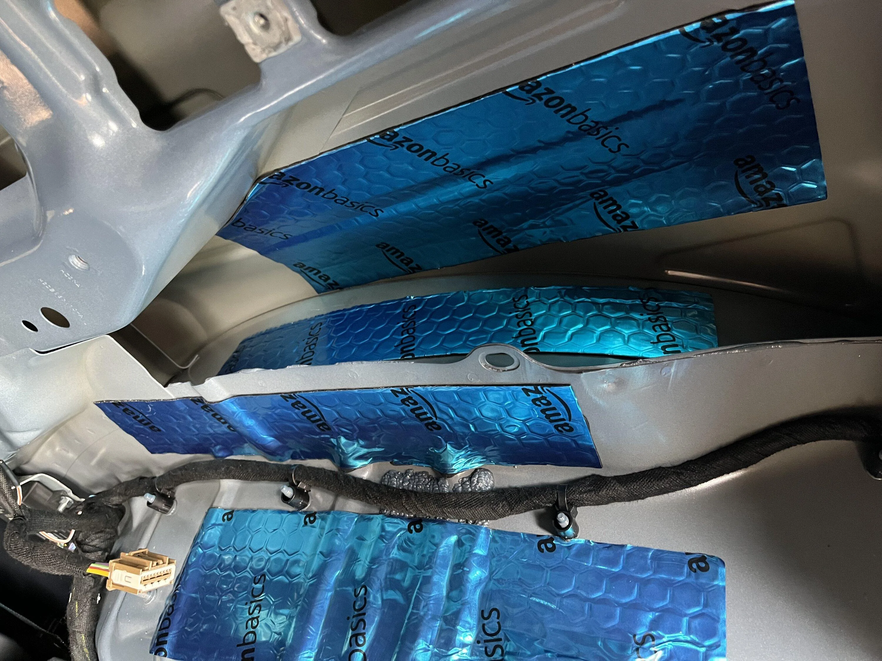

I did a similar project while I had panels out to install a sub. I went cheap with Amazon brand, though (still butyl rubber). Only $30 in materials. I did not test sound levels before and after. Easy install, and seems to help some.
Ford Bronco MIC Noise Reduction Guide - wind sound- aka more (or less) cowbell please IMG_2141
Ford Bronco MIC Noise Reduction Guide - wind sound- aka more (or less) cowbell please IMG_2144

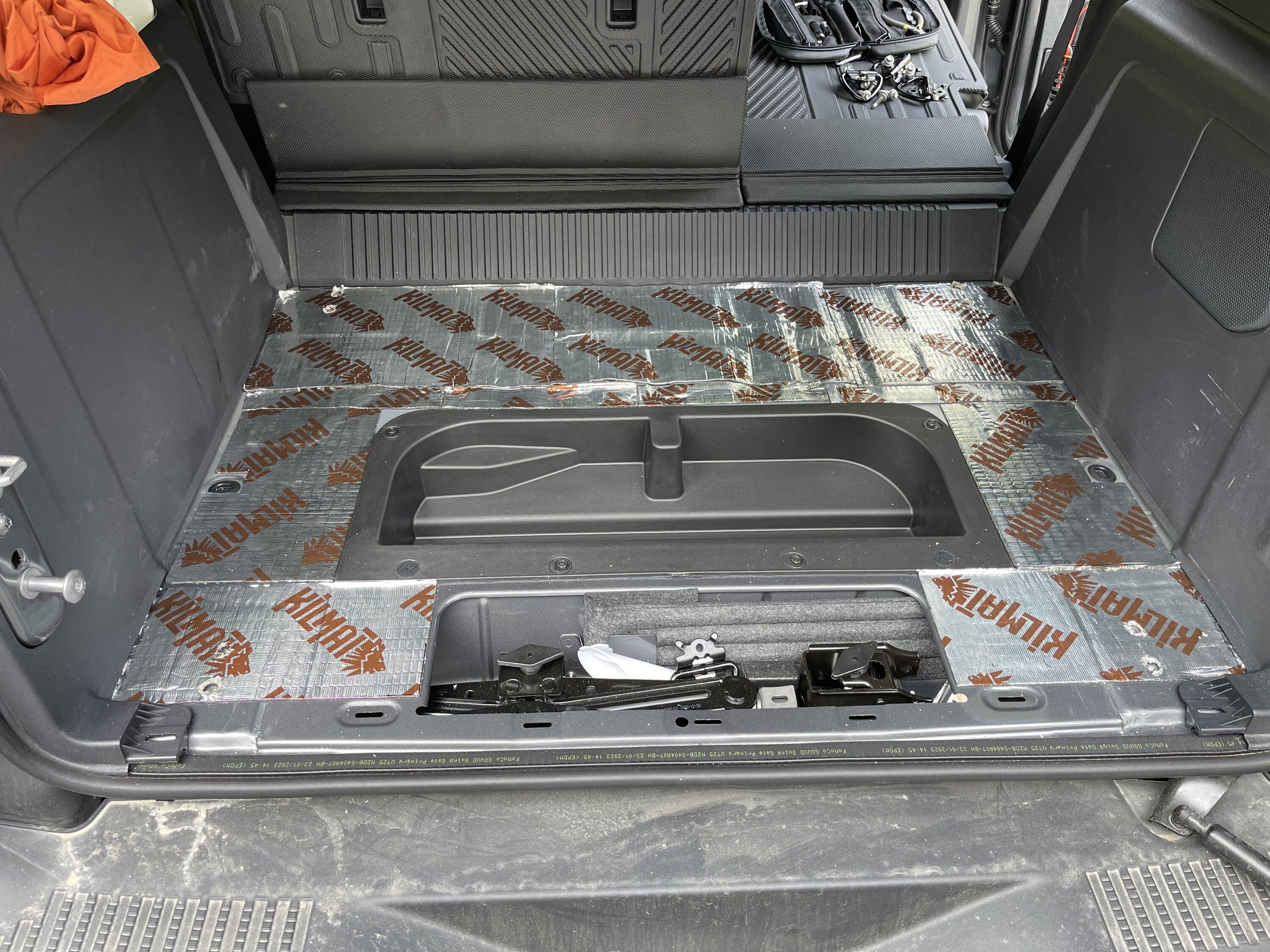

I’ve spent a lot of time tying to make my cabin quieter. I haven’t had a lot of success with the hard top, but I eliminated a lot of road noise with Kill-mat type sound deadener under the whole washout floor.
