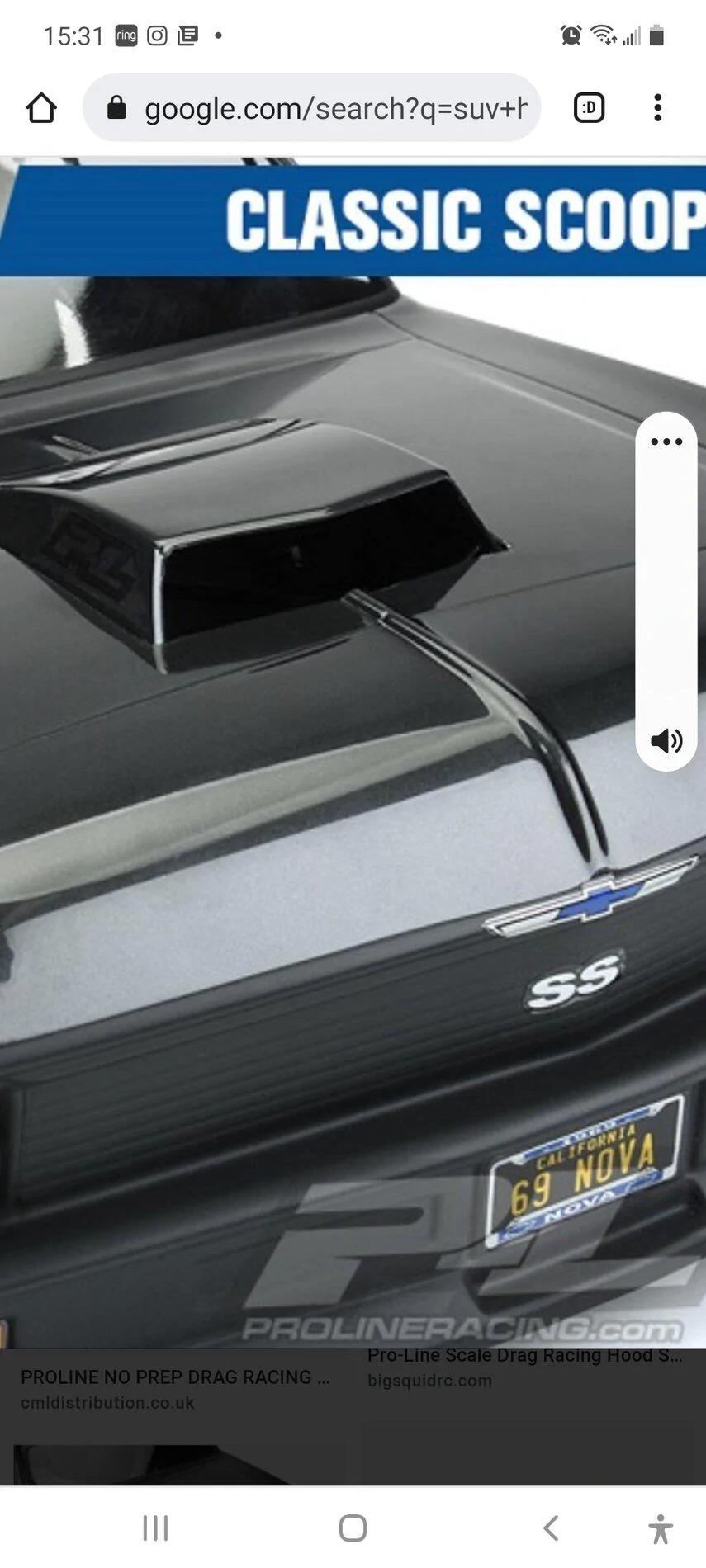

It is something like that under the hood scoop see the pic
It is consider under the hood???
LoL

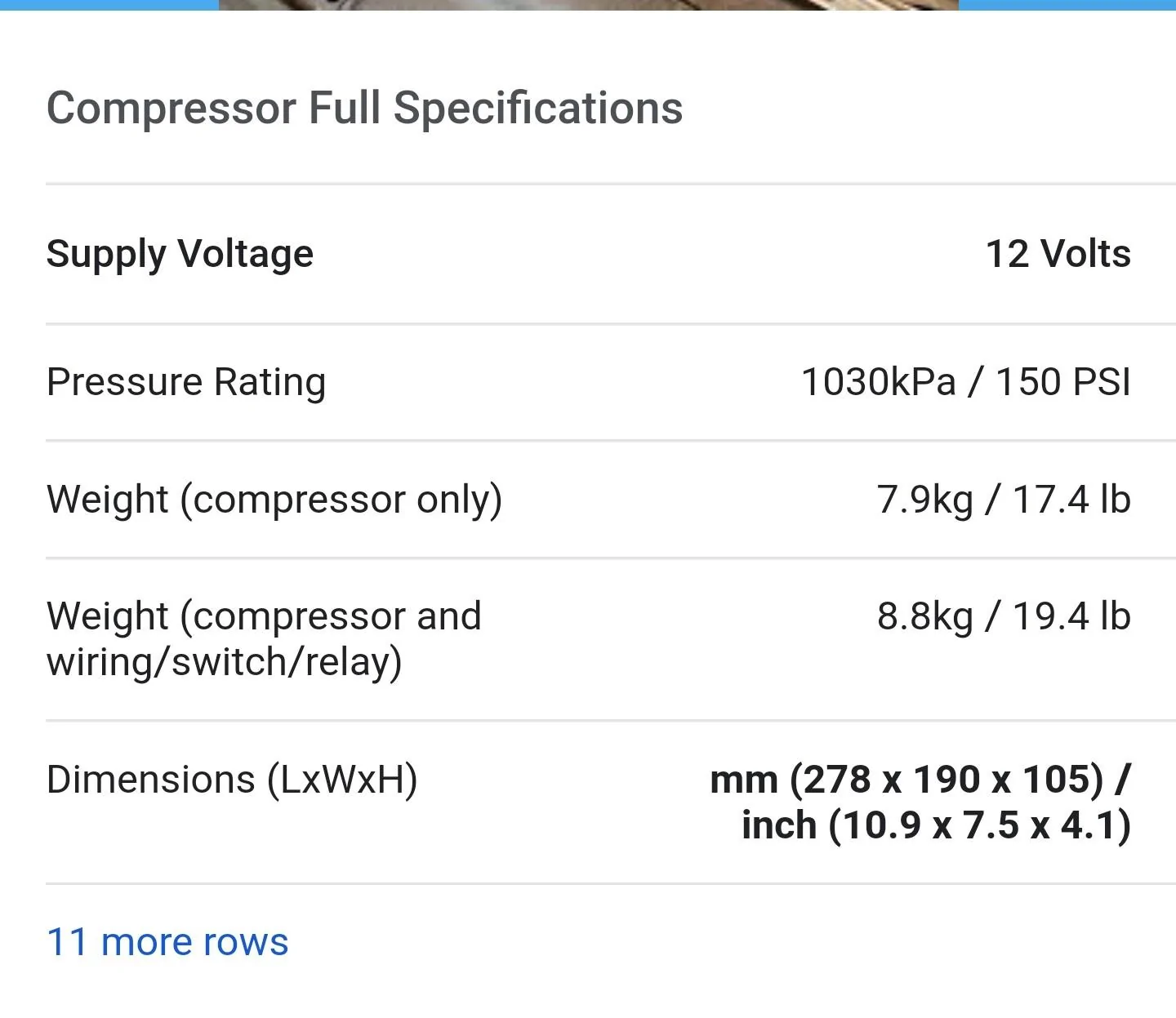

I got he rear area cargo enclosure which has a three sided molle panel. I am hoping that the ARB will fit wall mounted on one of those panels. What are its dimensions?
Ford Bronco ARB Dual Compressor stealth install - UPDATED. Screenshot_20211108-170928_Chrome-1
It 100% weighs more than 20lb. It has to be at least a ton. My arms are killing me after fighting with it for 3 days.
Sorry for the delay. I think it'll mount fine, but you're going to have to use some beefy molle mounts of some type.
