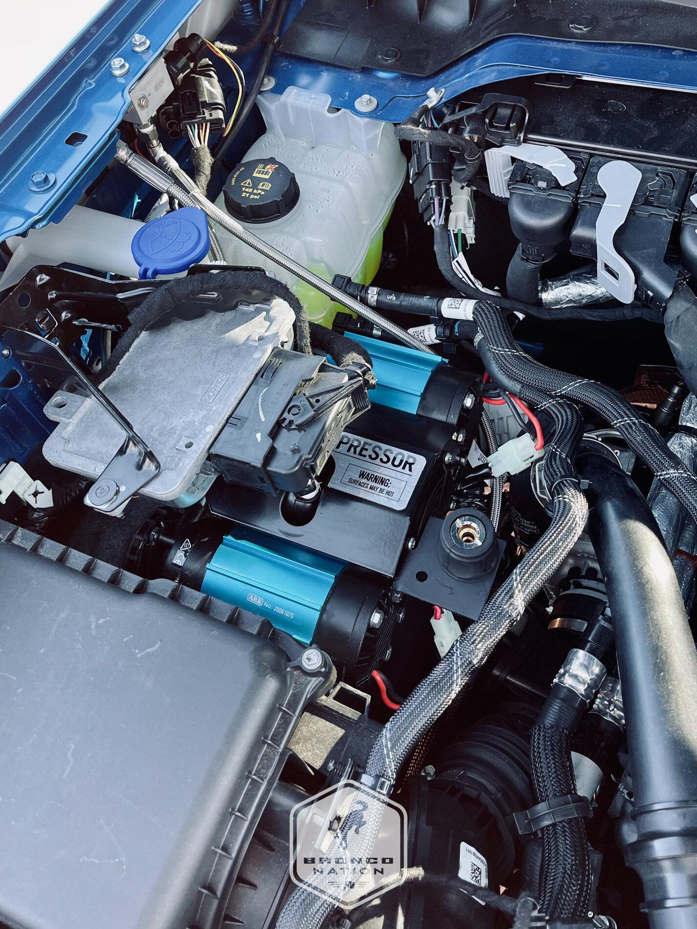

Ford Bronco ARB Dual Compressor stealth install - UPDATED. 1636314474293

So you’re saying this is fake news?
Yeah. Unless they did a lot of relocating stuff. I attempted to get it in that spot and it scratched up my coolant tank and put a lot of pressure on it. One jolt off roading would probably do it.
Also, it's just sitting on the wheel well carpet liner. There's nothing metal down there to attach it in any way, and the ARB mounts from the bottom.
There isn't really an area to even connect a mounting bracket. You really would have to relocate the module on top in some fashion and move either your air box or coolant tank a bit.
@4x4TruckLEDs.com mount is the best solution I've seen for the guys who want it in the engine compartment. I hope it works.
I'm about to finish my install and you'll be able to see why I think this is the best spot overall. It's also a prime spot for a mass produced mounting bracket, because there is plenty of frame to hook it to instead of going through the reinforced floor pan where I did. It's under the rear floor, hard to tell from my photo.
I should also say that my concern with that area is it's only a couple inches from the bigger of the two turbos.. it gets HOT in that area. Lots of heat radiating up. Not sure how good that is long term for the compressor.

Im hoping for an install that works in the 2.7 engine compartment. I'm even fine with the ARB single. And the double isnt much good with air tools unless i also install the 1 gallon air tank . . . Where would that fit!
These bracket makers are good at their jobs. I have no doubt that working solutions will come forward, but I see why they aren't here yet. There just isn't a lot of room under the hood, and the only open areas are near the turbos. Lots of heat.
The area I chose is just a big empty void under the truck above the axle, but it hasn't been the easiest install. I'm finishing it up this morning so a big post with photos and a guide will be coming shortly.
The guys looking for a less custom solution (everything is accessible in the rear cargo area in my install) should just wait a bit longer for @4x4TruckLEDs.com to finish their prototyping. Will cut install time down in half.
I would love to see someone make some custom wiring harnesses as well made for the Bronco. I've had to completely remake the wiring harness that came with it by pulling out tons of wires for things like air lockers etc.
