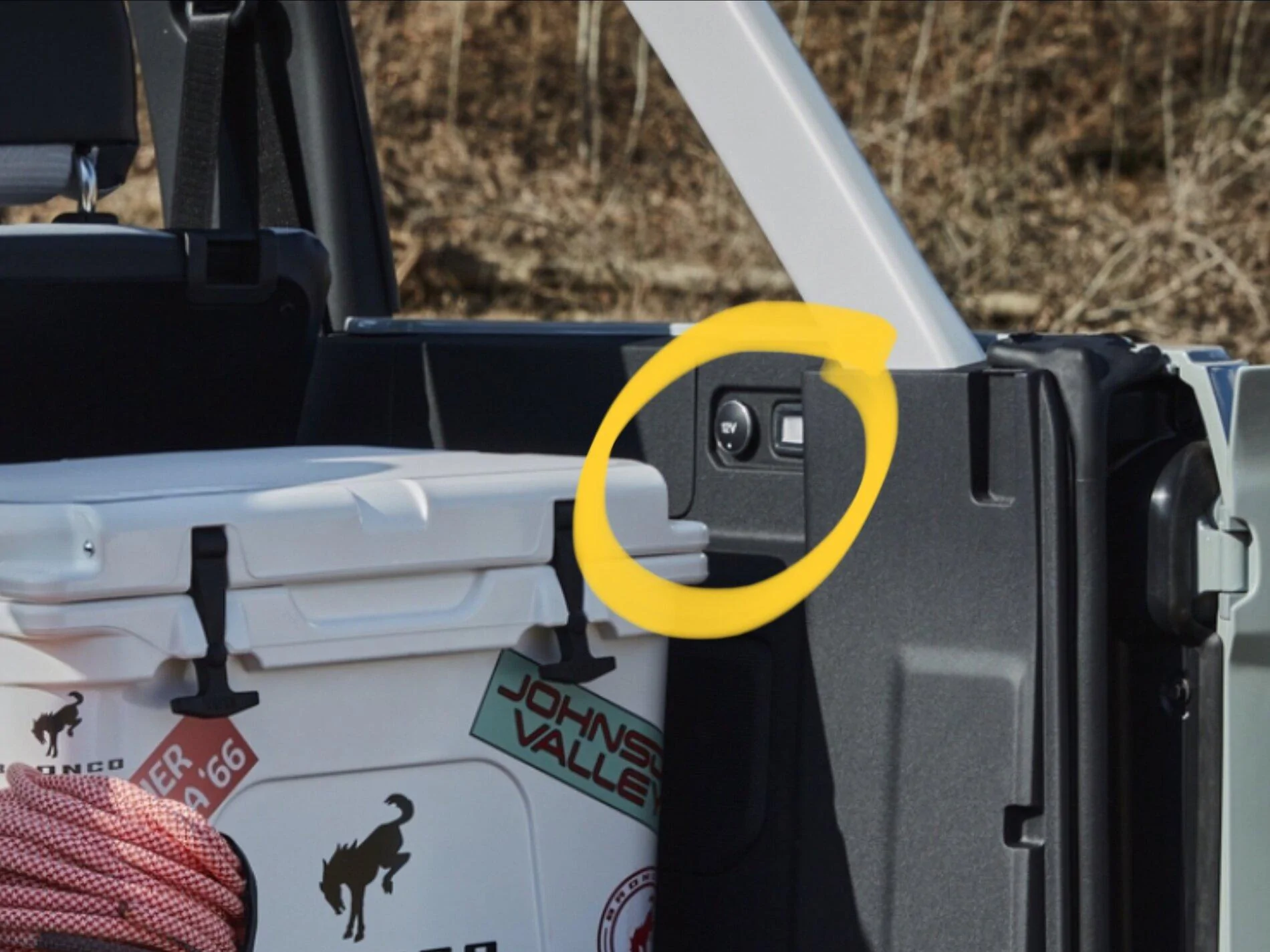

From what I understand - if you plug something into the 110v outlet Like an LED nightlight ..it will keep the on off start from activating. There should be one right behind the center counsel but I can’t find a pic. I can’t tell if this outlet at the rear is 110v.
