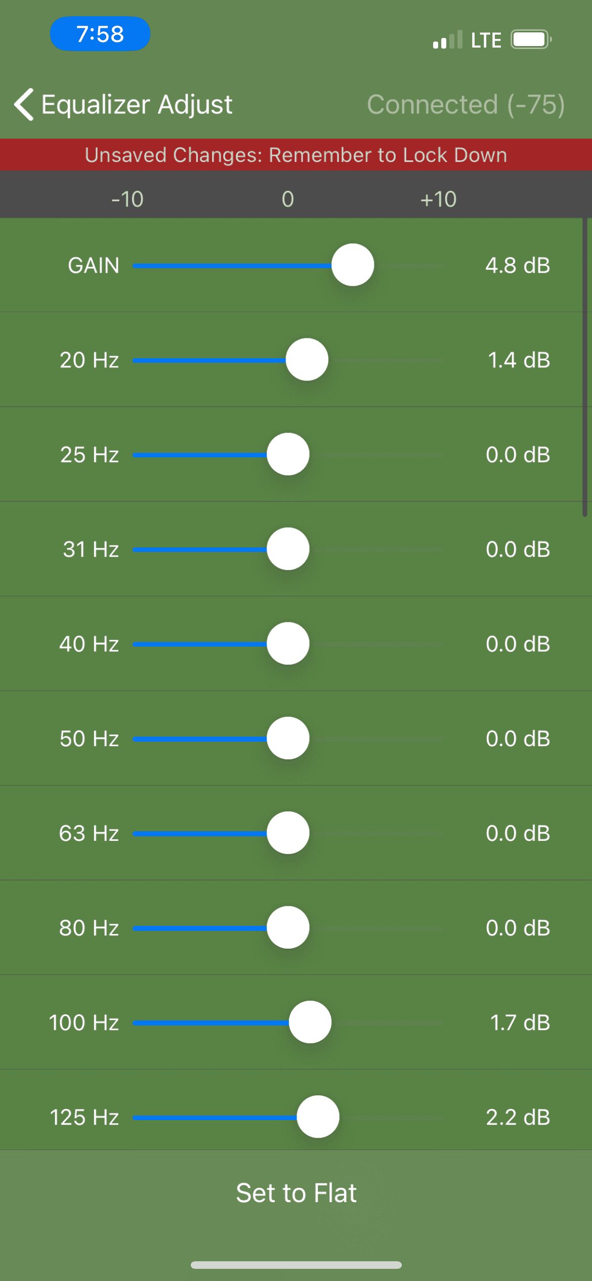

The easiest way to dramatically improve the sound is using a harness, but they are expensive ($600+) then adding and amp and new speakers.
I went the cheaper route and used a Kicker Key 200.4 spliced into the the factory harness before the factory DSP. I also added a Kicker Key 500.1 for a new sub. I'm a semi-audiophile and I am super happy with the results.
How did you splice into the amp/DSP signal for the 200.4? Did you tap each individual speaker wire coming out of the Amp/DSP? Then rely on the Kickerā€˜s DSP to fill in the the rolloffs created by the factory DSP?
Yes, I cut the front dash and kick panel wires and used these as 4 channel in on the 200.4. I left the center and rear speakers alone and let the Kicker DSP all the time and level alignment.
I also cut the sub wires going into the stock sub and used these to feed the 500.1 and the new Kicker 12" sub.
