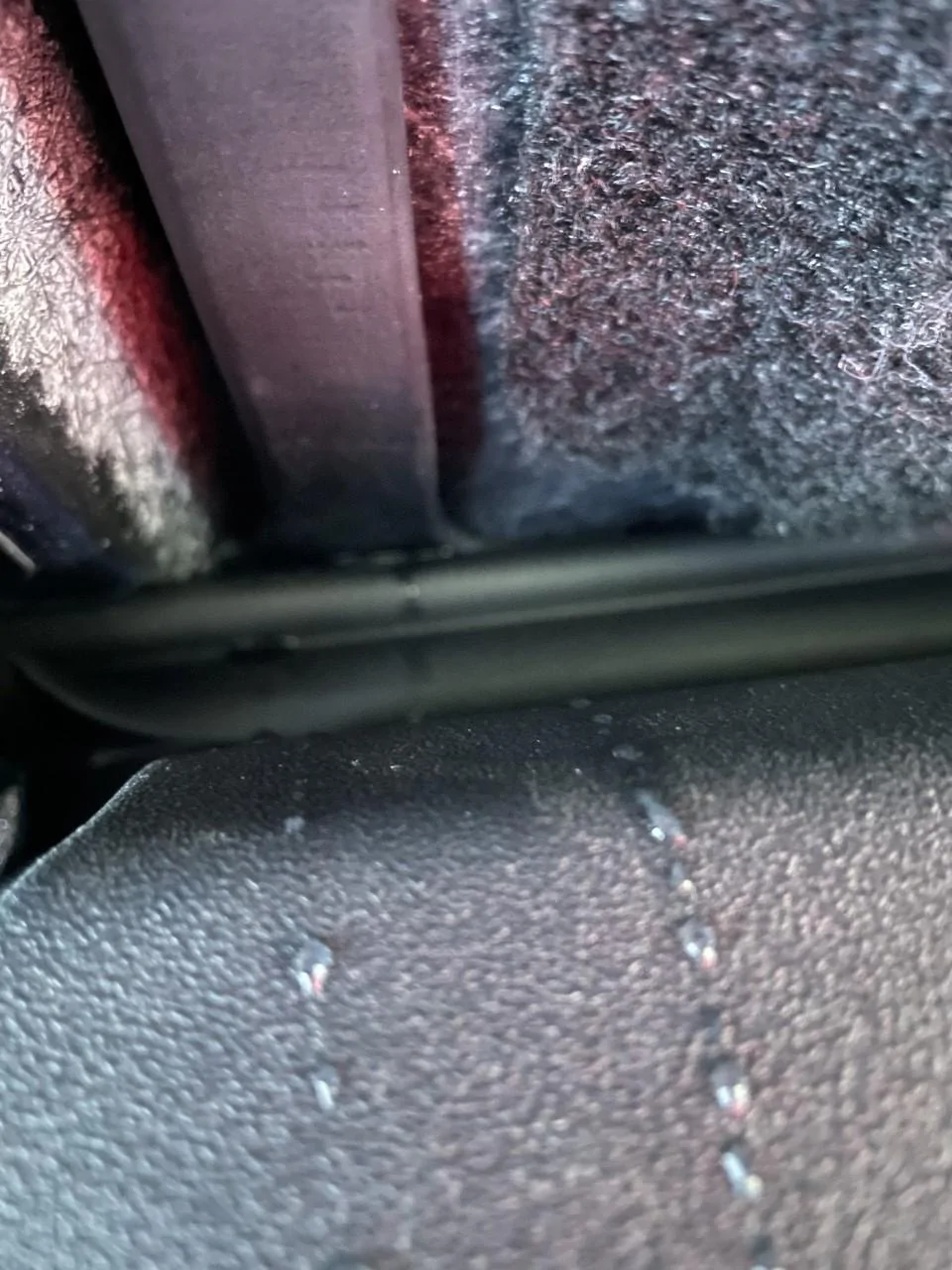

Updated photo from this AM. My hands aren't Samsquatch in real life, that's just the zoom level. You can see the fuzzy look on the edge, and that wasn't there when I picked it up 5 days ago. You REALLY have to be looking for it though.
Bad news, folks. This is a MIC 2.0 top built 10/1, delivered 4 days ago.
Top looked excellent at pickup. Did not notice any issues.. 4 days later, I notice I can see the old issue returning. Have not notified Ford yet.
Check your MIC tops CLOSELY on the rearmost panel by the windows. Appears to be pulling apart a bit.
I'll have a lot more photos and any other misc info coming shortly.
There is also slight honeycombing.
Edited for brevity.
Updated with some photos posted later in thread by @AJ_West_

This MIC debacle seems to be getting worse as time goes on.
Before we completely judge the MIC2.0 a failure, does anybody have a clamshell with a manufactured date in October? What does it look like? Specifically the edges and any snakeskinning?
Has anyone had snakeskin or exposed laminate problems with MIC2.0 panels? What does it look like?
Most of these seem to be dirt mountains with clamshells manufactured before the MIC2.0 cutover and mix and match replacement panels.

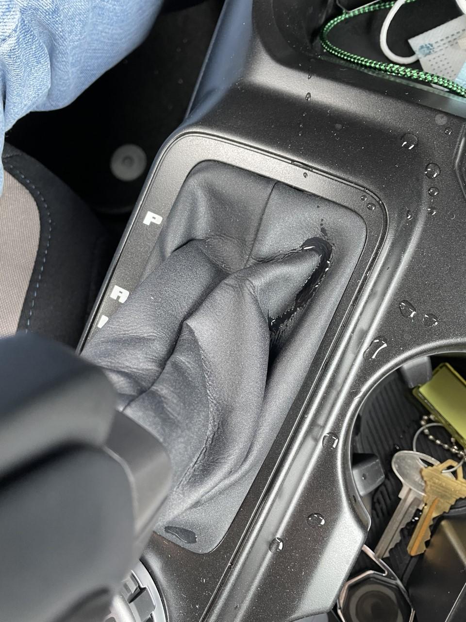

I got my 4-door MIC hardtop Bronco in mid-October. After a rain last night it is leaking at the front center directly over the winshield. FYI - I have taken the front two roof panels off twice. I plan to take it to the dealer and I will follow up once I get this resolved.
(reposted from another thread)
