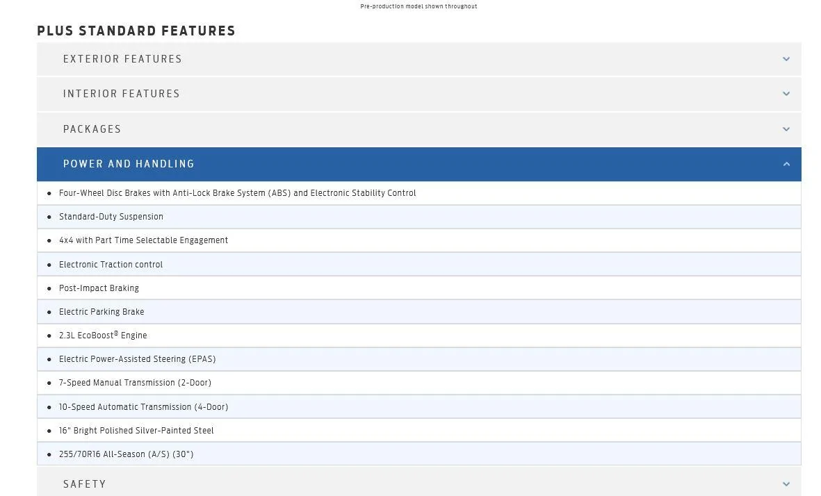

Brake lock distribution is a traction control for off road use that applies brake to spinning wheel (one wheel drive) which allows other wheel that has traction to spin. It actually works quite well in most situations. Not as good as a mechanical locker, but still good. It’s on every bronco (and every wrangler).
Where would I find it stated under the Bronco standard features that Brake Lock Differential is standard for all Broncos - or in my case for the Big Bend? Since I do not plan on off-roading I am not considering the rear locker option - especially if the Big Bend has the Brake Lock Differential standard as the Jeep Wranglers do.

Keep in mind that the term "Brake Lock Differential" is just marketing speak for brake-based traction control. Basically, the PCM notices that one wheel is slipping and applies that individual brake to arrest the slip. That's something that a lot of cars have had standard for years now. On a 4x4, you can call it a fancy name to make it sound like a substitute for a locker (which it isn't). In our case, Ford is at least calling it like it is:
Ford Bronco Base Model Rear Locking Differential FeatureCaptur
This is taken from the list of standard features in the base model Bronco on the B&P page. See the 4th line down - Electronic Traction Control. That's it. It also goes hand-in-hand with the first line item, ABS w/ Electronic Stability Control. These are basically different facets of the same system.
Rocketeer Rick
Thank you for the explanation - I did not realize they were one and the same. Makes sense to me now.
