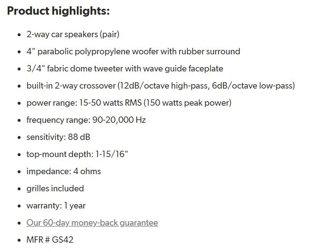

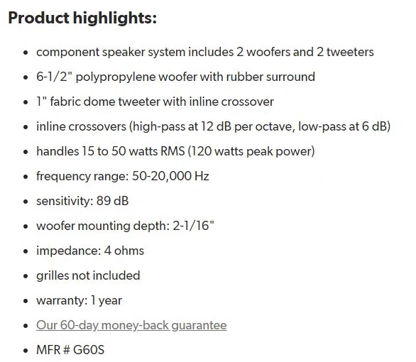

where would you mount the tweeters on the 6.5's? also the description of the speakers are actually more important than the pics ... just saying
Totally forgot about the description. As for the tweeters, I was thinking about this but if it was a good companion to the GS42's, I would consider getting them professionally mounted somewhere in the A-pillar or maybe even in the dash. But I'm also thinking maybe start with the 4" front and rear and just see how that sounds and go from there.
GS42 description:
Ford Bronco Base Sound System Upgrade/Build GS42(2)
GS60S description:
Ford Bronco Base Sound System Upgrade/Build G60S(2)

@Vinny6G those do look pretty good. I like that everything has a crossover with it , or built into it. Just don’t forget to get a small amp to go with them.
That was next up on the list. With 6 speakers total, would I need a 6 channel amp or 4-5 with a bridge?
