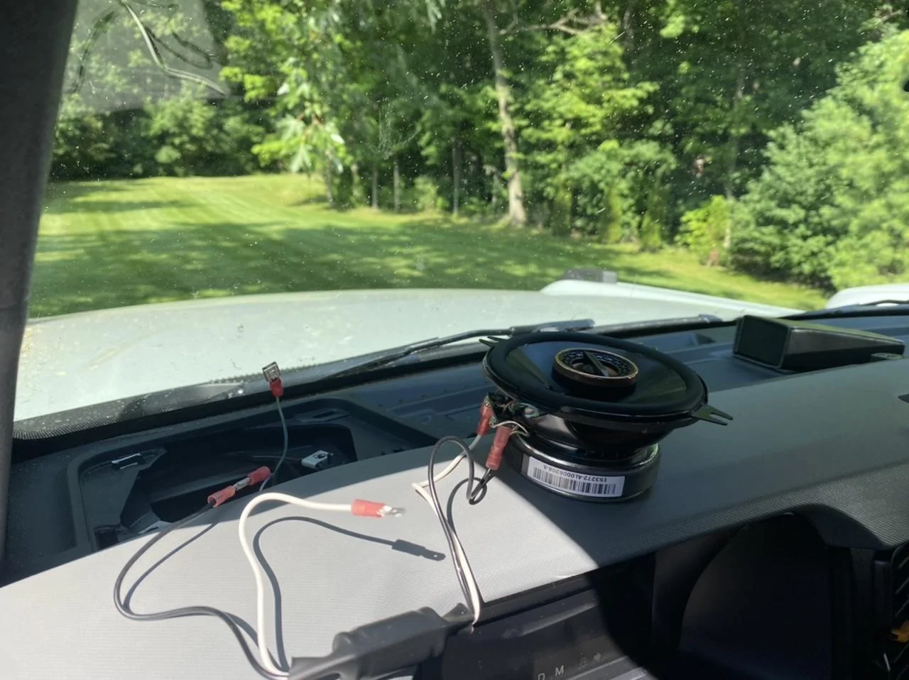

Hi there,
Has someone figured out which one is positive and which is negative? I've got some 4" Polk Audio DB+s but can't seem to figure out which one is the correct polarity.
Thanks

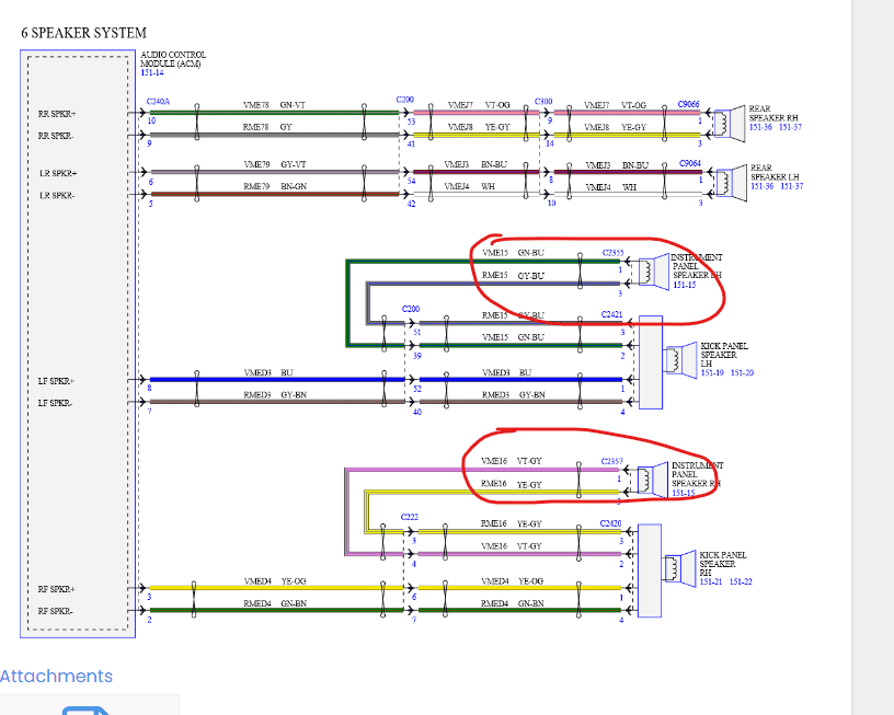

This is kind of too afraid to ask territory, but I really want to upgrade when I get mine next year and am wondering how all these builds people are pulling off aren't going to fry the electrical system/infotainment/thing you need for your truck to work? Especially with the amps and the powered subs? I've never done anything with car audio before so if there's a noob's guide to doing this it'd be amazing 👀 I've been following the thread for weeks and still don't quite get it beyond the speaker swaps being safe long as you match/don't exceed the ohm ratings of the stock ones
