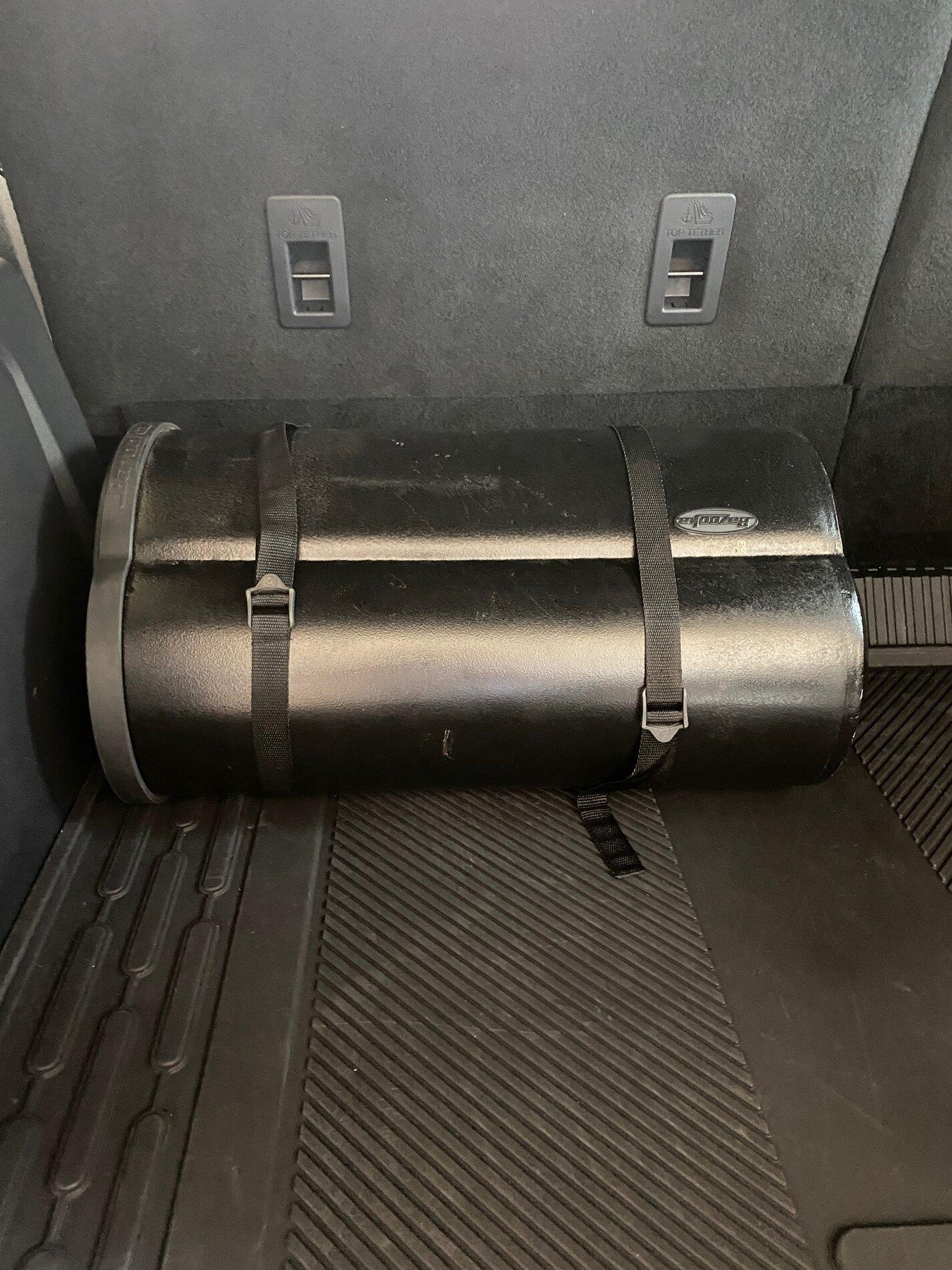

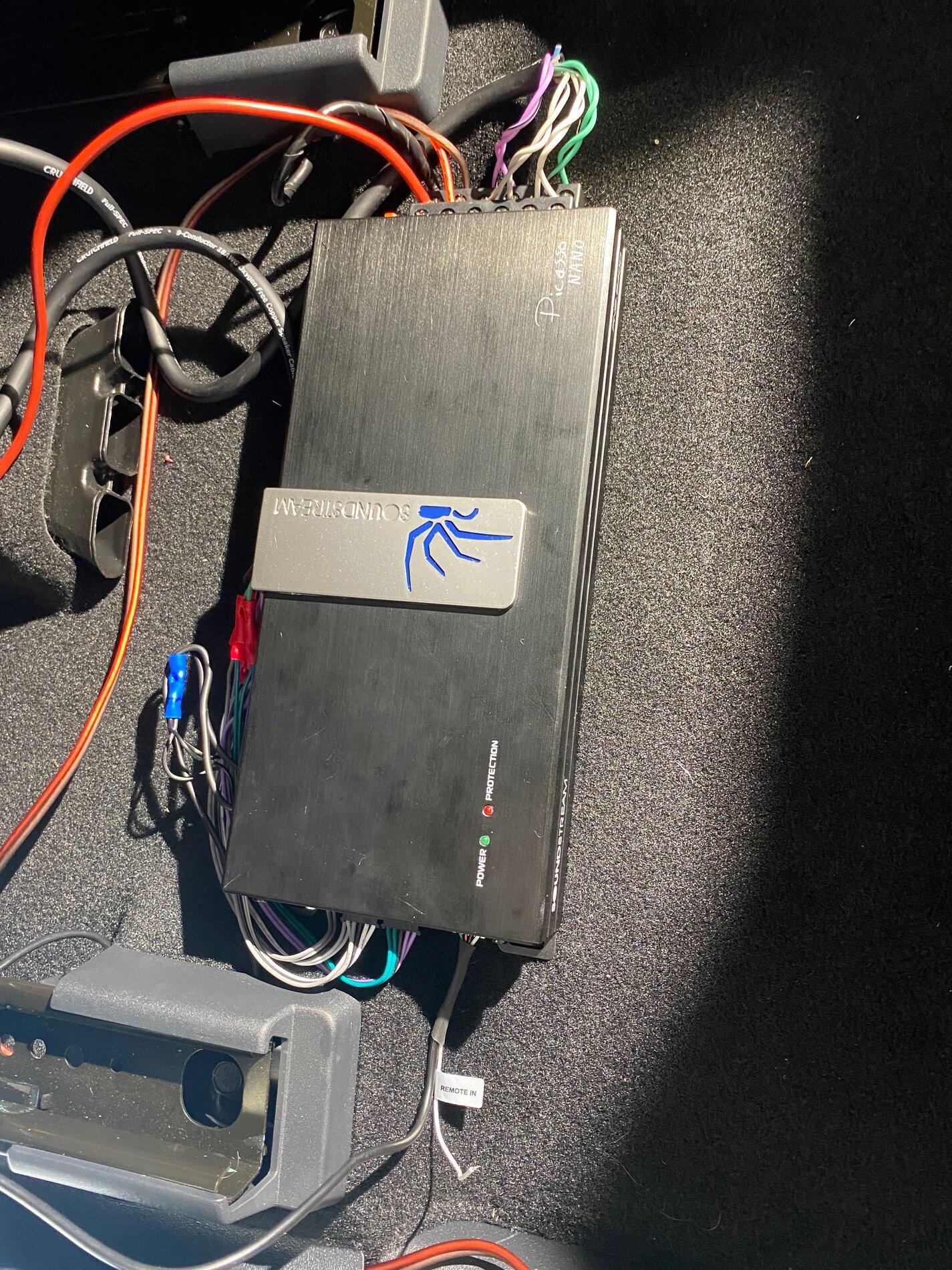

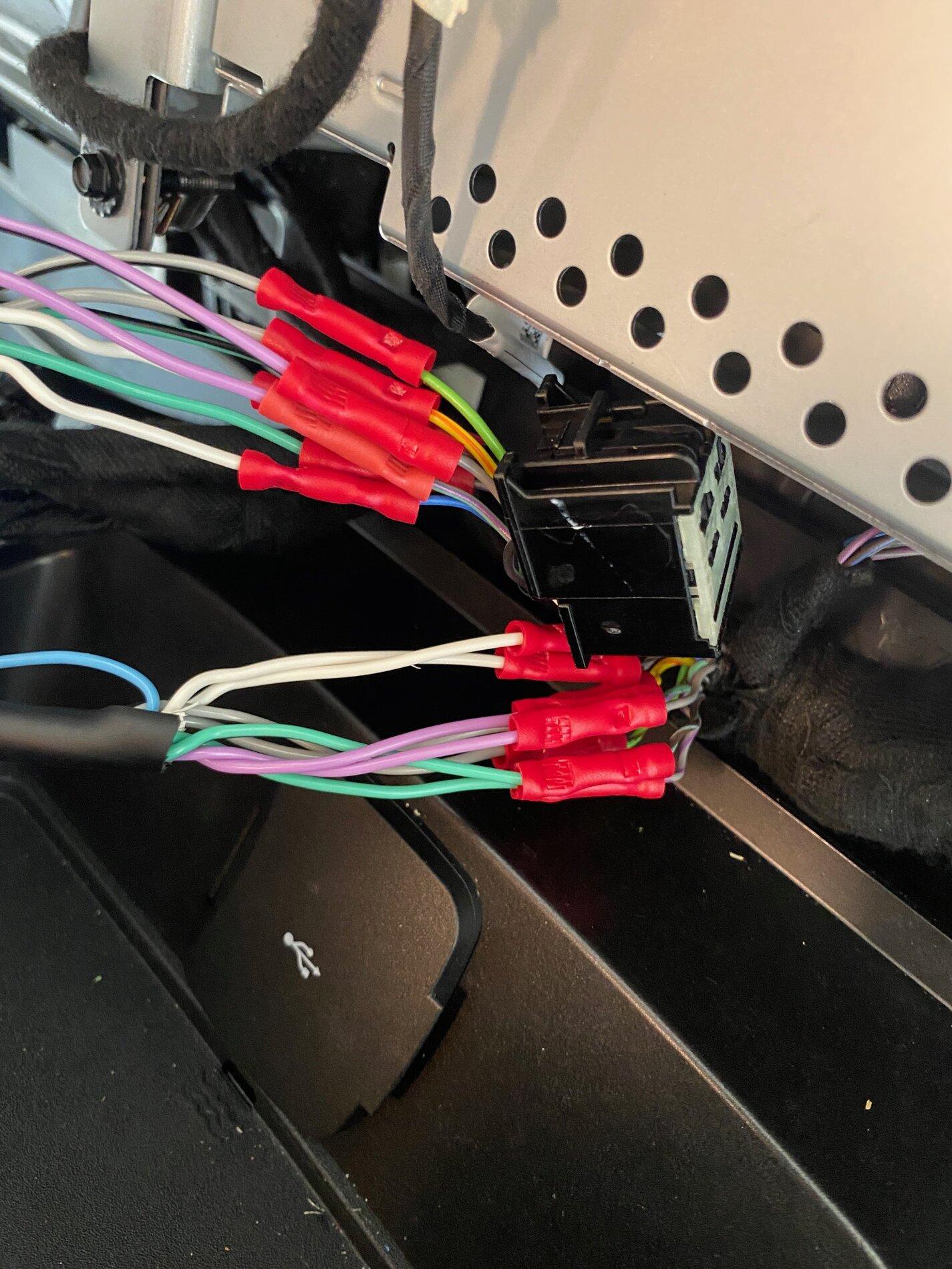

So after many countless hours I was able to complete the install on my son's Big Bend. I'm using a 5 channel Soundstream amp that fits perfectly under the driver's seat. It's still loose since we are fine tuning some of the gains and x-over freqs. I'm blocking the under seat vents and will mount it directly behind the vent. I replaced the fronts with Polks and am using JBL Soundbar for the rears. The 10" Bazooka is a carry over until the aftermarket comes up with a built in enclosure. It was tough trying to splice in all the wires under the ACM. There isn't much room and only a few inches of wire to work with. Gotta have some patience with that part of the install. Thanks to all the good people who have posted on this thread and made everything easier.

Looks like the remote in wire is not connected does the amp have power on with low level line input,? Trying to find a good 12v power on ignition to tap into but have not come across one yet.
I'm using the high level outputs from the ACM. The amp detects the high level signal and turns on.
I was prepared to tap into the fuse panel but fortunate that I was able to avoid that.

All the stock wires are 18 Ga. ..... did you change the Ga. on any wires? what did you use for power and ground wires to the Amp?
I used this from Crutchfield: https://www.crutchfield.com/p_007CSW9W20/Crutchfield-CSW9W-20.html
It was a lifesaver. I cut the 20' cable in half. Was able to run a single flexible cable from the ACM to the amp under the seat for the high level inputs. Then I used the other 10' to run from the amp's speaker terminals back to the same spot under the ACM and spliced back into the OEM speaker wires. Just becareful and take your time. Not much room and very little of the OEM wire to work with.
I used some exisitng 8 ga. wire that I had to run from the battery thru the firewall. The ground was easy. Since the amp was under the seat I used the seat mounting bolt for the ground. It needed less that a foot of cable and the bolt went all the way to through the body of the vehicle.
