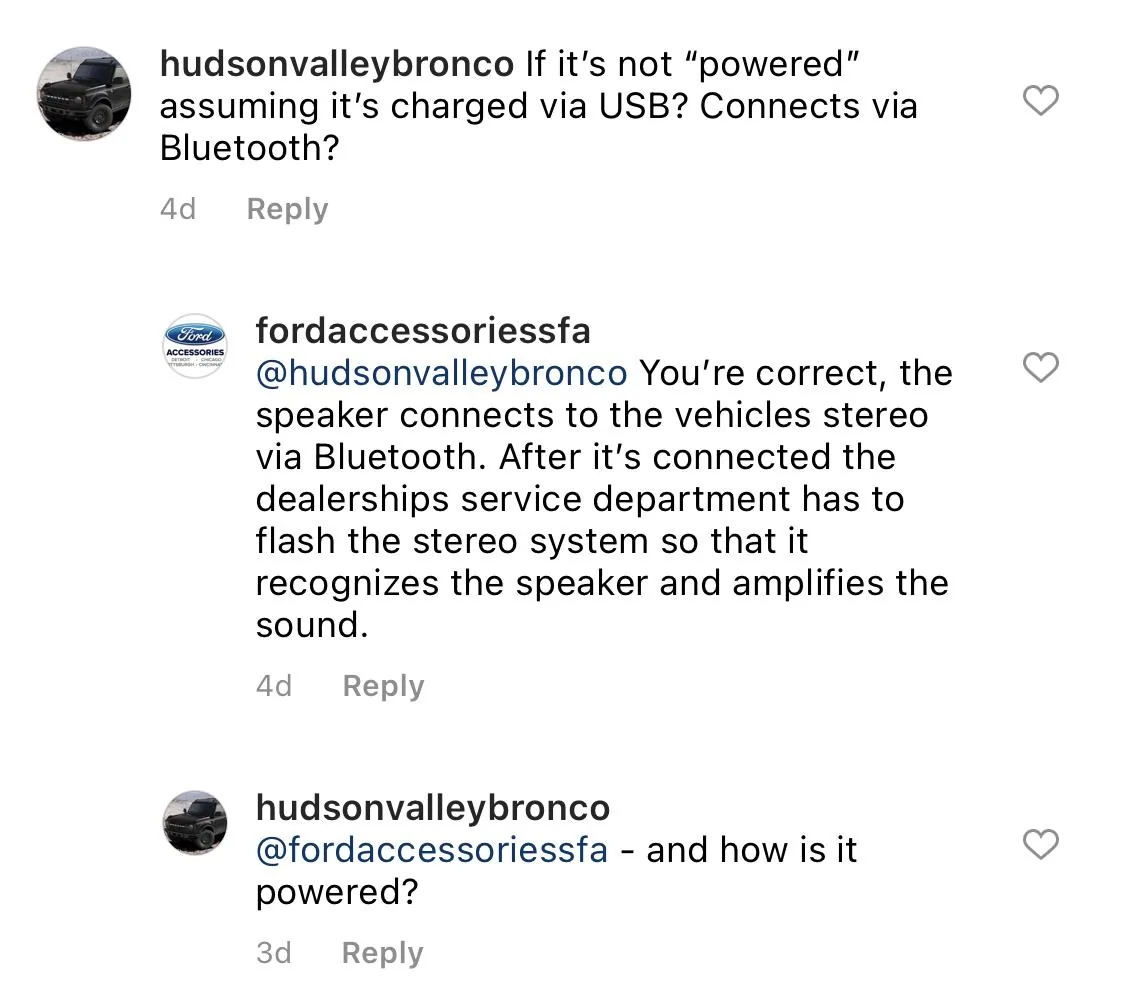

I picture it as a large JBL Charge that isn’t portable. It’s already been stated that it connects via Bluetooth, correct?
I believe this is the same soundbar as on JBL site and Crutchfield's, but waiting confirmation from my dealer. See my posts on page 2 and 3 of this same thread. I believe it has three connections, RCA, bluetooth and a 3.5 jack...the RCA jack hooks to head unit, the bluetooth overrides the RCA when connected, and the 3.5 jack overrides both if connected.

@Tricky Nick
I’m not too sure about that…but, then again these guys don’t seem to know what they’re talking about either.

Thanks for the links @Tricky Nick. Looking forward to the first person to report back on install. It's certainly a cumbersome piece of equipment - but, if the wiring/connections work the way you describe - that opens a world of options.
It also hasn't been disclosed why it DOES NOT work with the upgraded B&O system....

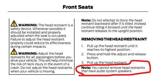

Really dumb question(?): I am interested in adding Bluetooth headrest speakers; like BOSE has built for the OEMs….. But I am wondering if this is something that CAN be added as a DIY or at a Car Audio shop, and IF it can be added, is it worth it? Anyone have any experience with the Mazdas or Nissan’s that come factory equipped with this?
This made me take a look, and I saw this in the Owner's Manual:
Ford Bronco Base Sound System Upgrade/Build 1626478652628
Someone thought about it at least. But also, since the headrests are otherwise removable, it wouldn't be unrealistic to expect someone to come up with a replacement headrest with speakers and a wiring kit of some sort. Worst case, get some used headrests, rip them apart, make them the way you want, then work with an upholstery shop to recover them in the right shade and type of material so they look OE.
I had a Miata that had them. Upgraded the paper OE speakers to a good set of Blaupunkt polycarbonate ones I got from Crutchfield way back in the day. In my Wrangler, I added them, but they were more small speakers in tiny boxes angled inward a bit in a 'saddlebag' cover that went over the headrests and the wiring got tucked under the seat covers I used. It made for a wide headrest, but was great on topless days on the highway at the same time.
Yeah, cannot confirm it yet, but believe mine was built today, so should be able to confirm either way in about a week a few weeks, maybe.
