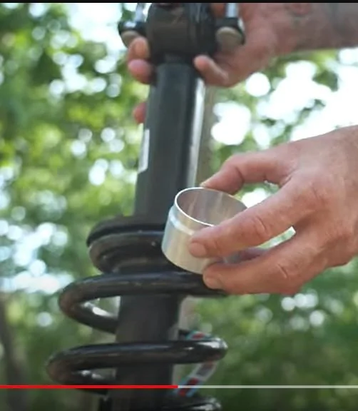

Please post / let me know if you do the Belltech lift struts - I am also thinking of doing that.
I thought height increase would be from the springs - not the struts.
But these include spring perches for stock springs.
I am guessing if you use stock springs, spring perches and stock struts - the stock struts may not be up for the job?
This video shows the ability to use just the : "Lower Perch Lift Collars, pre load collars, spring pre load spacers.
Q: Does the new strut, mitigate some of the issues associated with this sort of lift - as described in the video?
* Likelyhood of coil bind, bump steer, harsher ride

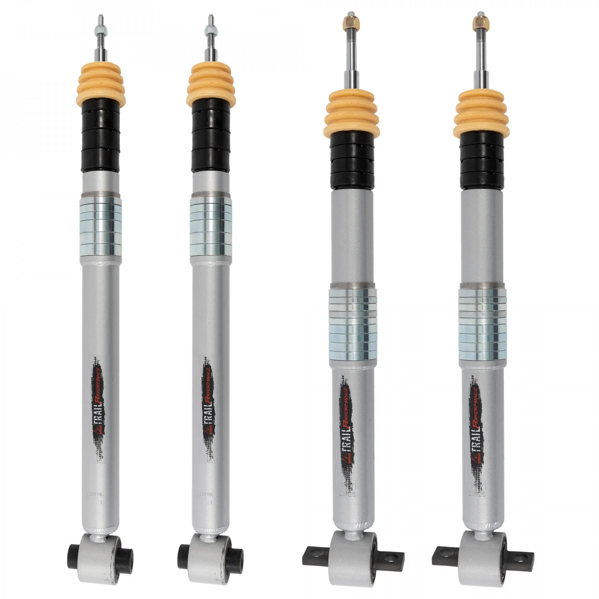

Ford Bronco BELLTECH 0-4" Adjustable Lift Kit -  2 Options bt_152601_tp_001_2000_1
I can for sure recommend these. Belltech is great quality, some of the best struts on the market. We've ran these on our Bronco and love them.
Over the last 6 months of driving our Bronco with this lift on it, we have not had any coil bind or bump steer issues. As for the ride, it is just a tad harsher than the stock non SAS suspension which we actually prefer. We believe the ride was improved when going to these shocks and handles daily driving better being this way. To compare the ride harshness it is in-between SAS & Non SAS
Feel free to message me with any questions, Id be happy to help.
